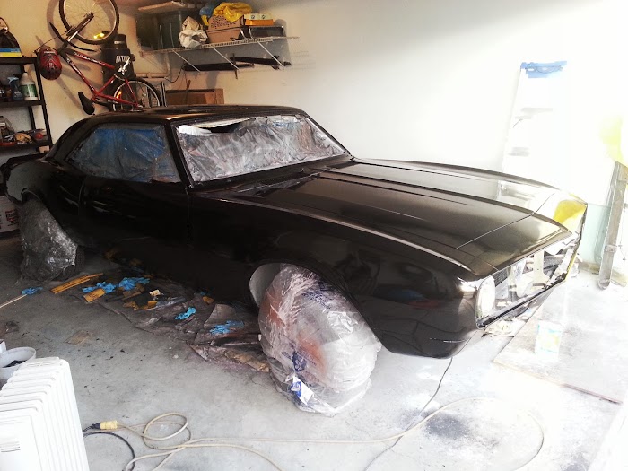

UPDATE: I rolled from midnight till 320am and might be just half way done wet sanding with 400g. I knew it was going to be slow, but it may end up taking 6 hours to get this thing smooth. I suppose the first one, if done to perfection will be the most time consuming as the rest will have a smooth base to go on. I probably won't do pics until it's all wet sanded and ready for paint again.
Re: 67 Camaro - Black on Black
Post by Ian67 on June 11th 2013, 7:41 pm

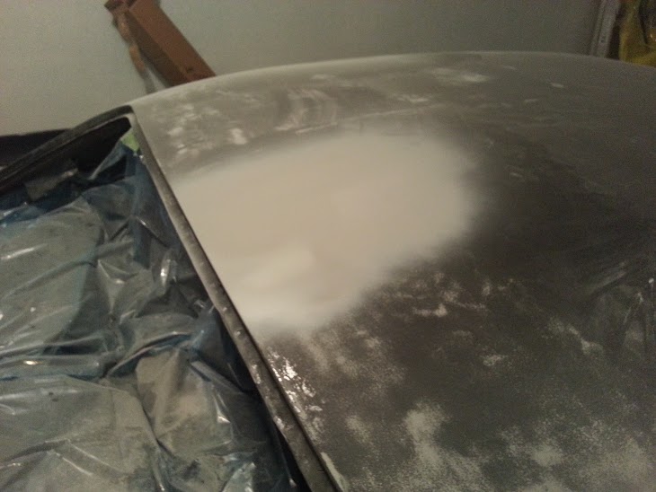

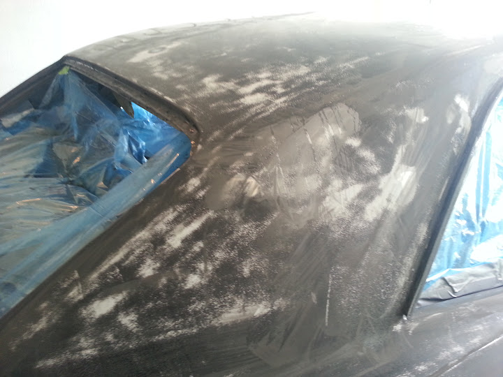

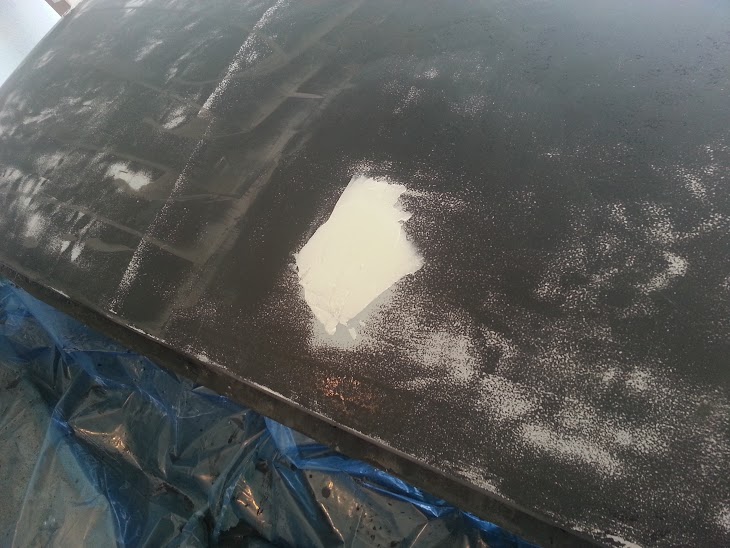

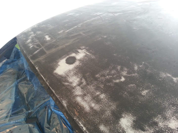

Here is the progress so far.. She's fighting me the whole way but she will be smooth..
I haven't cleaned it off but u can see what's been done.

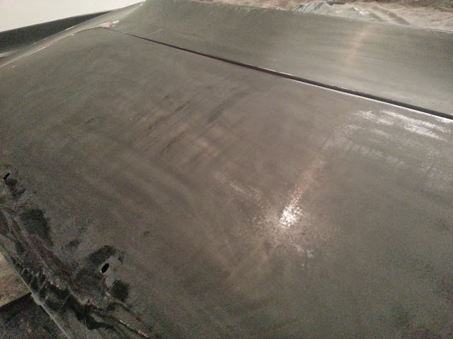

Lots of white showing through bit what you see is smooth... Except...
This spot on the roof that I could see once the black paint was on.
Hopefully I can get the rest done over the weekend.

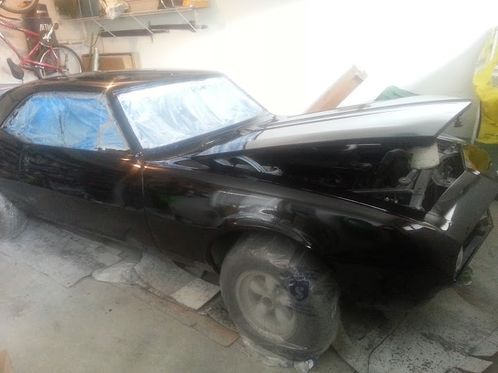

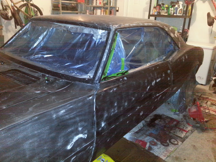

Took what seemed like forever to get the car through the initial wet sand. That being said, she wasn't t nearly smooth enough for paint. However, she is 400g smooth now with the exception of 4-5 smallish spots. The most obvious spot is still the roof dent, but I've got a wavy front driver side header and a few little dings here and there that I don't like. Other than that I'm pretty happy with it. I just finished the wet sanding around 0030 hours, so the pictures are dark, but you can see how much I sanded down to make it smooth. The car has not been cleaned yet either. At least the sanding from now on won't be as tedious. hope
Some spots to fill but well on the way to paint again.

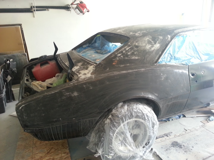

Post by Ian67 on July 4th 2013, 4:25 pm

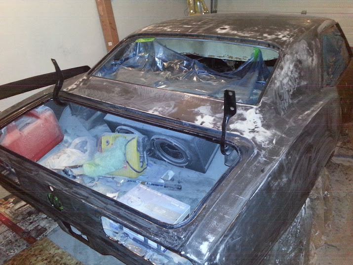

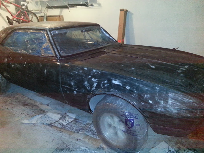

Took a little while but I managed to clean, apply filler to the bad spots, sand with 150g, sand with 400g wet, clean and spray Tremclad oil-based primer (spray version of the primer I rolled). Pics below:
Applied filler to the low spot on the roof.
Applied filler around the antenna hole. The metal was dimpled around the hole. The antenna base might have covered it but I didn't want to know it was there.
Applied filler to the header panel as it was all kinds of warped.
Applied filler to the driver side sail panel area. Actually had to do this twice as after I sanded it, it needed a little more.
Sanded the roof smooth and sprayed the primer.
The header panel after sanding and priming.
The passenger door and antenna hole. The door had a couple minor dings that I didn't enjoy.
Another shot of the header panel.
The driver side sail panel after sanding and primer. This was the most time consuming part, but the final product is excellent.
Even though my camera was freaking out, you can see that I did some more work on the back window quarter seams and the upper trunk panel.
It was amazing how much better I could see the faults after the gloss black went on. I expected it as I remembered how it happened when I did the trunk lid. I'm glad that I used the guide coat earlier on as I'm sure it helped eliminate a lot of the issues I would have ran into at this point. The spots in primer now look fantastic, but the real test will be after I went sand them and give them a coat of black.
Next update will have pics of the primer sanded, pre-paint cleaning and black coats 3-4 rolled on.

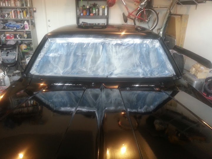

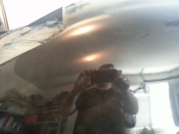

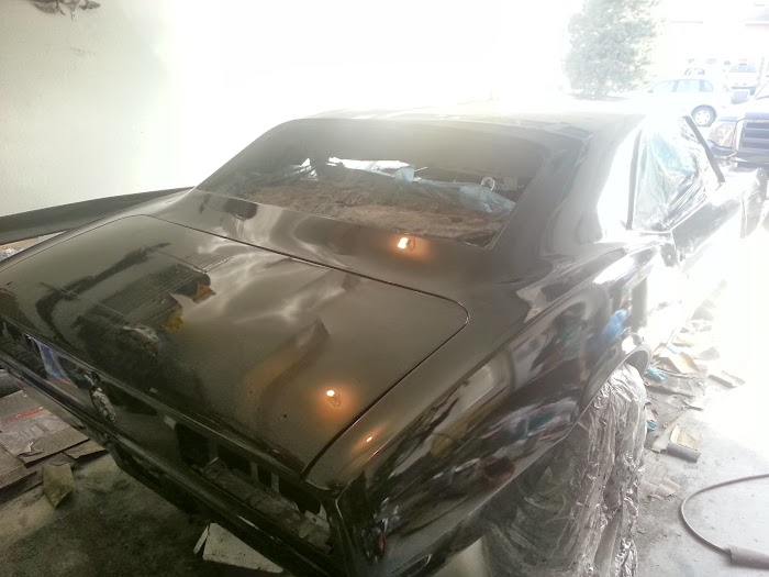

Just finished rolling coat #4. With all the sanding I did after coat #2, it doesn't seem like I've made a lot of progress. That being said, I've managed to fix most of the bigger issues and learned to live with some of the smaller ones. Here are some pics of coats 3-4.
Coat #3 - Passenger sail panel area. Obviously not full coverage as you can see the primer and previous coat underneath.
Coat #3 - Coverage looks good from here but the orange peel is also evident.
Coat #3 - A nasty dent on this front quarter and the sail/roof were fixed and are very smooth now.

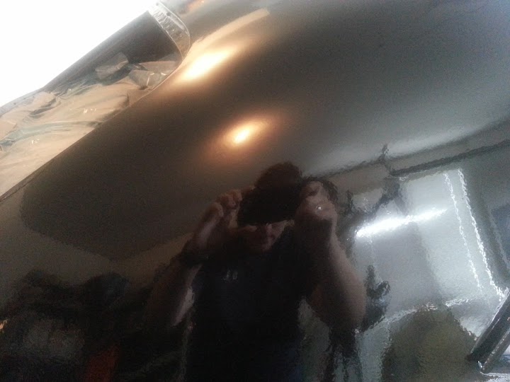

Coat #4 - Too bad I had to use my phones camera for this as it added distortion, making it look a lot worse than it is. The peel is worse than on Coat #3 but the reflection is much improved. I don't think you can see the primer anymore.
Coat #4 - Camera added a haze, but the paint looks darker and better overall.
Coat #4 - The images were just too poor to post. However, I liked this one so I put it up. This Tremclad black is blacker than my worst enemies soul. If black is what you want, this Tremclad Gloss black will get the job done.
In two days or so I'll whip out the 600g and start sanding. I was going to do 400g again but it looks pretty good now, and if I delay the progression any longer, I'll end up doing 20 coats of paint or something ridiculous. I'll probably do coats 5-6 then 800g, 1000g, 1500g and then a final sand with 2000g before I cut/polish.
I think I'm going to go on a posting hiatus and do another 4 coats or so. I'll update once I get to the 1000g stage. I'll be taking dozens of pictures along the way, I just don't have the time to update this as often as I'd like.

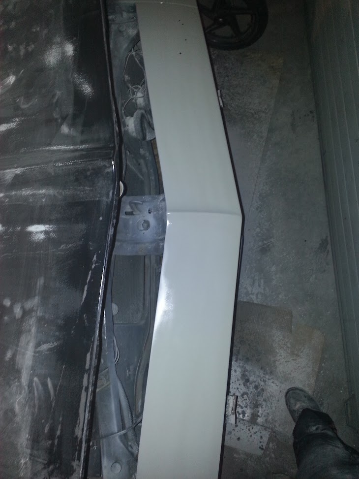

The hood is laser straight now at 220g. Will be guide coating it again and hitting it with 400g. Will paint and do 800g after, then 1000g a couple times, then I'll stop and see where it's at. Picture taken January 19 2014.
The door is the same as the hood. Actually, the door was a lot worse than the hood, but it's super straight now. It'll get the same treatment as the hood from here on out. Picture taken January 19 2014.
The trunk lid, after a little 1000g. Ignore the lower left edge as it was never smoothed and is quite bumpy. Doesn't really matter as the spoiler goes there and the spoiler looks good. Even after two worn out 1000g papers, you can see how much more work is needed. It will end up looking as good as the rest of the car, but it suprises me how poor of a job I did versus how good it looked polished... apparently you can polish a turd. Picture taken January 19 2014.

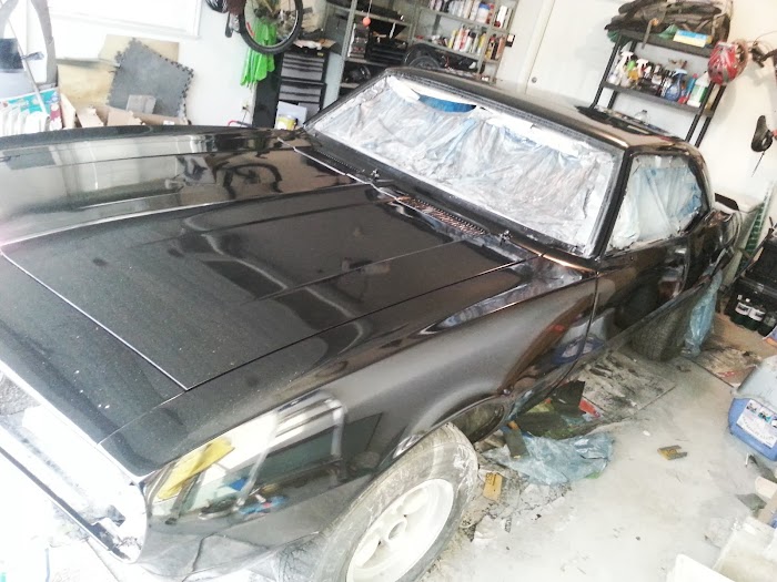

It's coming along. Sanded the whole thing (spoiler mounted and now included in all steps) with 1000g. Had to correct a warped body line on the passenger side door, but other than that it looks pretty good.
Painted 2 more coats of paint with the Penetrol/MS combo. The second coat dried with a few roller lines and some orange peel, but still looks good IMO. My phone takes crappy pictures as it seems to add a grey grain to it, taking away from the dark black you see in person. The wife is going to bring the expensive DSLR out when it's all done.
All sanded... again.. you can see where the body line warped as it's white there now.
Nice and black with about 97% coverage. Just a couple faint white spots showing through on the hood. Other than that, it's pitch black.
The spoiler is mounted and really gives the car the sporty look it deserves. It will probably get 1000g instead of 2000g for the next sand as it's still a bit rough and I don't feel like muscling it smooth.
Some dust on the hood, but overall it looks good. I can't wait to take those bags out of the windows.
