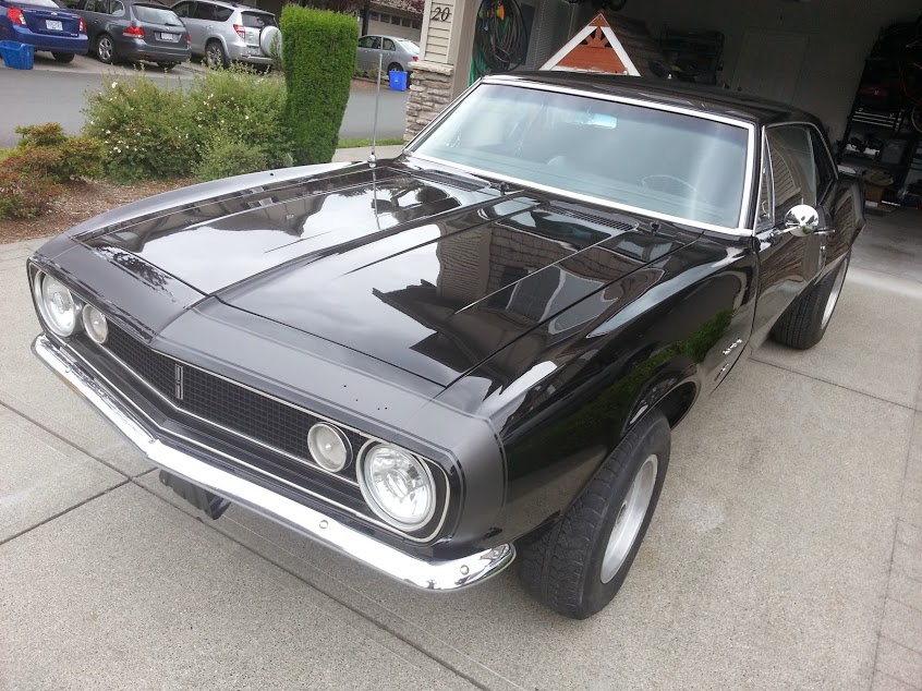

The car is sitting pretty with dirty tires and windows. Even though it looks good from here, I'm still not happy with some very, very transparent primer showing through the paint. So...
I sanded the car to a perfectly dull/flat black and laid 3 more coats of paint/MS/Penetrol. The consistency of these coats was about 60% paint, 30% penetrol and 10% MS. This allowed for blacker, darker, shinier final coats. However, orange peel was a bit worse, but I've since sanded it all AGAIN and have begun the compounding process... but that's not all...

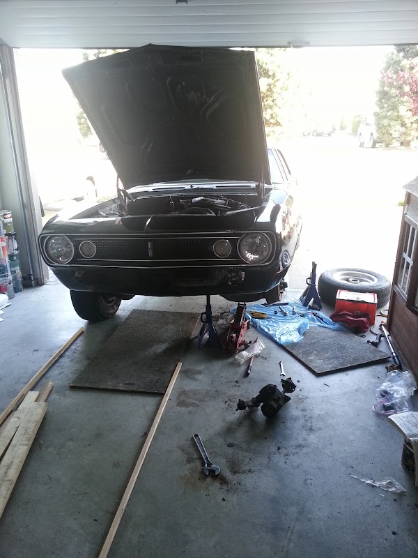

Stopped to allow the paint to cure for a few weeks. In the mean time I lifted the car to upgrade the manual steering system to a restored stock power steering system. 3 turns lock to lock... nothing too fancy but it will be easier on the arms after all this sanding.

So the paint had almost a month to cure and it was time to start the final sand/polish. As of today, I have sanded/compounded the doors, rear quarters, roof and trunk. They all look just like this. Mind the grain from the camera, but you get a rough idea. My next update will show the finished car, waxed with all exterior emblems and bumpers attached. The wheels will be the same, as they will be for a rainy day, probably after summer.
