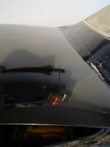

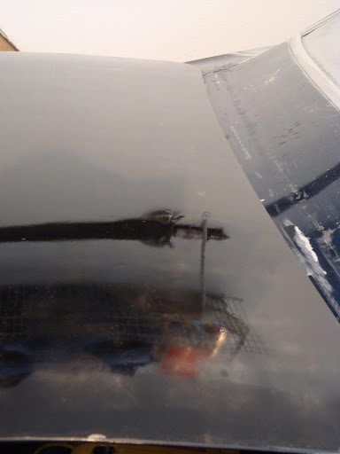

Here is the 3rd coat... seems like the lid darkened quite a bit and coverage is improving. I do however notice a few dips and scratches that I didn't notice before. I have a feeling that my initial thoughts were correct that I didn't block sand good enough after the primer. It still looks good but I'm not sure I'll be happy with it when I'm done. You think I'd be better off to wet sand it till it's smooth and maybe go through a few layers now? Or build up my base coat a bit more and then sand it down? I've got some orange peel on this coat where I didn't have any on the first two. These pics don't show the dips but give you an idea of my 3rd coat progress.

If there are imperfections in the finish, sand them out now, even if it means going all the way back to the primer, with black its all about the prep before the paint, and I really recommend getting some penetrol you can mix the paint a little thicker and have no orange peel.

What T said. If you arn't really happy with it now, you for sure won't like the finished job, especially with black.

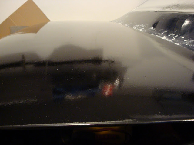

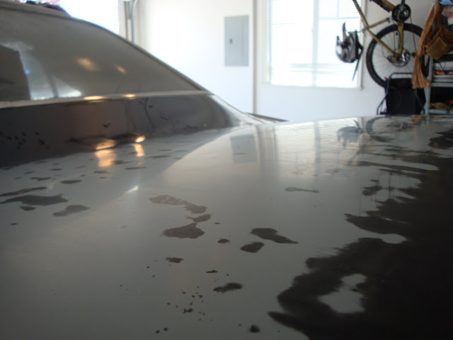

I went to work on it today for about 3 hours... Wet sanded it with 400 grit using the flexible sanding block and she looks and feels as smooth as glass. Finally re-ready for a first coat of paint. I'm waiting until tomorrow to clean it and put the first coat back on.
(You can really see the high and low spots now. It didn't look as bad as it shows here but I bet it would have gotten worse and worse as I put the paint on. I didn't put a lot of effort into the bottom (left side) of the lid as the spoiler covers that part anyway)
(Good anlge here as you can see that it really is nice and smooth. It's 10x better than it was before as even my primer has a reflection now)

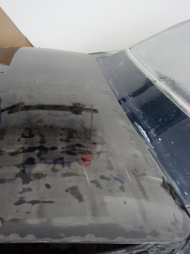

Finally got out there to wet sand and roll the 3rd coat. I'm not sure if I went too deep or not but the coverage looks a lot like the 2nd coat. I found that's what was required to get the whole thing to a dull finish. I'm hoping that as it gets smoother and smoother it won't remove as much paint.
(3rd coat.. good clarity but I think I might have shaved a bit too much off)

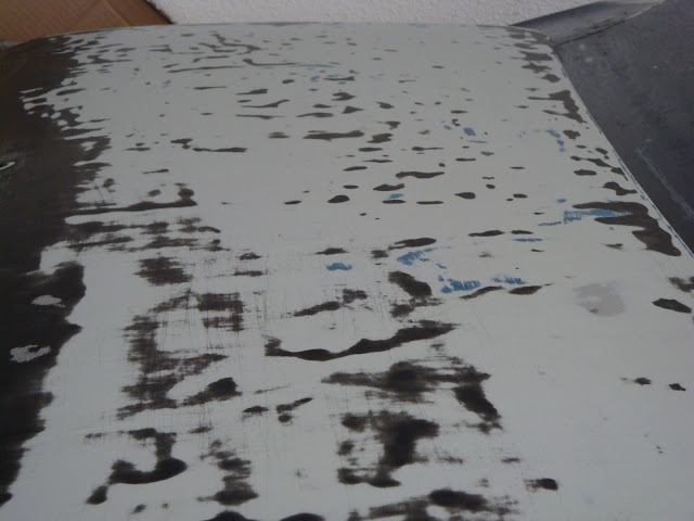

4th coat rolled on today. It's a good thing I'm not in a hurry because I'm a slow worker. I'm very very happy with the results so far. I've got a plan in my mind to complete the lid with the following steps:
Prime, Sand wet 400, Coat 1&2, Sand wet 400, Coat 3&4, Sand wet 400, Coat 5&6, Sand wet 800, Coat 7&8, Sand wet 1000, Coat 9&10, Sand wet 1500/2000 Buff/polish/wax
Seems like a lot of people go to around 8 coats but I think because I'm at bare metal in some spots and because I'm using black I would like it to be a little thicker. Does the above plan look sane? Is jumping from 400 grit to 800 going to be ok? Or would I be best to get some 600? Just trying to save money on paper as I have a ton of 400 and 800. Perhaps I would be better to do 800 grit next instead of 400? Lol I think I've got myself confused now.
(Coat 4 - About 80% coverage and it seems to be really drying smooth)

What ever it takes to make the rough stuff go away.LOL The smother the grit, the more work needed but that has to be balanced against the rougher grits leaving scratches in the paint but leveling faster. I would try the 800 if that is what you have. Keep it clean with water so it cuts good. Change paper often because it does get dull, it may still feel good but compare it to fresh after you do about half a door and you will feel a difference. If you can feel the difference then change.
