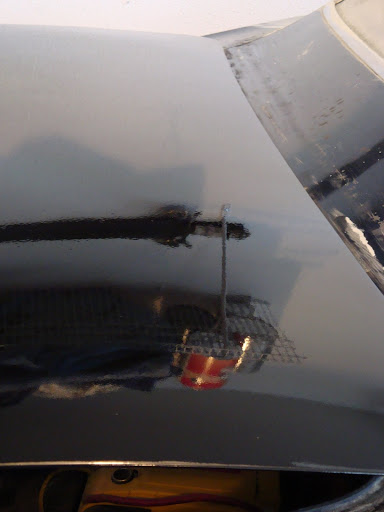

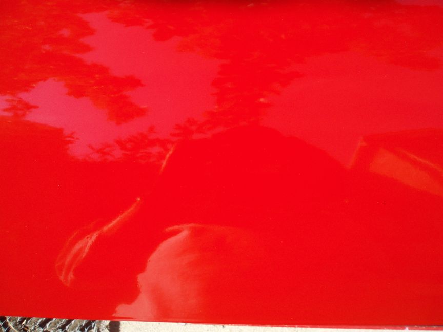

I'm trying to reduce my constant thread bumping by making this a 2 coat update. I've wet sanded with 400grit and then rolled coats 5 & 6. As of right now I think 10 coats will be enough but I'm not prepared to skimp over a couple of coats. I will glady roll 12 or 14 to give it some extra thickness. 800grit is up to bat.
(5th coat on the left and 6th coat on the right. They look very similar but the coverage is better
on the 6th coat. Don't mind the difference in contrast, I'm not a photographer)

Post by JimVonBaden on August 12th 2010, 8:40 am
Looking good! cheers
Take my advice, when you think you have enough paint, add two more coats. When you use the cutting pad and rubbing compound to smooth it all out, you will remove a layer or more to get out the microfine scratches. Then polishing will bring out the shine!

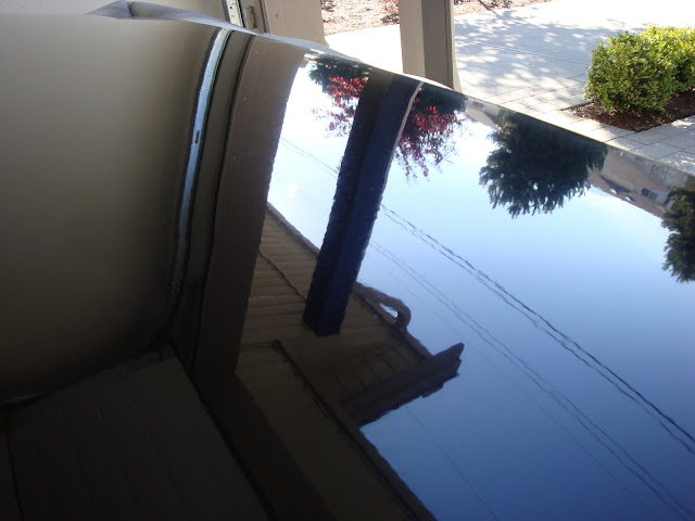

Hey Jim, I would be interested in those part numbers! I checked into it and it seems that my grinder and orbital sander will be too too fast (RPMs) to polish with. I guess I'm going to buy or borrow a polisher.
I sanded with 800grit and then rolled coats 7-8. The coverage is awsome and I'm happy except there are a bunch of small pitts that won't cover. They weren't there before coat 7. If I didn't clean it myself I would suspect that it wasn't cleaned good enough. So I'll have to check it out after coat 8 is dry. I will be disappointed if I have to sand coats 7-8 off but it's a possibility. Arg...
(7th coat on the left and 8th coat on the right. The coverage is great but there are several "pitts" in random spots all over the lid)

Post by JimVonBaden on August 14th 2010, 8:22 pm
It doesn't look too bad. I always clean with denatured alcohol before rolling just to make sure.

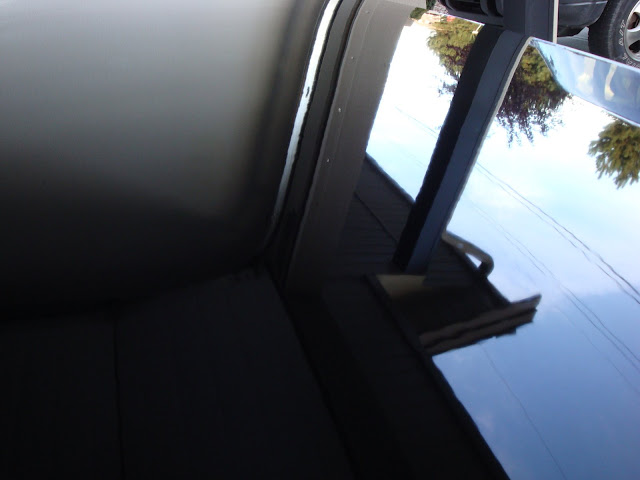

I've been trying to keep my updates less frequent... but I've made some progress and I needed to share. I tore the lid up today with 800grit and probably went thru 4 layers of paint. I was determined to get rid of the little pitts and craters in the last couple coats. It took a while but I got it done. The whole lid is smoother and looks phenomenal. Now as long as I can keep it like this and apply the next few coats it should look awesome. I'll probably hit a few pawn shops tomorrow to look for a good but cheap polisher. Thanks for the great product information Jim!

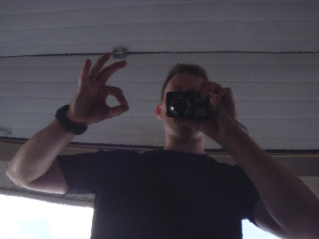

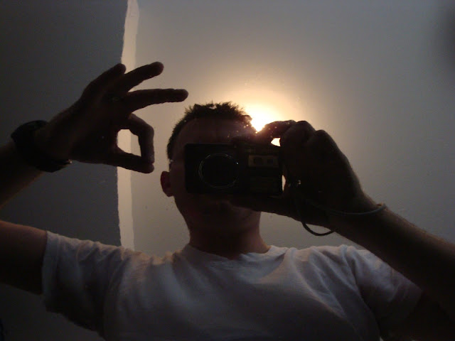

(My reflection after the 8th coat with all the pitting)
(My reflection after the sanding and 9th coat ... I'm happy!)

Post by JimVonBaden on August 15th 2010, 8:17 pm
Looks great!

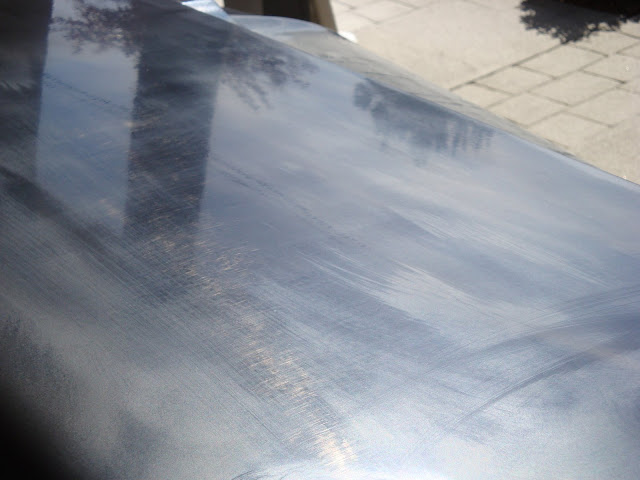

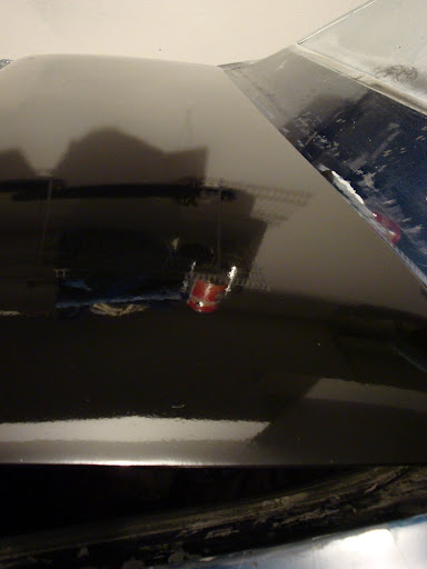

Well I got my Meguiar's foam polishing and finishing pad in the mail yesterday so I went at it today. I sanded the lid with 2000 grit and it looked really good. I applied a decent amount of Meguiar's Ultimate Compound to the pad and rubbed it onto only HALF the lid first. I then used a low setting to start (never used the polisher before) and made several (2 minutes worth) passes over the lid and then wiped away the polish to see what I'd done... It looked very cloudy and very dull but it did have some reflective qualities. So I figured that I just hadn't gone long enough. So I did it again for another 2 minutes with more UC of course. Checked again, still dull and crappy. I then figured that maybe the machine was too low so I turned it up to speed 3 (out of a possible 5) and tried again for another 2 minutes or so.... it is consistent... consistently dull and hazy. It looked a 100 times better before I sanded. So I tried again on speed 2 for another 2 minutes and checked only to find that it's still dull and hazy looking. You can see yourself in it and the reflection clarity is decent but you have to really focus through the haze do see it. I just don't know what do say.
I have used way more UC than I should have needed to in that area. I figure that with anywhere from 6-10 minutes of time on only half the lid I should be done or at least made some decent progress. I figure that my problem could be one of the following:
- Didn't wait long enough since 14th coat of paint (12 days ago)
- I'm using too much polish (is that even possible?)
- My machine is to weak or I haven't turned it up high enough
- I'm impatient and I just need to keep going at it
- My microfiber cloths are garbage and aren't wiping the product away properly.
Anyone have any ideas? Obviously it could be any number of things but I just don't want to push through and then end up at bare metal or primer. Should I try a spot by hand and see what that does? How long would you say it should take to do half a trunk lid with a polisher?
Thanks for any help you can provide!

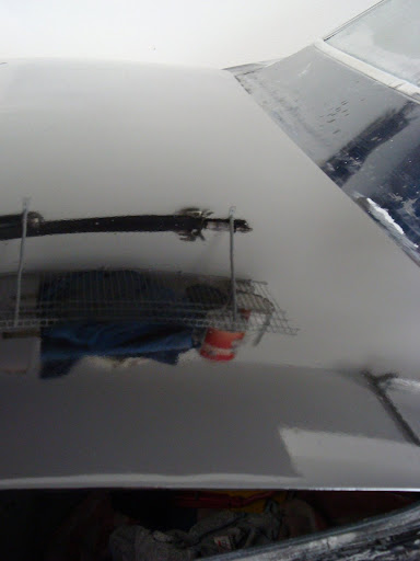

(14th coat - Good shot of the paint before final sand and polish)
(14th coat - My reflection standing under the garage door. Needs polish but otherwise it looks decent)
(After 2000grit sanding and polishing for 6-8 minutes. It only looks streaked AFTER I wipe it off with the microfiber)
(The consistant cloudyness post polish. Have I burned it? Am I impatient? Is it my shitty cloths? Uggg help me)

Post by Ian67 on September 2nd 2010, 3:02 pm
A quick update... I tried a small spot using an old waxing sponge and I rubbed in a circular motion for about 2 minutes on a 2"x2" spot. Then tried to wipe the remaining polish away and it streaked like hell. I am very confident that at the very least, my clothes are junk and arn't actually wiping the polish residue away but merely smudging it around. I'll have to go buy a couple decent ones instead.
The first few times I polished on the lid I noticed that the polish was still white-ish when I wiped it off... Was I not letting it break down enough before I removed it? I have a feeling that I was using too much polish and not polishing long enough prior to removal...
Any thoughts?

Post by 63Falconconvert on September 2nd 2010, 4:12 pm
Looks to me like a combination of too much UC and not enough RPM's on the buffer= not enough heat generated to bring the shine back. After 10 minutes you should see a very clear deep shine. I'm a little surprised that that the shine isn't coming up for you. You might need a more aggressive pad to cut with. I like to use a wool pad for cutting then switch to a foam for finishing.

Post by Squire Cobra Jet on September 2nd 2010, 5:52 pm
It looks to me like too much polish.
I have been applying the UC by hand with a sponge applicator and rubbing it in by hand.
As soon as I apply the polish I start to rub it out and I repeat the process for a total of 5 times in one area before moving onto the next section to get polished. I also follow up with a wipe down of the area I just finished with a clean towel. I only use a small amount of polish in each application.
Try a small section by hand as I described and see if it looks any better.

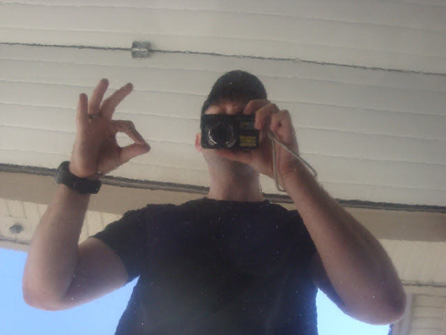

Post by Ian67 on September 2nd 2010, 10:27 pm

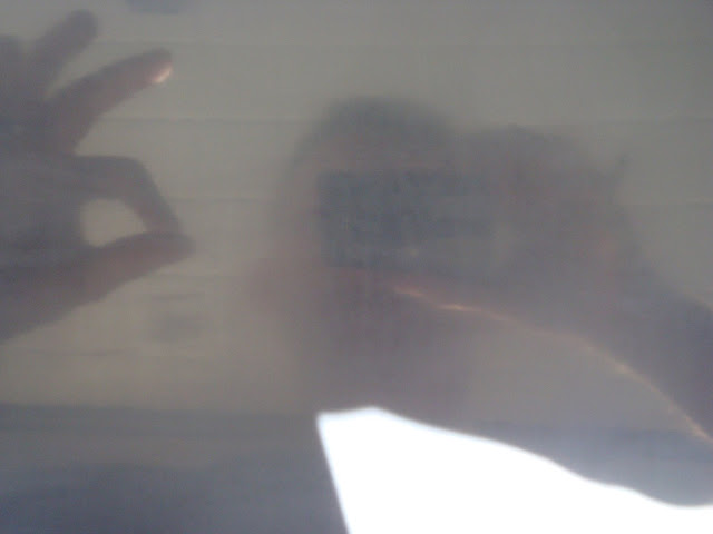

Well I went out there determined to make progress and I got some. I put my buffer at MAX speed and did not add ANY UC to the pad. I did the same area and the remainder of the lid using no extra UC and it looks much better. However I still find that no matter how long I polish the surface still feels greasy and has a slight streaked look. I can actually smudge the surface with my finger and make it look like a greasy fingerprint. Don't get me wrong, my heart is no longer in my stomach as I'm confident that I can fix it now. It could be that my buffer just doesn't break the polish down good enough or it could be that my cloths just aren't good enough to absorb the greasy polish residue. My pictures look good but if you look you can see how reflections aren't quite as crisp as they could be.
(Phew... it's looking better but still not perfect)
(The finish is obviously better but it still looks rippled and in need of clarity)
(I thought that this close up reflection really showed how unclear the finish was up close)
Any thoughts?
p.s. I still haven't got any new cloths yet, I'm not quite convinced it's their fault.
Re: 67 Camaro - Black on Black
Post by Squire Cobra Jet on September 3rd 2010, 1:24 am
It is looking much better. It sounds to me like too much compound and the cloth you are using to wipe up with has gotten over saturated with compound so that it is not cleaning off all the excess polish residue. The air is so dry where I am at that the polish is almost power form by the time I am wiping it off, which is no time at all. The only time I have encountered a greasy spot is when too much compound was applied.
