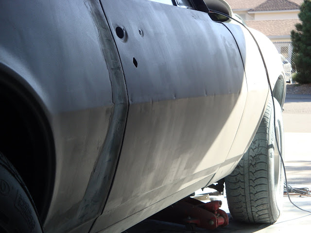

Post by Ian67 on October 13th 2010, 5:39 pm

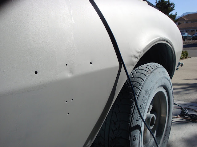

I've polished the trunk lid a bit more and am finally starting to see some respectable results. I'm now confident that my polisher is just to slow to get me the results I want... in the time that I want them. It will work, but it's going to take me a lot longer than I expected. I've had less time lately so the whole project has slowed a bit. The following pics show some results, but I'm going to have to go at it again soon.
I took a week off work and managed to strip the passenger side of my car down and get it primed. Unfortunately I used all 10 of my grinder strip wheels and burnt out my grinder. Luckily CT replaced the grinder as it was under warranty. The problem with the grinder, and running out of strip wheels slowed my progress and I didn't get the whole car done as I would have liked. I also uncovered a mountain of bondo on the rear quarter and front fender lip. It's weird as it looks like they went crazy with the bondo, and they didn't really need too as the curves of the metal are pretty good as they are. There is a lot of weld lines, dings and dents that I didn't expect to find, so I just primed over them all to keep the rust out. I'm sure I can fix the small stuff but I'm nervous about the back quarter as I don't know much about this stuff and it looks ugly. Anyway, here are some pictures of my work in progress.
All that filler is my handy work. I just blobbed it on as it was drying so quick that I didn't
have time to spread it out and take off the excess. Just means more sanding for me, yaaahh!
It almost looks like chrome molding holes... but I actually think there just dings as there are no holes or weld marks.
More damage around the front fender well. I'll fix it up but most of it should be hidden by the chrome molding.
Note to self: If you're not going to remove the clothes, at least cover it up before you strip/sand in the garage!
Next step is to buy some more grinder wheels and get the rest of the car stripped. Thats the plan for next week. I think cleaning the garage after will be the hardest job so far! Smile

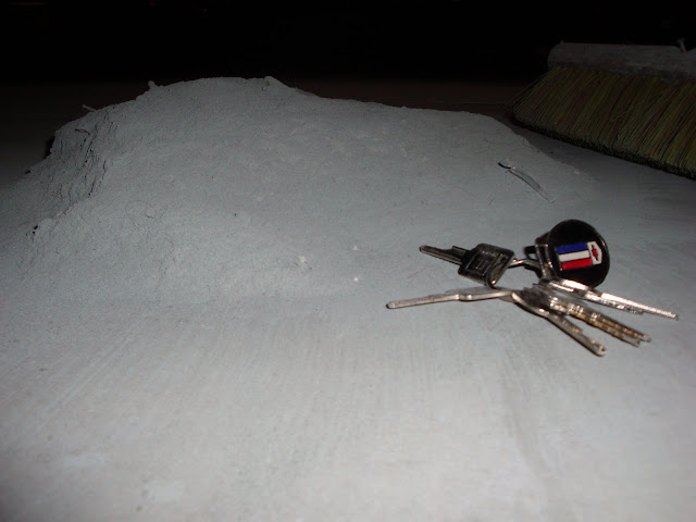

Post by Ian67 on October 23rd 2010, 1:03 am

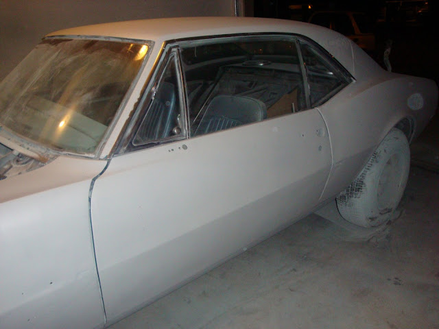

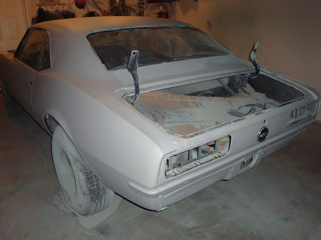

Just another quick update. I've managed to strip the driver side and back of the car. I've still gotta strip the hood, front panels and the spoiler, but it won't be long until it's all primed and ready for bodywork. There are only 4 areas (so far) that require serious attention and the rest are just small dings that require a quick fill. So I'm excited to get working on it so that I can throw on some more primer and get to paint. Oh yes.. and the sanding.. I'm going to love sanding too!
The lens has some water spots on it, but yep, the car is almost completely stripped. Wow, check out those wheels.
Now with primer, you can see a body issue right where the quarter meets the roof.
The back of the car was almost mint, just a small dent in the lower right side.
Still gotta paint the trunk hinges, but I'll probably do a scuff and spray on those.
This is after about 10 minutes worth of sweeping the garage floor. Note that this is about the same
size as the pile from when I stripped the passenger side. The pile is almost 2' around.
Next week I'll strip the rest and get them primed. If I have time I'll start on the bodywork. Slowly but surely.

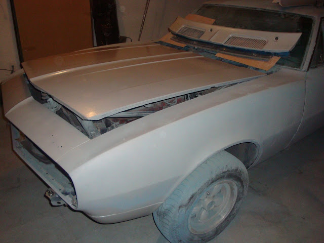

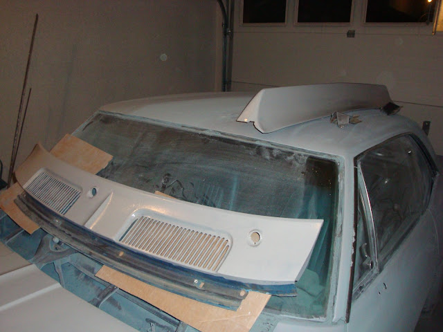

The whole car is stripped and primed now... well minus one side of the spoiler and a little bit on the cowl. It's going to need more coats of primer and a ton (for me) of bodywork to get it paint ready. I spent about 4 hours cleaning the garage today and it's going to need more work once I start and move the car tomorrow. Here's some more pics.
Starting to look like a grey Camaro... what a great accomplishment to get the car so far.. lots of work left though Smile
The back half of the spoiler is still blue but it looks pretty good from this angle.
Tomorrow I will see how the hood dries and consider putting on a 2nd coat of primer.

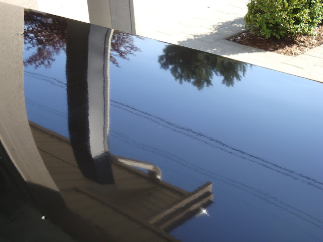

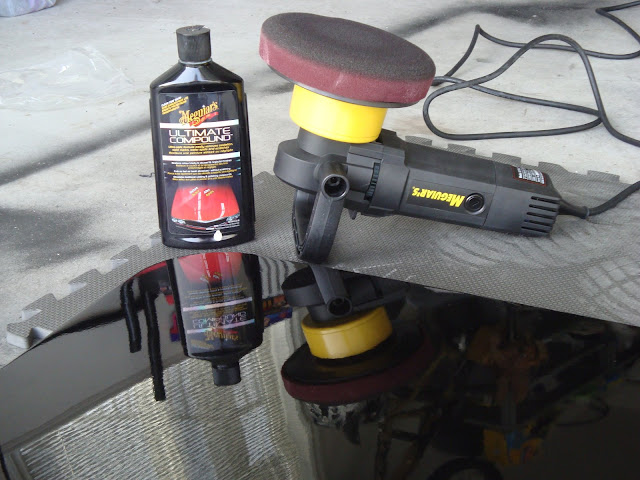

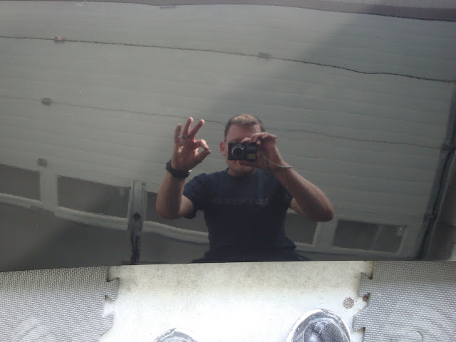

It's been just over a year since my last update. How time passes! I've done quite a bit to the interior of my vehicle but I've procrastinated (due to funding issues) on the exterior bodywork and whatnot. I did recently purchase a DA polisher to get a solid idea what all those hours spent on the trunk lid can look like. I'll throw a few pictures up. I will probably do some more polishing on it in the new year but it looks good for 5-10 minutes worth of work. Here's hoping the rest of the car will look as good, if not better.
Before compounding with Meguiar's UC on the left, and after on the right. Still needs work but is still a much sharper, scratch free image. I should have dusted it off before taking pics.
This is after compounding the whole thing. Night and day compared to the pre-DA images.
Here is my DA, compound and the semi-finished lid. I've since thrown a coat of NXT 2.0 wax on it to keep it safe over the winter. It's probably has a deeper, blacker finish than our factory paint vehicle.
I look forward to finishing it off and getting back to work on this in the new year. I'll probably do some small things on the interior while it's cold outside and save the big stuff for later.

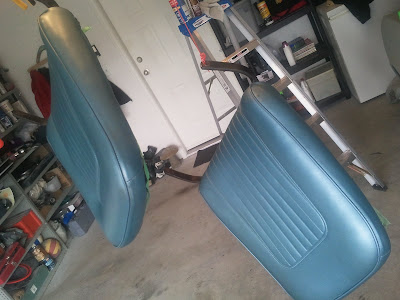

It's been a while since I posted here and it's time to cease the silence. I actually haven't done much of anything on the exterior of my car but have spent some time on the interior. Over the last week I've collected the items required to redo the upholstery on my seats. Anyone who has followed my project would know that I'm as cheap as they come and you'd never catch me spending $300 on new upholstery. How about $30 on Dupli-Color Vinyl & Fabric spray!
I bought a can of clear Dupli-Color Adhesion Promoter and 2 cans of black Dupli-Color Vinyl & Fabric spray. My seats were the factory blue and the upholstery was original and fading. Overall the seats had no rips or serious signs of wear, just general ageing. Since it was a cosmetic restoration I felt no need to re-upholster so simply changing them over to my new black interior theme seemed like the way to go, but not without a big speed bump...
I started by cleaning the seats with a wax and grease remover. I went through every crack with a nylon toothbrush and a clean rag. Then I applied 2 coats of the promoter and 3 coats of black. When it dried (about 10-15 minutes), it looked like total hell! Some of it 60% of the seats surface looked dull and almost grey.
I was so unsure of what to do, I emailed Dupli-Color for some kind of direction. They replied with a confident explanation and instructions. The main idea is that because the seats are 45 years old, they likely required more promoter. So they told me to do 4 more coats of promoter (the rest of the can) and at least 3 more coats of black. So I did about 4.5 coats of promoter and finished off my second can of black with 4 more coats. That's a total of 6.5 coats of promoter and 7 coats of black.
However, the results are amazing! The pictures look good but even in person it looks like new upholstery. Even the color tone and shine is a match for black vinyl upholstery. I did the same procedure on my rear bench seat last year and have moved it around the garage, in and out of the car dozens of times since, and it still looks as good as when I sprayed it.
I'd be interested to hear the long term usage results from someone that has used Dupli-Color or SEM on their seats. It looks good and seems durable to me but then again, I havn't had it for years with frequent regular use.

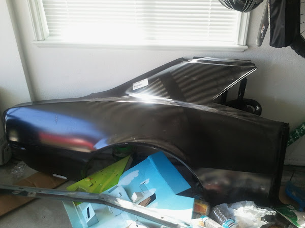

Wow, so another year blows by, but I have progress to report. When I posted last May, I had finished my seats and had to pickup my new passenger side rear quarter panel. We'll, I got the panel and replaced it. Their were problems, purchases and a welding learning curve but, it turned out great!
Here's what $340 gets you in Canada. Almost didn't fit in my vehicle for the ride home.
I pulled the rear glass by running a piece of fence wire around the seal. Hah, I didn't even break it.
Using a 1/32 grinder cutting disc, I cut away as much of the panel as I could.
Used a blowtorch to melt the lead on the sail panel, then drilled out the remaining spot welds with a spot weld cutter.
I used a Blair standard point spot weld cutter, it looks just like this.
Drilled holes in the new panel to replicate spot welds like the original panel.
My father in law came out to help, actually, I think I helped him a lot more than he helped me.
We found a good use for my clamp straps and vice grips.
The panel fit pretty good but did require some massaging to line up the body lines. It really couldn't
have turned out better. All the welds were sanded smooth and I've since primed it.
I'll be starting on bodywork either today or tomorrow, maybe both. Billions of pictures to follow!
