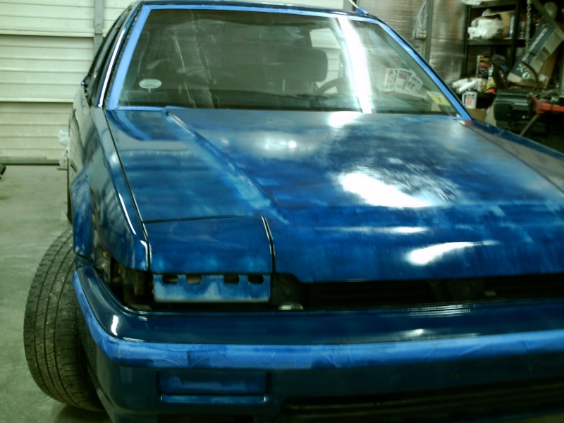

So exams are finally over and I can start painting my good ol' daily driver. This car is an 89 accord that I bought for $150. Now, for $150 the car is excellent shape; however, I want to do away with the faded paint and chalky spots that 18 years of wear and tear have put on this car.
Here are some photos of what the car looks like now.
I want this paint job to look as good as possible so there are some little dings here and there that need addressing. I walked around the car with a water based marker and circled any imperfections that I saw in the current finish. The best way to spot these dings is to look along the surface at an angle and watch for differences in the way light is reflected. Here are a few pictures of the areas that I need to work on.
The passenger quarter panel looks like a golf ball.
These dings will be filled with a surface glaze instead of rage body filler because none of them are over 1/16" deep.
After I identified all of my problem areas, I began removing any parts that aren't going to be painted. This will allow for a cleaner-looking paint job as well as reduce the amount of masking that I have to do. I started by removing the ventshades that I hated anyway. In this picture, I am cutting the foam tape with a piece of copper magnet wire.
Next, I used a razor blade to scrape of the vinyl pinstripes (another automotive accessory that I despise).
Using a scrap piece of steel with a knife edge ground on, I cut the foam tape behind the emblems on the rear of the car then they simply peeled away. (tip: depending on the car these could have bolts holding them and it is good practice to take measurements to put them back in the proper place once the car is finished and it is time for reassembly.
The taillights and plastic filler plate were removed along with all the license plate lenses.
In lieu of a conventional drip rail, this car has three different weatherstrips around the top of the door. I removed the outermost weatherstrip allowing access to the side windshield moldings which were also removed.
I then disassembled the passenger side front door removing the glass, outer door handle, mirror and all of the window trim. I will do this for all of the doors allowing me to paint under everything, hopefully resulting in a longer lasting paint job.
Tomorrow I should be able to begin preparing the surface for paint and fill the dings and scratches. Then I can roll on with this project. I know this was a lengthy post on just taking the car apart, but as it has been said before, the key to a great looking paint job is in the preparation. Bear with me, I'll get to the good stuff soon.

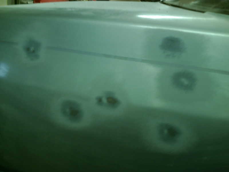

Body Work and Door Jambs
Hey Guys,
I'm back and this time I brought a boat load of pictures by popular demand. Today's work session included lots of body work and some of the Brightside was finally put on the car.

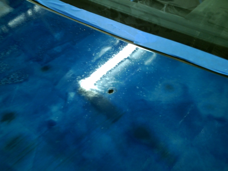

I started out by using my DA sander to sand and feather out all of the blue circles that I drew on a few days ago.
Here's a pic of a spot sanded down on the hood
A bigger shot of the hood with all of the dings sanded out
My trusty old DA. This thing is probably older than me.

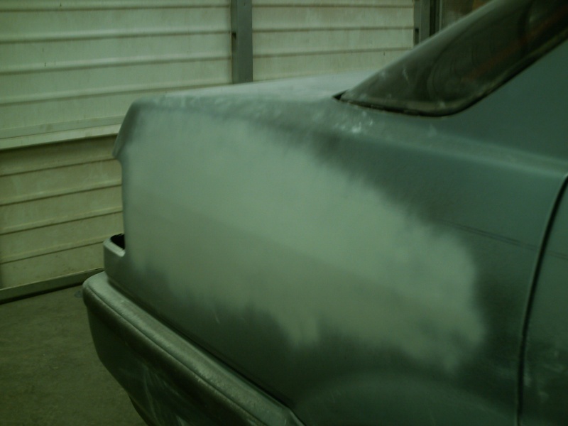

This is a shot of the "golf ball" quarter panel with each ding sanded out
The anatomy of a ding. The light part in the center is the clear coat that isn't getting hit by the sand paper. The point is to fill this depression level with filler so that the surface reflects light evenly.
The weapons in the fight against dings. I'm using Dynatron putty-cote. Get it or a comparable product from a paint supplier. Don't skimp on this stuff. That cheap one part glaze coat in the red tubes is junk and will shrink like crazy.
These shot are of the putty-cot applied to some of the affected areas. I would have shot pictures of it going on, but I only have two hands and all three of them were busy.
Here's some pictures of the filler after being sanded down
This section of the fender needed some special attention to repair the creased fender lip.
Here it is after the filler was sanded smooth.
And here it is in primer. My little brother even gave me props for the quality of that repair.

This is the golf ball quarter again. You can just make out one little low spot right in the body crease.
This turned up about three spots that needed attention. But I found that the hardened lacquer was just clogging the sand paper so I removed it with some acetone and a rag before applying more filler to the spots that needed it.
A coat or two of Rust-o-leum automotive primer left the quarter looking nice and smooth.

First Coat
Hello again,
I got some more pictures of my progress. I finished up the body work this afternoon and rolled on the first coat. That advice the badbyrdconcepts mentioned earlier about the guide coat is spot on. I put on a thicker coat of lacquer in order to check the gloss. When using as an actual guide coat you want the sprayed paint to resemble powder on the surface. If you put it on thick like I did then it will clog any sand paper that you apply to it. Thats why I used a acetone soaked rag to take it off and apply some primer then a light guide coat. The lacquer will be left in the low spots.
But all that aside, lets look at some pictures. Here is the car wiped down and taped off.
These are some action shots of the paint going on
Here are some shots of the car with the whole first coat on.
This is a shot of the lower door skin. This gives an idea of the gloss that this paint has
I know the pics aren't that clear but the low temps allowed this stuff to self level and leave very little orange peel. So if I can keep this going I may be able to only wet sand the car one time. Anyway this I what it looks like so far. Feel free to comment/criticize, I should be laying on another coat on Christmas eve morning.
