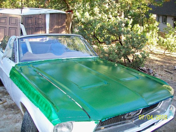

I think I found a good mix.
the above pictures were taken after 12 coats on the hood and fender tops and 10 coats on the fender sides. The mix I am using is half Rust-Oleum Topside Gloss Deep Green and Rust-Oleum Gloss Black. I use 3 parts paint mix, 3 parts Mineral Spirits and 1 part Penitrol.

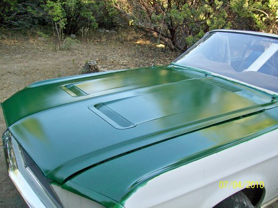

Here is what the deep green looks like without being mixed with another color.

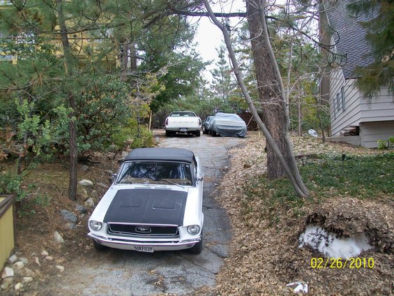

Here is what the car looked like before the new paint.

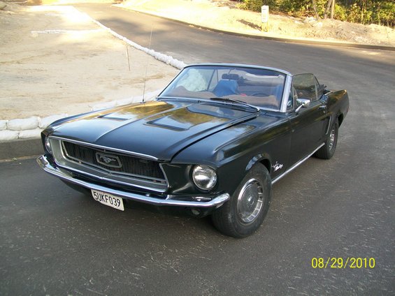

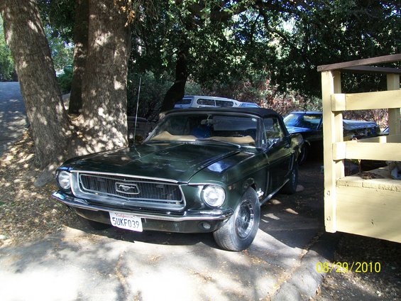

Well, I have finished it up. 14 coats on the Hood, deck lid and fender tops and 12 coats on the side panels. I like the way the color came out. Depending on the amount of light it will shine from Forest green to Black. I still have a few little touch ups as I polished it out I found a couple little runs that I did not see through the sanding process. Overall I am very Happy with the results. Now I just need to fix the hood latch and install the M-U-S-T-A-N-G letters on the rear deck lid and wait a couple months to wax it.
