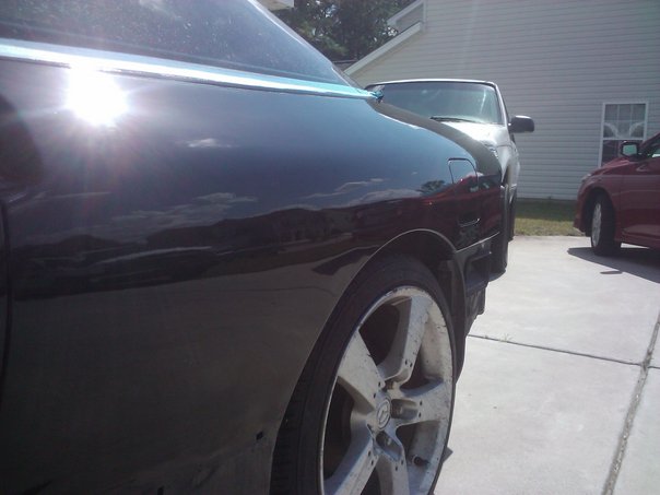

Post by zeconcepts on September 25th 2010, 7:10 pm
Ok..here you go, final quarter panel before waxing...wet sand with 2000, w7000 pad with UC and swirlx with w9000 finishing pad...check it out, I couldnt be happier!!!

Re: 1994 Ford Probe Black
Post by Ian67 on September 25th 2010, 9:02 pm
That looks great! I'm sure it will look even better after wax. I can only hope that mine turns out this good!
