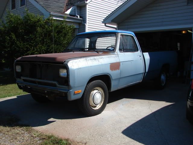

Hello everyone, I thought I would try this on my old Dodge pickup. Great old truck, just a little over 100000 miles. I got it about 7 years ago and havent really done anything to it. Looks like someones old farm truck, lots of surface rust and faded paint. One big dent in the side.
My main objective is to take care of the surface rust and do what I can with the dent. Not expecting anything close to a show finish, not even sure If I will buff it out but who knows.
Found this "before" pic, you can see the dent in this pic. The top of the roof and hood have a lot of surface rust, no real thru rust at all and the truck is really solid otherwise
Plus a few other before pics with some work starting

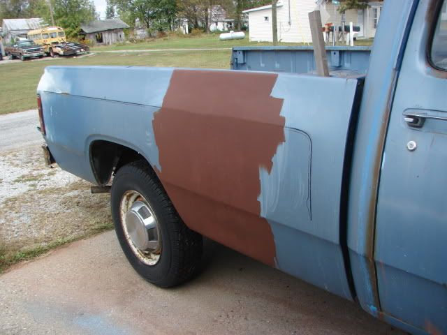

More progress pics, just some basic half arsed body work. Beat out most of the dent and layed in some bondo to get it close.
Re: 1984 Dodge D250
Post by ANeat on October 10th 2010, 7:59 pm
You can see in some of the pics I put some color on the roof to try. Its Rusto Sail blue. I was trying to get something a little lighter and ended up mixing 2 quarts of the sail blue into a gallon of white and decided that was good enough.
Went ahead and rolled on some rusty metal primer after skuffing everything up and wiping it down. Seemed like a good preventive measure Wink

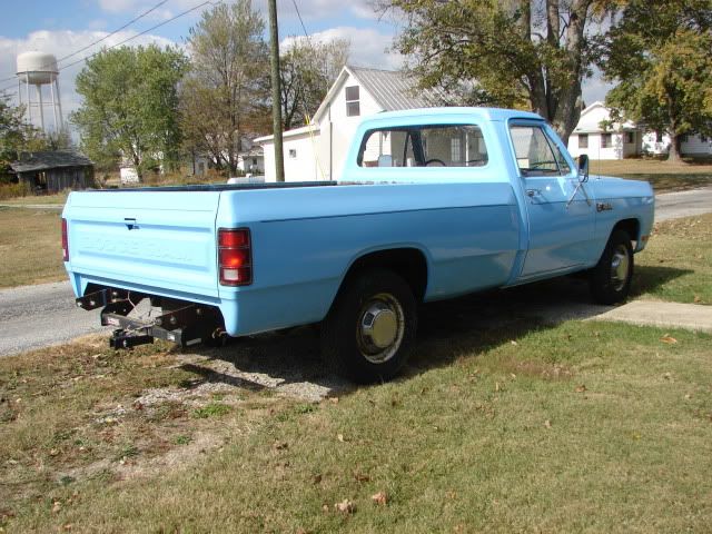

Post by ANeat on October 15th 2010, 8:26 pm
Alright folks, After 5 coats and minimal sanding I decided it was good enough and started putting it back together. Still a little bit of peel but I may attempt to buff it it sometime in the future.
Still have to clean up and paint the bumpers, then thinking about a roll on bedliner.

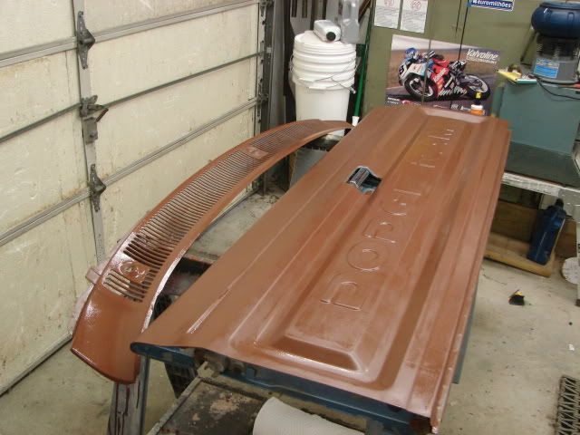

Here is a shot of the tailgate, 5 coats with no sanding after the initial prep, with a little water that dripped off the garage door....

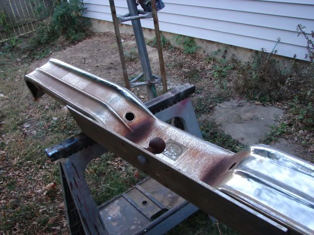

Post by ANeat on October 16th 2010, 6:51 pm
I think I about got it finished today. Finished up the bumpers last night and got them mounted today. Rolled on silver hammer finished Rustoleum on those.
Before
And after, painted and mounted

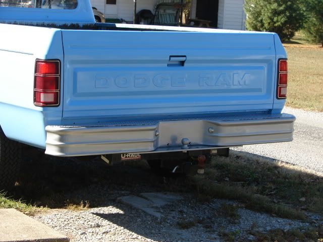

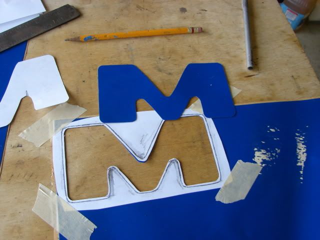

Post by ANeat on October 17th 2010, 2:50 pm
Found some dark blue decal material from my motocross days so I set about making some letters.
First lay a piece of paper over the raised letter
Then rub the edge of a pencil on the raised edge creating a line on the paper
Keep doing that till you get a set of letters.
Re: 1984 Dodge D250
Post by ANeat on October 17th 2010, 2:56 pm
On the originals the edge of the decals are set back a little from the edge so I did the same.
Cut in about 1/8 inch from the line
Then a little windex to help positioning and stick away.
