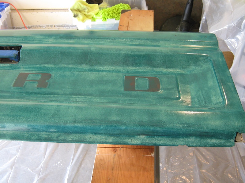

1st coat on the tailgate with the Ace Rust stop
Post by Gobeavs on October 11th 2010, 10:33 pm
So here is the best part on the Ranger, the tailgate!!...lol...bought this from a guy who had a whole storage unit of nearly new tailgates. It is marked 84 Ranger and is in almost perfect condition. Smile I rolled on the first coat of Ace Rust Stop in Deep Teal this afternoon. Covering white is not easy but I am not discouraged yet. I went with a mix of 2/1 paint to Ace "odorless" MSpirits. I am gonna follow the manufacturers drying times and hope for the best!!.....I started with what I think is now a difficult part to roll. All the ridges and angles on the tailgate are a challenge. Thanks so much to those who have posted detailed results and pics on this site, it gives me a bit of confidence!!......As my girl says "you cant make it look any worse" Rolling Eyes http://i24.servimg.com/u/f24/15/74/48/10/first_12.jpg

Re: Goin rollin with Deep Teal on my 92 Ranger
Post by Squire Cobra Jet on October 12th 2010, 1:01 am
That looks pretty typical for a first coat, by coat 4 to 6 you should have full coverage. The mix ratio sounds like it might be a little on the thick side. Watch out for Orange peel.

Post by Gobeavs on October 12th 2010, 9:22 pm
Second coat went on without a hitch tonight. Starting to get some better coverage but you are right SC Jet I gotta try it a bit thinner!..After i sand it this time I will probably get a good idea about how the peel is gonna be Crying or Very sad I can really see how the coats need to be thin and light. I have spray painted a lot of wood and it is the same way there, lighter is better but more time consuming. Has anybody out there actually finished a car with this Ace brand or am I truly a "risk taker"????? Shocked Shocked Shocked ........thanks for your support.....rollin along, Brian........http://i24.servimg.com/u/f24/15/74/48/10/2nd_co11.jpg
Post by ANeat on October 12th 2010, 10:57 pm
Hey I think those guys did a good job matching the color. Seems like I heard of someone else using the "Ace" brand of paint. I think its all about the same stuff if its oil based like Rustoleum and the others.

Post by Tommy Hillbilly on October 13th 2010, 1:37 am
Thought about adding any Penatrol?

Post by Gobeavs on October 14th 2010, 9:47 pm
Yea I thought about asking at ace today about the penatrol but not convinced its neccessary. The first sanding last night cut through some of the coats but I am not getting worried yet. Thinned the Rust Stop to 2.5/1 thinner/paint. Rolled it really smooth with the third coat but its gonna really slow the coverage down. Covering white with the teal is a *****. Thanks for the compliment on the color Aneat but that is a straight mix of the Ace Deep Teal as listed in their handout, not specific to my truck!!... Very Happy

4th coat is down
Post by Gobeavs on October 15th 2010, 10:38 pm
Sanded through the 2nd coat in a few places!!.... 4th coat went well. I went back to the 2/1 paint/thinner mix, just seems to be a balance between coverage and runs/peeling. This is gonna be a beautiful "20 foot" tailgate Shocked [left][right] Sorry about the jacked up text and pic alignment this postin stuff is still new to me rabbit

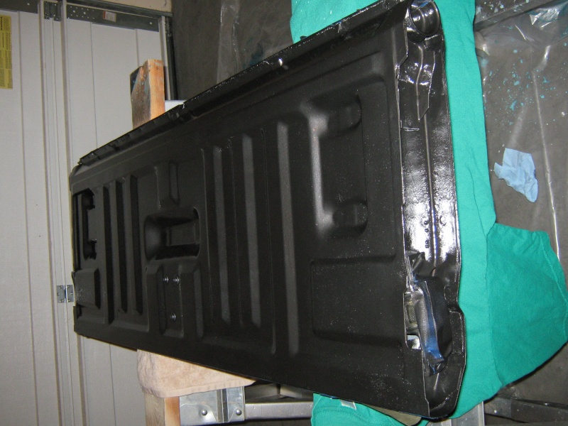

Post by Gobeavs on October 23rd 2010, 10:26 pm
[img][/img] So I got 6 coats of Ace Deep Teal on the outside of this gate and now am working on the interior of the gate. I want to roll the whole bed but I am trying to do it on the cheap with some Rustoleum Hammered rolled on. I am really happy with the look, texture and hardness but am a little stumped on why I got the "air bubbles" when I rolled it with a 1/4 nap roller as recommended by the manufacturer??????..........Any suggestions?????....i wetsanded with some 400 and wiped it down with some acetone. Should have been clean enough but i may need to ruff it up some more sanding first. I am gonna hold off on doing the whole bed just yet as I can't live with these results. Should I just pony up for the Herculiner coating and do it with that?????............Brian.........

Post by Tommy Hillbilly on October 23rd 2010, 11:30 pm
Gobeavs wrote:Should I just pony up for the Herculiner coating and do it with that?????............Brian.........
I was thinking that you should go with some kind of roll-on bedliner.

I put the silver hammer finished rusto on my bumpers. It seemed to go on real well but I used the same type of small foam roller and just used it right out of the can.
The Herculiner or the Duplicolor Bed Armor are very nice. The one Gallon kit should do your truck easy

Post by Gobeavs on October 27th 2010, 10:12 pm
Well slowly I am getting back to the tailgate for the ranger. I am really happy with the way the Rustoleum hammered turned out except is does not look like it will be "tough" enough for the interior of the bed. I can still scrape it with my fingernail after about 5 days dryin!.....I finally found some quarts of Hammerite which I know is tough and hard when it drys. I will run a test soon with it. I rolled on 7 th coat of Deep Teal tonight and am happy with the way it layed down. Ratio was 1/1 with about 25% Penatrol. I think I am gonna like the Penatrol as I can immediately see the diff!!.....This tailgate that started white has been a pain to try and cover, I would not recommend it!!.....What are you guys using to "wipe down" the coats before laying another?..I have been trying acetone as a cleaner and degeaser just prior to rollin a coat. If you are in a dust free environment I suppose you are not wiping with anything huh???.....Thanks for listening !...lol...... tongue More pics to come soon!
Post by ANeat on October 27th 2010, 11:35 pm
I used denatured alcohol, it doesent smell as bad as the acetone if that matters to ya.
It sure doesent hurt to wipe it down.
Any of its good as long as it doesent take off your paint Laughing
