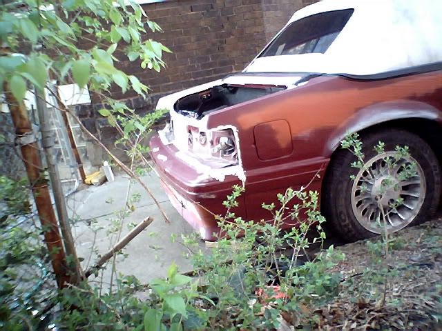

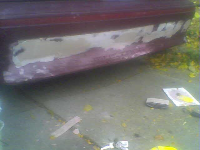

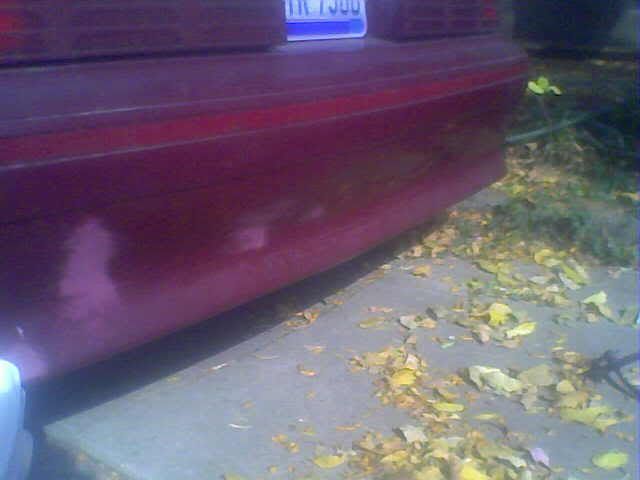

Today, I did a little more filler work, including on my wavy rear bumper:

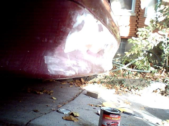

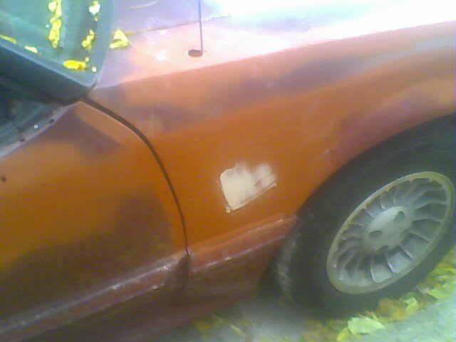

And where I dinged the fender, with an engine hanging on a hoist:
I also employed one of my patented half-assed techniques, rubbing body-filler into paint cracks with my fingertip.javascript:emoticonp('Twisted Evil')
I'd like to be ready for paint in the next few weeks, but it will be cold then... I'm still very tempted to paint in cold temperatures.
I was in my local Ace today, for some sandpaper, and I asked about Penatrol, and they said that they just started carrying it today! I saw it on the shelf. I also checked out their paints. If they can mix up something really close to my original color, then I'll be tempted to stay with the red. But I'm really wanting to make it black.

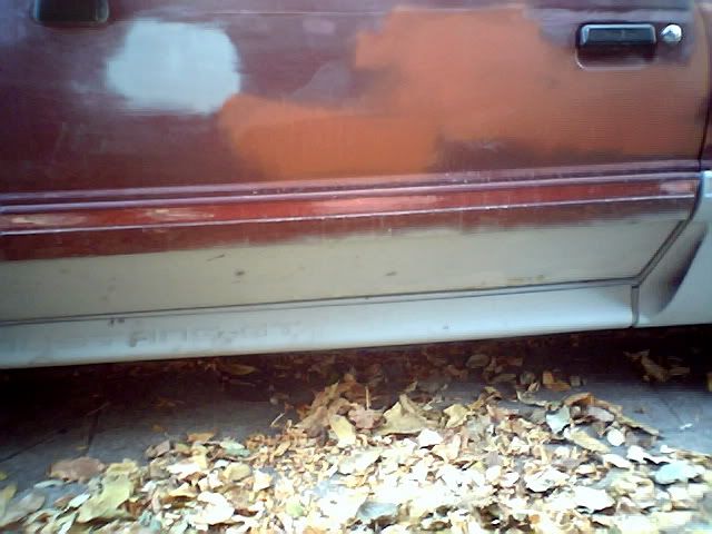

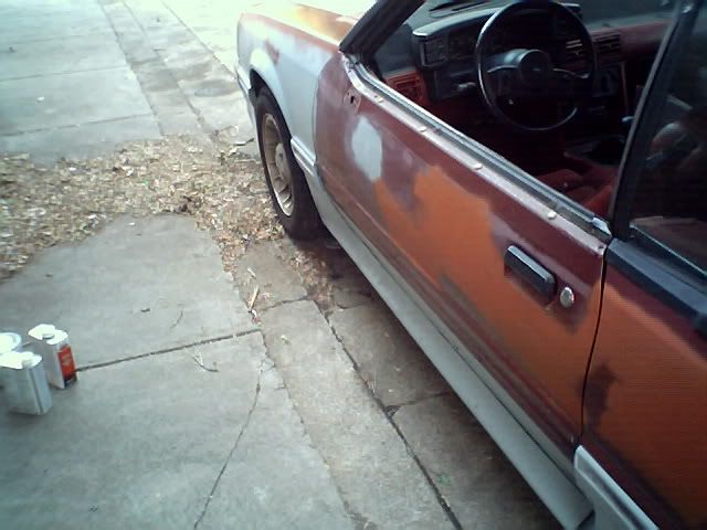

So tomorrow if it's dry, I want to finish up the bumper and fender, and that will leave me with the scabby driver's door bottom edge.

Did some more work on the bumper cover today. I ended up shooting a coat of primer, but daylight had run out, so I couldn't see if I'd reduced the waves enough. I can still feel some. I still have plenty more surface prep to go here. If I'm going to use black paint, this bumper cover needs to be straighter than it was.
Driver's side is straight enough for me. (There were just some minor dings.)
Got some rust coming back on the driver's door though. Previous owner bondo'ed and primered it.
The passenger side on this car suffers from some bad bodywork. This quarter panel is bowed out around the molding-line.
My camera is a POS, so it's hard to see. Probably the same moron who did this, adjusted the front fender the same way! I fixed that. I am going to paint this quarter panel, and maybe go at it with a come-along later, but my ultimate plan is to drill that quarter off of the car, and glue on a new one, and then paint it to match.

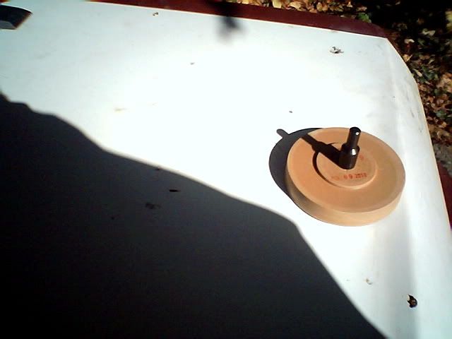

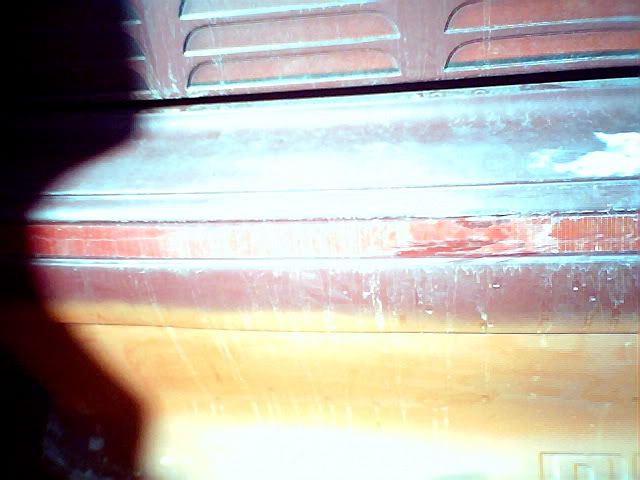

Yep, an eraser wheel is da shiznit!
It makes quick work of it too, but you need a corded drill - my 14.4 DeWalt made it through about half of the rear bumper... While my battery charges, I'll go back and scrape it totally clean. It appears you can merely obliterate the decal material (leaving lots of residue still on the bumper), and then go back later and manually scrape it.
Here is just 15 - 20 seconds of application:

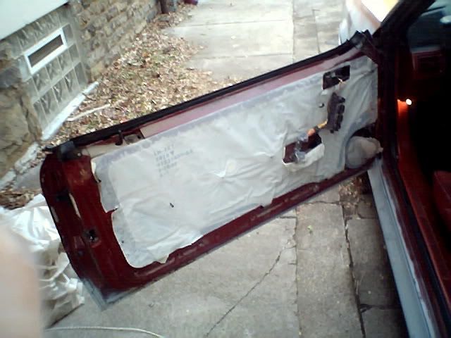

Well, today I went out there and worked on the car. I realigned the hood and made it a little better. I took off my inner door panel so I could take the mirror back off. I also swapped out the power door lock actuator while I was in there. And I removed the last of the two studs, with seized nuts, which fasten the front part of the belt line molding. (Convertible only - on non-verts, the outside rearview mirror covers this spot.) So I was finally able to trial fit my new molding piece, and discovered that the doorskin was missing a hole for the little plastic alignment tab, so I drilled a hole too. Those pieces were missing when I got the car, and it looks like someone had broken them off.
I think I'm going to paint it white because there are just too many imperfections. I'd like to get started jambing it out in the next week or so.

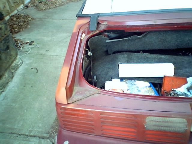

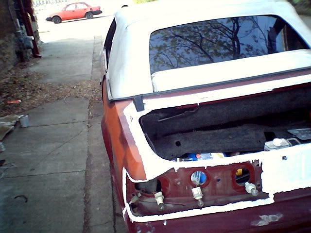

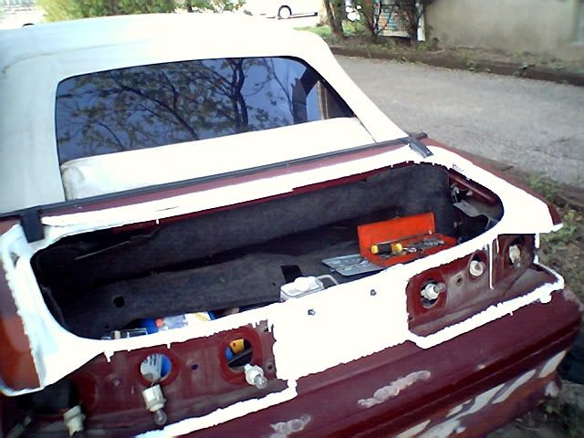

I got some paint on it today. I did the trunk jambs, and pulled the tail lights and license plate, and painted behind them. For this I used a roughly 50/50 mix of paint and Penatrol with no hardener. It looked like some bubbles aren't popping, but the coverage is pretty decent. It also seems to not be drying quickly, although it is a little chilly out there today. Tomorrow I'll do another coat.
Re: Rollin' ON my 5.0?
Post by Tommy Hillbilly on April 18th 2011, 12:05 am
Don't tell ME about masking... Smile
Post by Tommy Hillbilly on April 18th 2011, 9:26 am
OK, I went out there and checked the paint, and it's dry. But there are a lot of runs. I think I put it on too thick. Also, it's cold out, so if I do anything today, it will be inside. Guess I could do the tail lights.
