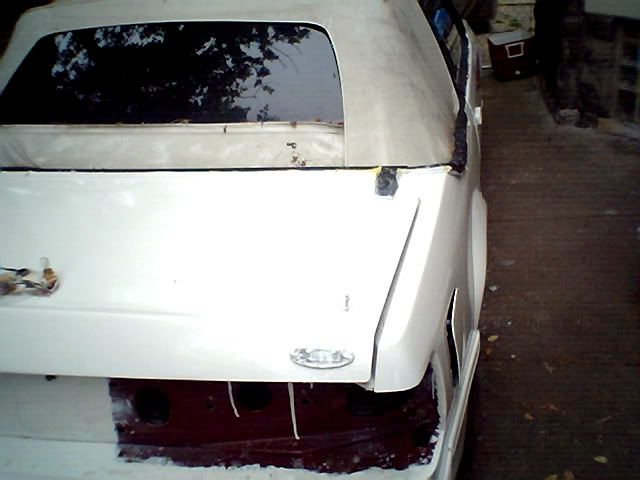

I'm gonna put the luggage rack and 3rd brake light back on. I also have a trunk lid which doesn't have the holes for that stuff.
They did make notchbacks with T-tops, I've seen them before. But they certainly didn't make as many of them as they did T-top hatchbacks. I had T-tops on an '84 Capri RS 5.0, and I'd rather have an all steel roof, or a convertible.

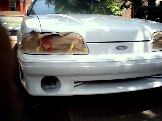

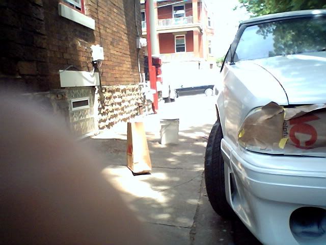

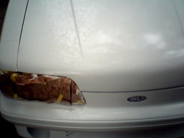

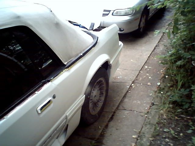

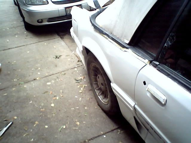

Dot my first coats on the passenger side tonight, and I think I have full coverage on the driver side. I'll let it set up good and dry, before I hit it with any sandpaper.
A roller is way better than a brush! And with my new thinner mix, it dries quick enough to get in at least 3 coats a day. It seems to hide the unsanded brush strokes I have on the driver side from yesterday too. And on sanded surfaces, it lays down really nicely. I'll see how the driver side looks tomorrow.
Tomorrow, I should be able to reach full coverage on the passenger side, and get the front "grill," bumper, and valence coated as well.
Then it's on to years of sanding, and undoubtedly some top coats...

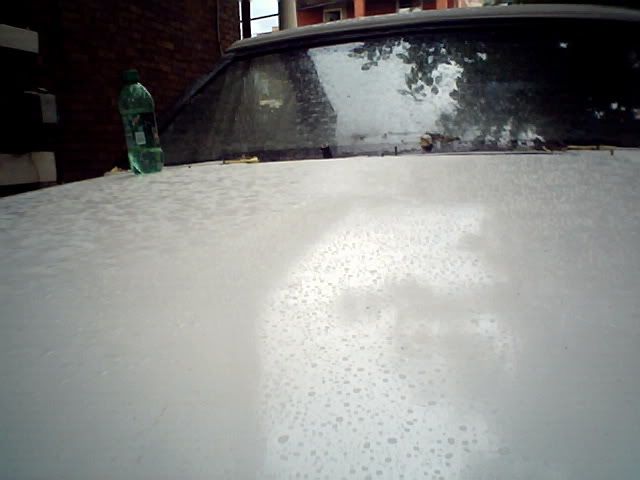

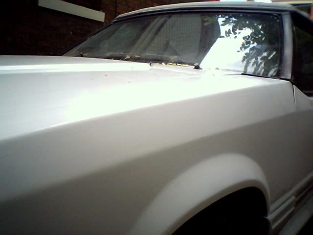

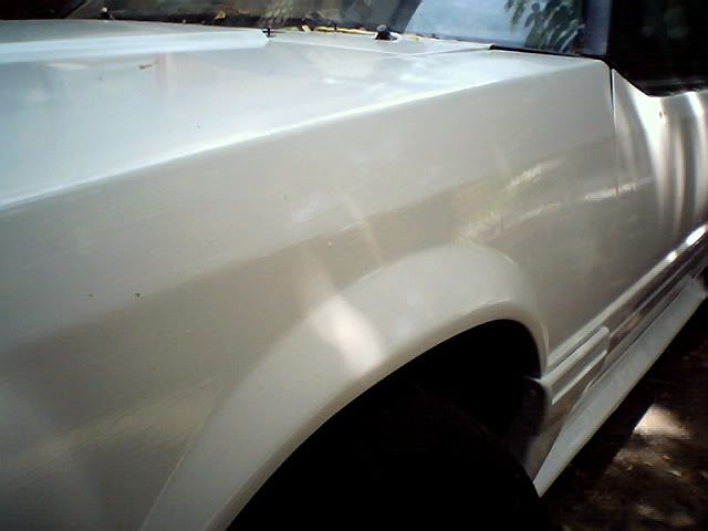

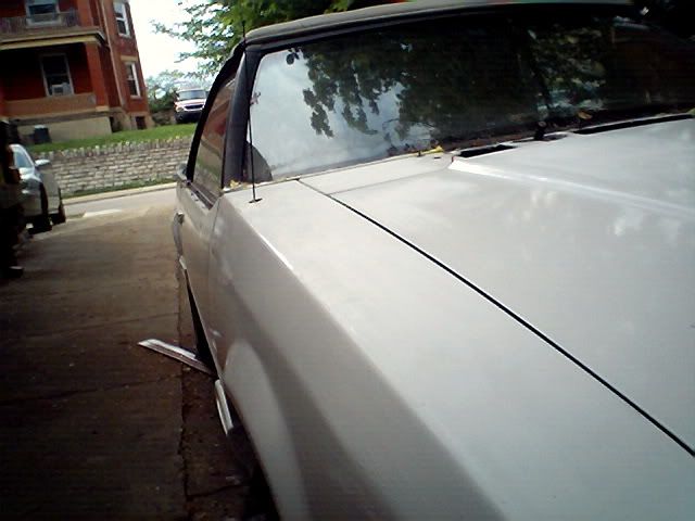

I love the way water beads on new paint. You can see that the passenger side isn't beaded, because I did some sanding there.

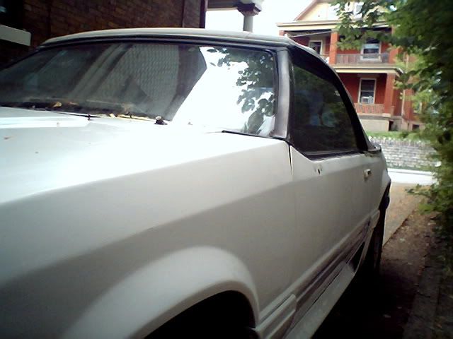

So I sanded all day. I've gotten I'm using 180 (!) on my worst spots. I guess that will present the challenge of scratch marks, but I'm not done painting. I have everything opaquely covered, except for a couple really small spots on the front bumper and the door rub moldings. Now my plan is to get it smooth, and then, I guess, to proceed with my top coats, while working my way up through the grits, all the way to at least 1500, and maybe 2000.
I will also add a little paint to my rub-throughs, and thin/transparent areas uncovered by this stage of sanding.

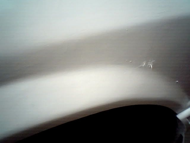

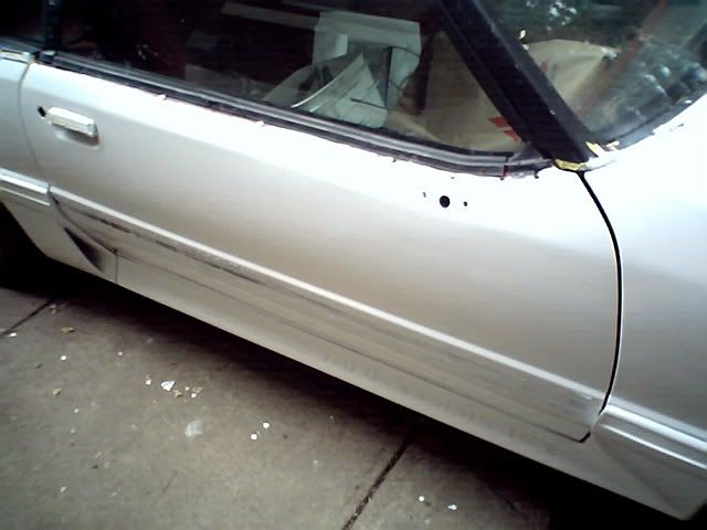

So yesterday I took a break, and didn't touch the car, but I picked up some 400 on the way to work. Today, I finished knocking down all of the brushstrokes and orange peel, hand-sanding with the 180, and then followed up with some 400 on a block, to attack the visible high spots. I need maybe a few more hours of sanding (on some of the urethane) before I put on more paint.
I kind of cheated, and hit all of my thin areas and rub-throughs with the rattlecan. So now that I have a decent 99% opaque base established, it's time to get serious about my paint application, as I hope to only do 2 or 3 more coats.

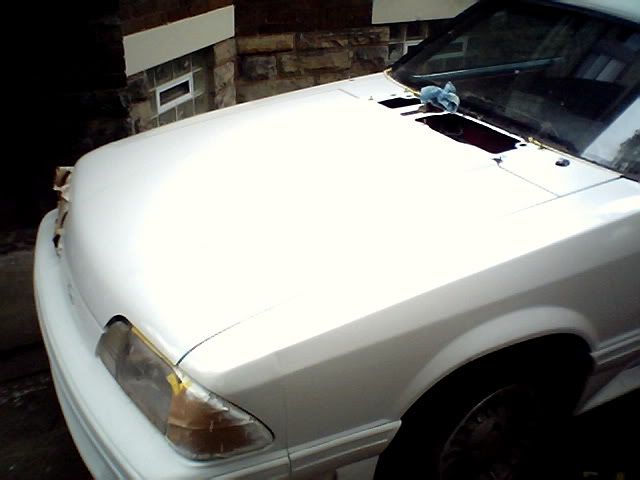

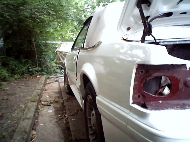

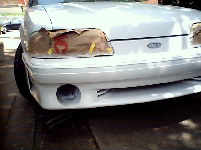

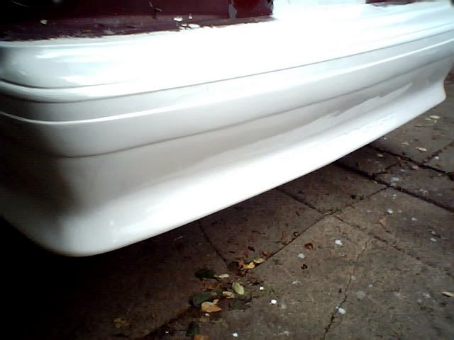

I spent the last several days sanding, and so today I threw on some more paint. Got two coats on the whole car except the front bumper cover, pics are after the first. I'm hoping to be able to not have to go any lower than 600 grit on this application, but we'll see.
My only real regret so far, is that I didn't loosen the tops of the ground effects, and on some of them, the seams are filled in with paint. A couple of them were like that when I got the car... I'll go back and address those areas later. I still haven't done my door jambs either.

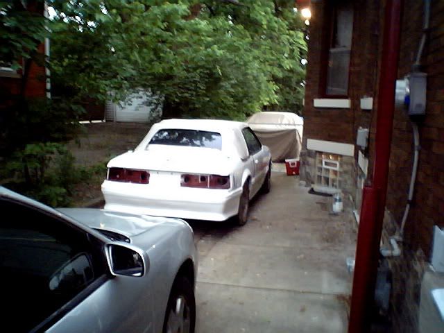

I also brought down one of my tail lights to see if it matched, and it doesn't. It was painted with the Valspar, and I'm using Rusto now. The Valspar is way darker. So I'll remask the lights, and probably just hit them with the rattlecan Rusto. I'll also paint my front bumper cover and door rub-moldings tomorrow.
