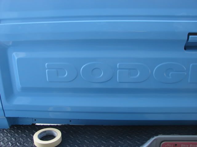

Here is one example of what youre talking about.
When I recently did my truck I went ahead and tried the tailgate with no sanding.
Not the best pic, and its not even been final sanded, buffed or anything.
This is 5 coats, with absolutly no sanding at all between coats.
Now on my truck I just did minimal sanding. It was outside so there always seemed to be a few bugs that got sanded out (ouch) (I did the tailgate in the garage) and honestly the sanding I did wasnt too bad. Probably less than 1 hour to completly wet sand and wipe down a full sized pickup.
I wasnt trying for a show finish by any means but I am really pleased with how it turned out

So you are saying that you think a person could get a professional result without sanding in between the coats? (even though that wasn't your aim on this truck)
It's great that you got a finish you are happy with on your truck. From the pic you posted looks like it turned out nice. Good work.
Probably not many of us here are looking for a "show finish" either, but I would like to be able to achieve a result that would look like a professional paint job.
Something where people driving in the next lane wouldn't be able to tell it wasn't stock or even most people getting into the car (without me having to point out the flaws myself) IE:"See, there's a little run here, and a blemish there"
I am assuming that there would be the exact same amount of prep before the coats of paint go on. Not even thinking for a moment that the prep could be scrimped on.
Just wondering how necessary all the sandings in between are. (And still achieve something that could pass for stock to the casual observer)

I think guys sand to minimize the orange peel and remove anything that may have gotten on the paint between coats.
If youre starting to get orange peel then sand so the next coats will lay down flatter
Now what causes the orange peel in the first place? Honestly in this situation there are a lot of variables. I think one big cause may be re-coating too soon. Could also be the weather, the mix % or some combination of all the variables.
Ive heard some guys will re-coat in 12 hours, I waited 24 hours between coats just because thats how my schedule worked out.
Honestly I thought it would be a one shot deal for me but I enjoyed the process a lot and I may do a little experimenting on something else.
Get each coat to lay down flat and keep the bugs off of it and there is no reason why a person couldnt lay down all the coats needed without any sanding.
I think for the final shine a good wetsanding/buffing would really set it off.
The guys/gals here that have put more effort into it get fantastic results; that rival any paint job Ive seen.
Ive got a couple un-biased opinions on mine and they comment that it compares to any of the "bargain" paint jobs out there that just lay on one color with no clear
Age : 52
