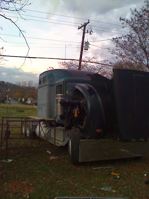

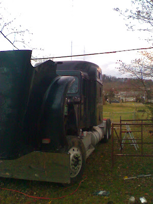

Hey folks, I'm borderline committing blasphemy here, since I've decided to spray my truck instead of rolling it, but I wanted to share my project since I've gotten so much good information here. I decided to spray vs roll since I make my living with this truck, and waiting around for 10-12 coats of rolled on paint to dry just really wasn't a good option for me, and I already had a compressor big enough to run a hvlp gun. At any rate, here's a before picture from far enough away that it looks pretty good.
I may try to find a closer picture later so you can see how bad the paint was.
So blasphemy #2 is that I'm also spraying with a two part urethane, not Rustoleum. I got it at a commercial/industrial paint place here in Knoxville, and it came to about $47/gallon, color matched. The name of the stuff is Carboline Multi-Gard 46. I actually asked them to mix it just a smidgen darker than the factory paint, and judging by the test sheet that gave me, they nailed what I was looking for.
I got started stripping stuff off on Sunday, but I've had some other business to attend to and it rained all day yesterday, so I'm just now finishing pulling everything off and getting the old paint scuffed. I'll try to take some pictures and update tomorrow, for now, the Rockford Files is starting..Happy Thanksgiving everyone!

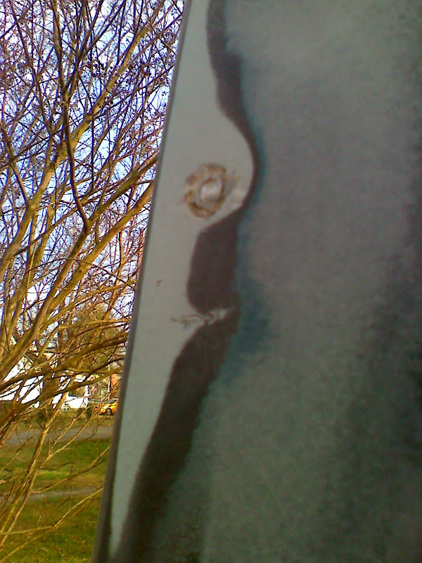

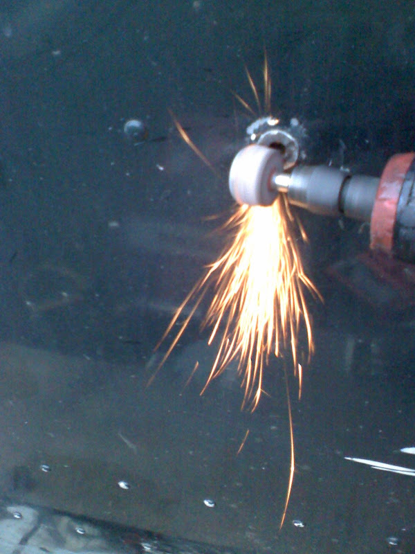

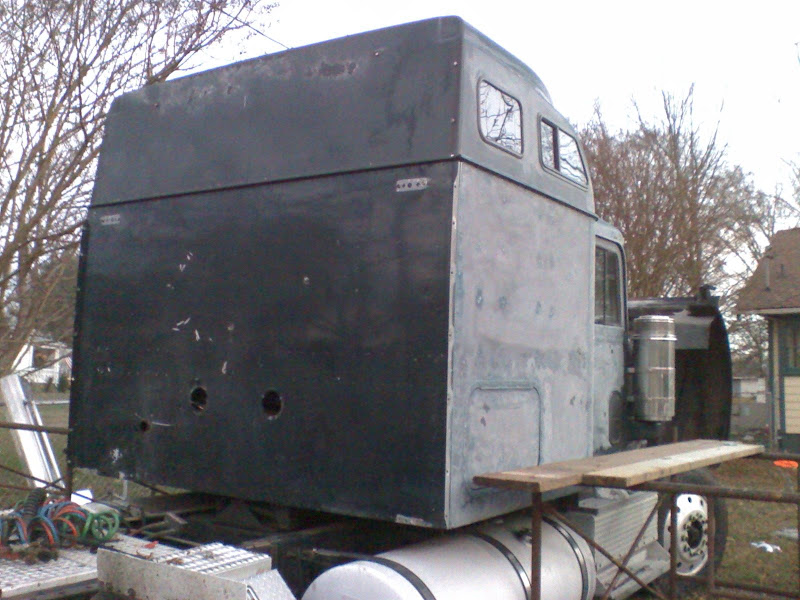

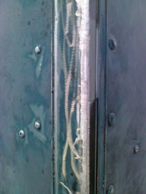

I got on here and wrote up a pretty long update last night-and I managed to erase it. The long and short of it is I spent most of the day yesterday working on tedious little stuff that's hard to see. I spent the better part of two hours cutting the headlight bucket out of the passenger side. It got damaged when I got backed into, so it had to be replaced. Then I started trying to take the bolts out of the back of the sleeper that used to hold in the aerodynamic sleeper extensions (or whatever they're called). Of course, most of them spun around in their fasteners, so I started grinding them down..
And here's the after, on a different bolt-
I'm posting this one again because it kind of shows how the clear coat's peeling off, at the top back of the sleeper. I'm also going to be cutting off the tabs with the holes in them you can see on the back of the sleeper. They're also on there to hold the sleeper extensions, I'm never going to put them back on since I pull a flatbed, and I'd like to get those corners rounded off, I think it'll look better.
I'll also be filling in the small hole on the driver's side, it's where the trailer light pigtail used to plug in, I've got a guy coming out tomorrow to weld up a box to put on the frame that it and the air lines will be plugging into.

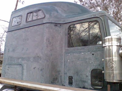

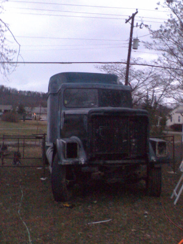

Here's old Oscar at the end of the day yesterday, looking pretty mean I think-

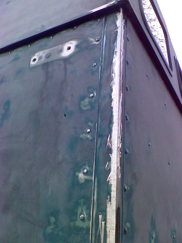

Here's the corner, mostly ground down at this point-
Here's a little closer picture of the corner-
I'm going to bondo from the seam on the left to the second seam on the right, and try to round the corner off as much as I can so that it matches the corner on the sleeper. Mike pointed out that the curve is about the same size and shape as the corner of a milk jug, so we're going to try to use it to sand the bondo to shape. We'll see how that goes.
