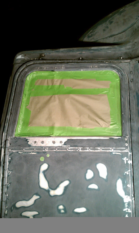

Well, I'm not going to make any big predictions, but it looks like I might actually start painting tomorrow-if the rain holds off. I've gotten a little bit too much of a perfectionist streak in me on this body filler. The plus side of that is I think I'm getting halfway decent at it. I've got a couple of places that I'm going to run a filler glaze over tomorrow, then it's time to knock the dust off and spray some primer. I've got all the detail masking done, I've just got to throw something over the frame in the back and the engine and radiator.

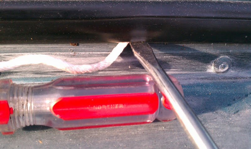

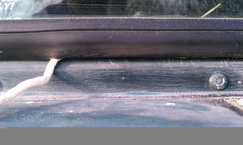

I read a trick somewhere (it may have been here) about sticking a nylon cord behind the window seals so there wouldn't be the paint line you'd get where the seal meets the body. Here's a couple of pics of that.
And here's a masked up window, just to make it look like I've actually been doing something-

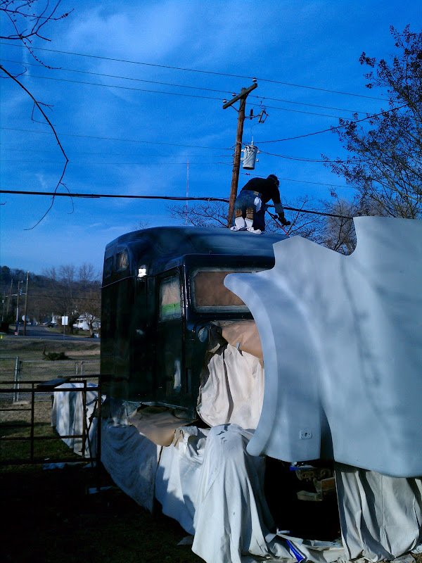

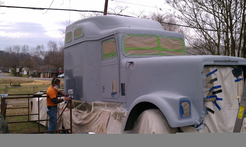

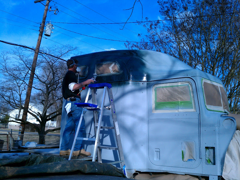

Well, the weather cooperated long enough this week to finish with the body filler and glaze, and then finally get the primer on yesterday. I've kind of been pulling my hair out a little bit, I really didn't want to be out of work for this long, and even if I get it finished this week, I'm going to be coming up pretty hard against Christmas. That work I talked about getting moved back to the middle of the month has cancelled altogether now, so I don't have anything pressing that I've committed to, but I'd also like to make some dagum money..So my options are to either wait this cold weather out until it's warm enough to paint, which will probably be towards the end of the week, take the truck to someone and have it painted inside, or put it back together and work it for a while. As much time as I have invested in it, I really don't want to pay someone else at this point, because even if I got it to someone tomorrow, it would probably still be the following Monday before I got back on the road. I also really don't like the idea of putting it back together and then having to take it back apart at some point, especially just to get a week or so worth of work in. So I'm leaning towards waiting it out and getting it finished now and just hitting the road hard after New Years.
Sorry for the rambling..I wish that I had been keeping track of how many hours I've spent on this thing, after I got the body filler looking good, I went back over everything with 3M body filler glaze, which is just a really thin and fine filler-and expensive, it was about $30 for a pint sized bottle and the hardener. It's really good stuff though, but I guess it doggone well better be at that price. I worked until well after dark Wednesday and Thursday nights getting this stuff feathered in, and after midnight Friday getting finished so I could (finally, finally, finally) start spraying yesterday. So here are some pics I can finally be a little proud of-

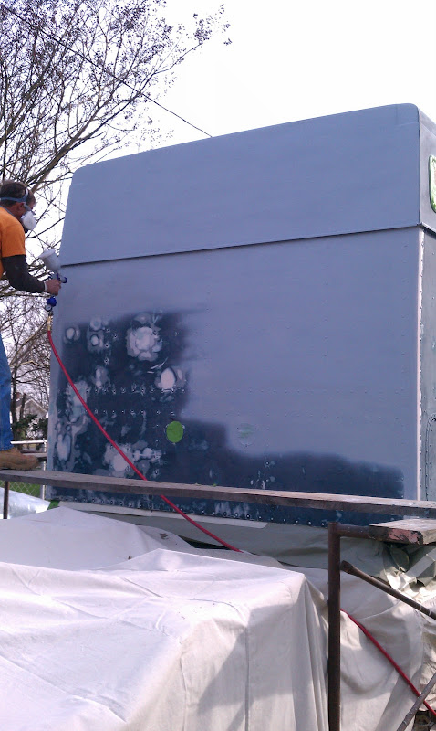

That's Mike doing the spraying, I didn't get any pictures after the first coat because I made a mess out of myself mixing the primer and I didn't want to touch anything. I did get this terrible picture after I got cleaned up, after dark obviously-
Those lines are shadows, it really looks great. There were only two runs on the whole thing, a small one on the driver's headlight bucket, and one on the front of the hood that will be covered by a piece of trim anyway. I guess I'm going to brave the cold at some point and hit it with a rattle can of guidecoat and try to do a little block sanding. I've promised myself I'm not going to get too picky and get myself into even more work. We'll see how that goes.

If you are going to use rattlecan paint for a guide coat, be prepared for a little time for the paint to dry. It will need two days (or more at colder temps) before you can sand it. If you don't wait, it will just clog you sandpaper.
Flat black may be a better bet.

It is a rattle can, but it's some stuff that's supposed to be compatible with the primer and dry pretty fast. I was planning on just kind of misting it. Thanks for the heads up, I'll probably spray it on my test piece and see how fast it dries. I'm not going to mess with it if it's going to delay me anymore. I blocked. It down pretty good before the primer with the glaze. Since the body panels are so big and aluminum, they change shape a little when the truck changes temperatures, so getting to ridiculous with it probably won't be worth it.

Can you elaborate on the cord on the seals? Im starting a 71 beetle and the seals all had paint on them when the last guy destroyed this thing with a rattle can. I've been concerned about covering the seals.
joshc (December 3rd 2010, 10:02 pm) wrote:Well, I'm not going to make any big predictions, but it looks like I might actually start painting tomorrow-if the rain holds off. I've gotten a little bit too much of a perfectionist streak in me on this body filler. The plus side of that is I think I'm getting halfway decent at it. I've got a couple of places that I'm going to run a filler glaze over tomorrow, then it's time to knock the dust off and spray some primer. I've got all the detail masking done, I've just got to throw something over the frame in the back and the engine and radiator.
Sure, you just take some braided nylon, maybe 1/4" or so, and use a screwdriver to pry the top of the seal away from the body, moving around the seal and forcing the cord behind the seal as you go. This pushes the seal out from the body so you can tape from the backside of the seal around to the front. The string also keeps the seal off the body, so you can paint behind where the seal will lay, so you don't have a paint line. I don't know how you would go about getting the old paint off the seals though, it might be a good time to go ahead and replace them, and just paint the car with them out. It's probably about time with a 40 year old car anyway.

Post by Lawrnk on December 20th 2010, 1:32 am
joshc wrote:
The 1/4 inch was way too big on mine, but I get the idea. I think these seals are fairly new, good shape. I'm going to try this, maybe mason string would work for these.

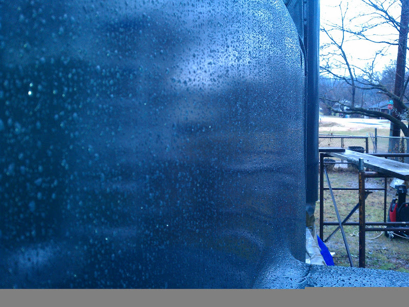

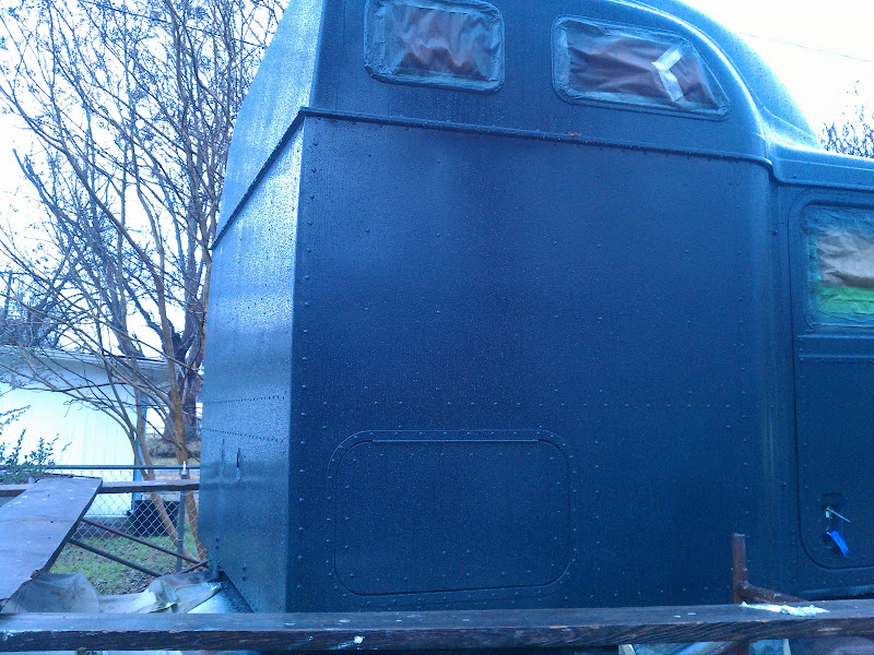

Post by joshc on January 1st 2011, 10:47 pm

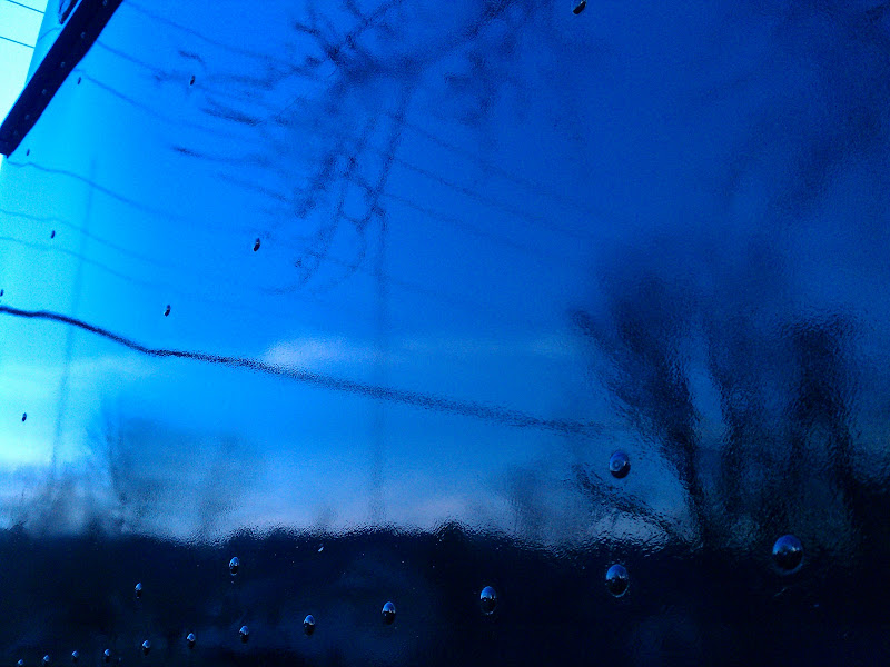

Sorry I've been so long updating folks-busy week, birthday's, a wedding, New Year's eve-and painting! I was starting to think I'd never get to it. The weather finally cooperated yesterday, and we got two coats on. I don't know if I messed up the needle, or if my gun was never right, but we couldn't get it to stop splattering paint. So, in a moment of desperation, I got out the touch-up gun that came with the kit from Harbor Freight. I turned the air volume knob wide-open, and it actually put out a pretty good sized pattern. I had intended on going to the store and getting another regular HVLP gun but the touch up gun worked well enough that we stuck with it. It has a tiny cup on it, so it needed to be refilled a lot, which was irritating, but it worked. The cup also won't accept the little disposable cup filters, so we filtered the paint with a cotton handkerchief, which was also time consuming. I'm pretty pleased with the way it came out, there's some fine orange peel in places, and a two runs, but it's really not bad. I got a lot of paint on my hands doing the straining, so I didn't get to take many progress shots, and it was dark by the time we finished. It rained all day today, so I might be able to get some better pictures tomorrow. So enough of this, here's the pictures.
I was trying to get a picture of the runs in the first coat, but all I really got was about the worst of the orange peel. It did level out a little as it cured, and the second coat went on better.
Like I said, it rained all day today but here's a couple of rainy pictures-
I'm really kind of surprised how well the bondo work on the corners of the sleeper came out. It's not perfect, but it's good enough.
I'm contemplating putting another coat on it tomorrow afternoon, it's supposed to warm up enough to do it. I'm going to wait until I can see it dry to decide. It's definitely going to need some work to get it buffed out, but I'm tickled to finally have it in paint. I'm beyond ready to get this thing back together and back on the road.

Post by Tommy Hillbilly on January 3rd 2011, 1:00 am
That's a lot of surface area! Gotta love the way water beads on fresh paint.
Didn't you say you were going with the same color? The pics make it look more teal-ish.
