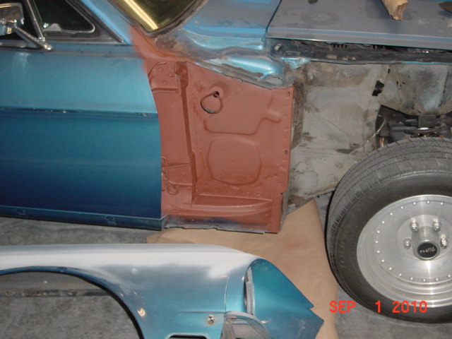

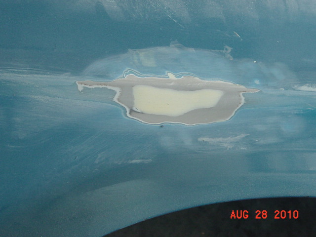

Post by rmdhokie on December 19th 2010, 8:06 pm
more body work pics:
Molding holes on the fenders. I'm not a welder so I used stuff called "liquid metal" to fill the holes and covered that with normal body filler. I countersunk the holes for more grab and put metal screen behind each hole. I used Rusto expoxy primer on bare metal surfaces and then Rusto Auto Primer.

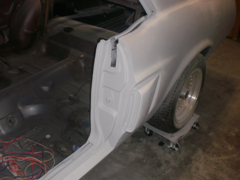

Post by rmdhokie on December 20th 2010, 5:58 am
final body pics before Primer/Surfacer coat:
Holes in hood are for bolt-on hood scoop (68 1/2 Cobra Jet style)
Rear glass frame cleaned up
More dings and dents fixed
Trunk area cleaned up (Rusty metal primer and Rusto semi-gloss black)
Ready for primer/surfacer. At this stage car sanded smooth using 220 grit
Primer/surfacer was rolled on. Jams and other hard to reach areas sprayed with filler primer.
Added 68 california special side scoops. Making any fiberglass parts fit takes alot of work.
Lots of blocking sanding to do. Trunk panel is done; it will be my test panel for Rusto Gloss White with MS and Penetrol.

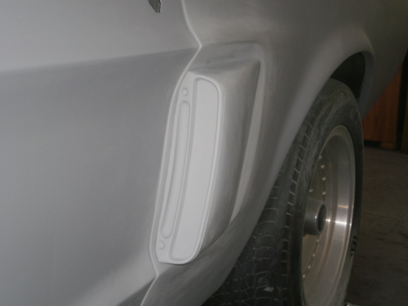

Post by rmdhokie on December 21st 2010, 6:23 am
Another look at the side scoops.
