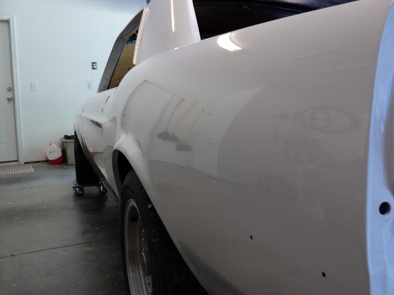

Here's some pics of coat #6 wetsanded with 800grit. For the most part, sanded pretty flat. There's still some shiny spots for sure...as a result of orange peel. I'm guessing about about 85-90% flat. Most shiny spots are near the edges of panels and body lines. I've learned the hard way (burning thru to primer) wetsanding edges. Evil or Very Mad But still happy with it. For me, wetsanding is the worst part of the process. Time wise: it took me about 8 hours to wetsand the entire car.

Looks good, how many more coats before you can buff?
Re: 68 Mustang Coupe
Post by rmdhokie on May 9th 2011, 6:31 am
I was planning on 10 coats, but 8 coats may be it.

I was wondering about this too. With my Stang, I'm still getting the splotchyness of not-enough-coverage after three coats - even on my decklid which was gray primer. If yours is like mine, I think I'd recommend the two more coats just for insurance. I'd do another coat, and hit it with some 1000 grit, and then do one more and hit it with 1500 or 2000, before buffing. But then again, I'm a lazyass, so I might just step up the grit, and buff it from here (8th coat)
You for sure want to look at it under some good light, too make sure that the new paint is all totally opaque.

The time spent sanding is of course the trade off for spending the $$$$ to have a pro do it.
It is looking real good tho and the "new shoes" will compliment it also.

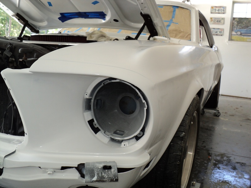

Coat #7 finished. Wifey says it starting to look like a painted car. Laughing

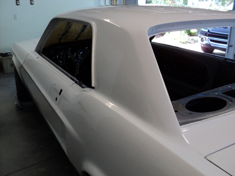

Reflection from the roof

Post by 63Falconconvert on May 15th 2011, 8:37 pm
looks good enough to start driving thumbs up

rmdhokie wrote:Coat #7 finished. Wifey says it starting to look like a painted car. Laughing
That really looks great! Are you still doing the stripes?
It looks like you are working with flourescent lights. Just be aware that those lights will show every little flaw. A lot of flaws you can see in your garage will disapear when you pull the car outside - particularly with white. I spent a lot of time fussing with stuff on my car that no one else sees unless they come into my garage.
