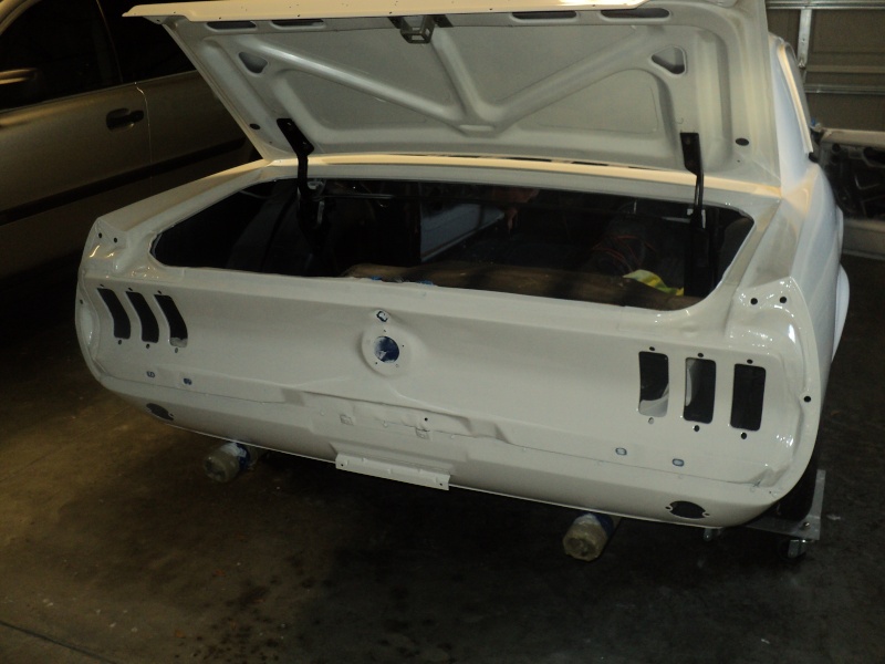

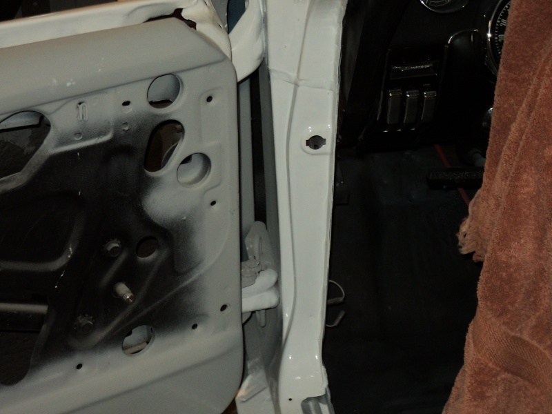

What can I say...progress is slow...life happens. Got the first phase of wetsanding done (not looking forward to the next) after two coats. 3rd coat is done. Still plenty of shadows but coverage is getting better. I'm trying to finish up the door and hood jams...all with foam brush...so I can focus on the exterior. Here's some pics:

Looks fantastic!!! The door jams look like you sprayed them.

Coat #8 on trunk, coat #4 everywhere else. Two quarts of paint used so far. Finished the door jams etc, so I can now focus on the exterior. I also wetsanded again between #3 and #4...just a light rubbing with 800 grit to knock down any nibbs and dust in the paint. I wetsanded the whole car in 2 hours. I continue to be encouraged with Rusto Topside Marine paint...very glossy out the can and orange peel is minimal. It's warmed up quite a bit since I started and noticed that I need to move a little quicker to keep a wet edge. Thought about adjusting the mixture, but don't want to screw with a good thing. Here's a couple of pics.
