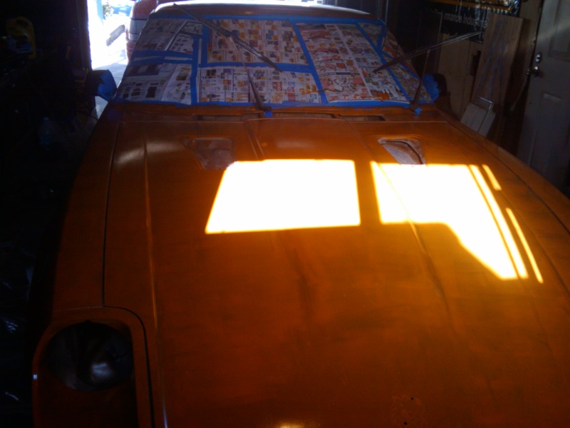

What it looks like after the first coat:
Even though I went back through with the 400 grit + sanding block there are still some marks from the DA sander visible through this first coat. I didn't notice these on the first car I did so I'm wondering if anyone knows if they'll disappear with more coats + wet sanding??

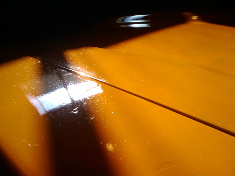

Tried to get a good pic of the DA swirl:
Any insight would be excellent - thanks! Oh and the car looks alot more orange than it really is. Still lots of brown in it.

Those DA marks will disappear after a LOT of work and several coats. This is one of those times where a good primer coat would save you much effort over just rolling paint. Prep work is 90% of a paint job. I got out of the bodywork business back in the late 80s and though the materials and pricing have all changed, prep work has not.
Not trying to be a wet blanket, but you'd be so much farther ahead if you sand it back down where the DA marks are and add some primer before rolling more paint.

More coats will not get rid of the DA sander marks, If its only in a few small areas, wet sand those down with 400 using a block of coarse, and then primer and wet sand with 400 again, mist coat your primer with flat black it will help you see any imperfections.
If its on most of the car, I would dry sand with 220 then cover with 2k primer and then wet sand that with 400

Primer is thicker than paint. It is designed to fill those swirls. If you simply prime over that fresh paint, the paint will "outgas" and lift the primer and subsequent paint coats off the surface.

That primer coat eliminated my sanding marks too. This pic was taken pretty soon after painting so there are still some bubbles and other crap that needs to be wet-sanded out:
