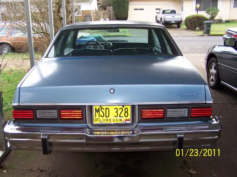

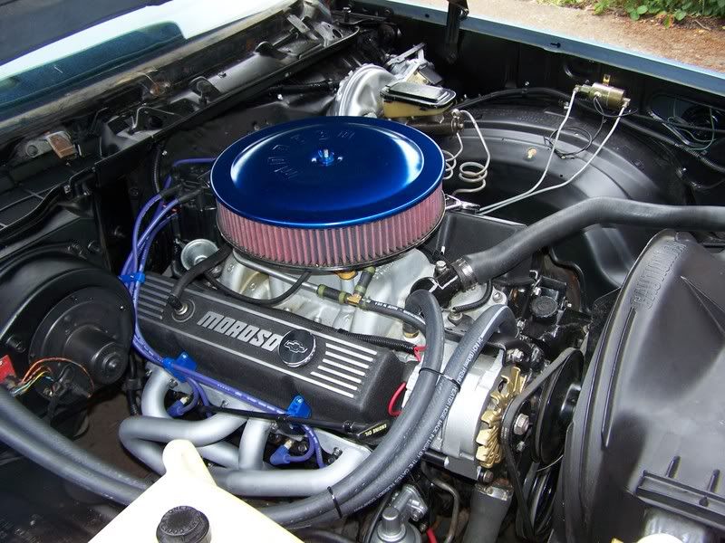

I decided to start a thread for the body work and paint on my '80 Malibu. The car got a cheap paint job at Maaco about 10 years ago that is now faded and the body has some rust issues at the corners of the rear glass. Here's a the before pics and a few of the engine and stuff.

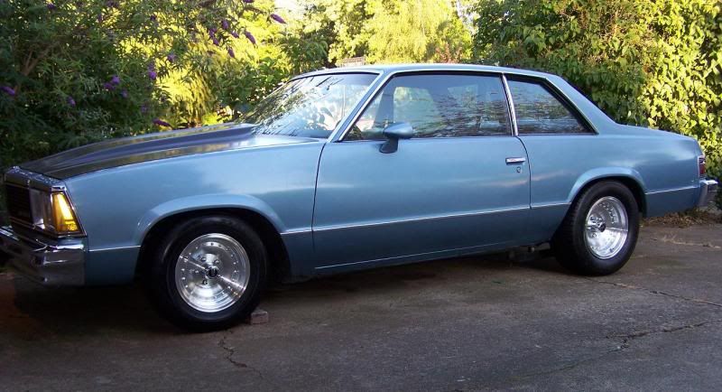

Here's a few pics of what I got accomplished in the past few months. I still hava a long way to go. The rusted area along wheel arch has been cut out and a new patch has been welded in. All the small dings and dents along the body line have been repaired. Still have the areas behind rear glass to repair. This is a tough area to work and I'll need to remove windows that are sealed in place with butyl tape. I've ordered new felt strips. If you have any suggestions, please feel free to comment!

great start! car looks to be in great shape.

Nice. Is that an original manual transmission car?
Re: 1980 Chevy Malibu blue
Post by loneagle on January 24th 2011, 11:24 am
Thanks. guys! Very Happy
Tommy Hillbilly wrote:Nice. Is that an original manual transmission car?
Yes, it originally had a 229 V-6 with a 3 speed Saginaw.

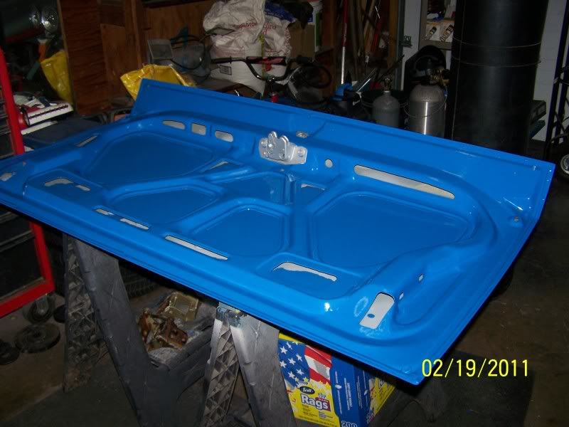

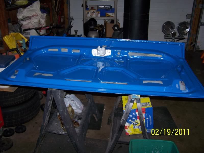

I kinda like the black hood, I have a black Harwood I run on my '70 Nova. The factory put flat black hoods on muscle cars long before "Fast & the Furious".
I agree the stripes would look the best though. I've been looking for a stencil kit but can only find em for the earlier Chevelles. I may have to lay the stripes out myself. Not a big deal, I just get kinda lazy sometimes.
Got some work done on the car. The trunk was prepped and painted and the door jambs and edges of the hood are done. I've been using a hardener in my paint. It rolls out just fine and doesn't seem to affect the drying time at all.

Looks great, like the color. Did you use a foam brush to get into tight areas?
Post by loneagle on February 21st 2011, 11:24 pm
Thank you! I think its gonna look real nice.
Yes, a foam brush and a 2" roller. I also tried a regular 1" paint brush and it worked real nice too. Natural hair is supposed to be the best for oil base paints. I looked all over but could only find synthetic brushes.
