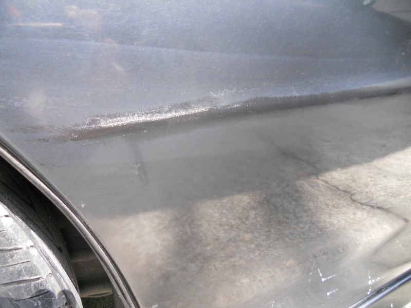

rju12 wrote:
I've seen this before when wetsanding rattle-can paint, and I'm not sure what it is. I think you are seeing a few different coats/layers/strata there. I would want to hit that area with more paint also.

Post by rju12 on February 28th 2011, 8:28 am
Ahhh good news when i was messing around with that spot before I painted it I tried sanding that fender with 1000 grit and it did the trick! you can still see it kinda on the left side but you can also see how it is fading. Was such a relief to know i could just continue sanding and will be able to lay down my final coats soon.

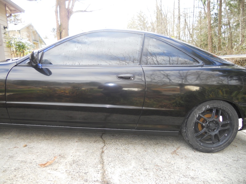

Post by rju12 on March 2nd 2011, 8:03 pm
I have some update pictures. All is going well except I got a few drips on my last 3 coats. Anyways i'm just on the final stages now of wetsanding with 1500 and 2000 before i use a rubbing then polishing compound.

Thinking about it some more, did you maybe start wetsanding that area before it had dried enough?

"Thinking about it some more, did you maybe start wetsanding that area before it had dried enough?" Well I gave it like 10-12 hours to dry just as all the other coats. I'm not sure what happened but I think I just went through my thin coats. I'll have to take some pictures of that spot in the light when im done because I think it has disappeared.

Post by rju12 on March 10th 2011, 4:16 pm
So here are the final pics a few of the end are of spots I screwed up. I fixed two of them and I made one of them worse and just added paint over it....This one I went through in a few spots in the center but in fixed nice. Just added a few layers of paint then sanded and buffed.Here I also went through.You can see the bottom where i didn't sand enough and there was a spot on the right where it is just not a smooth texture. This last one is where it got real messed up. I went through one little part on the edge and I only put two layers on 1 across the part and 1 right where i messed it up. I should have done more because after I sanded it it looked fine but once i started buffing it i went through like 3 parts on the edge.
