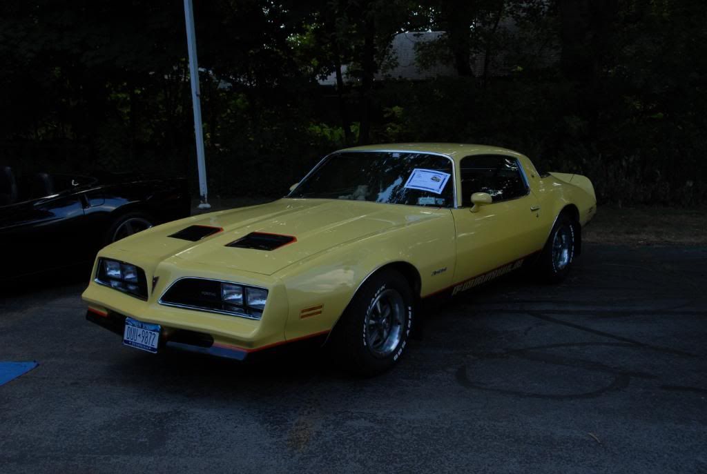

Post by stang_krazy on August 19th 2011, 12:14 pm
Great job on the falcon, you've really done a nice job on making your own panels to the finsh on the welding. You and T's body work with all the pics will help me greatly when time comes for me to get a 77-81 trans-am.
I was thinking about trying to save up to have the body work done but with what I sell and you guys and a buddy that does restores on classic cars and body work in general I think I would fell so much better at knowing that I did the work myself.
this pic did jump out at me. LOL
