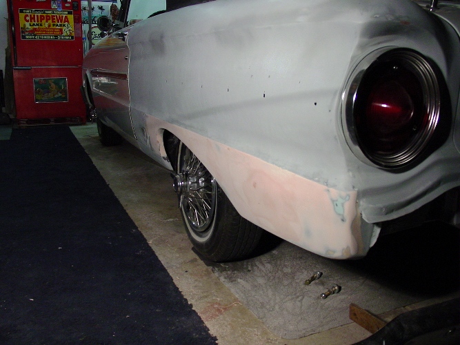

Some updates....the driverside lower quarter has really been fighting me. I can't get the lower body line as straight as I would like it.
Here are a few pics to what I ended up doing:
First is drawing a long pencil line right on the body line.
[img]
next sorry no picture is running a piece of tape from one end of the quarter to the other on the top half of the body line.
Next lay a thin coat of polyester putty and while it's still wet pull off the tape. This gives you a nice straight hard line. Block with 80 grit using a long board and that did the trick:
Next was to lay a heavy coat of primer, let dry, dust with cheap black primer as a guide coat and block with 220 grit on a long board:

I's stealing this idea. I welded the front half the quarter on the seem and it messed up the body line a bit.
Your car is looking good, wish mine was that straight. The lines are looking good and once the trim is in place, any little imperfections shouldn't be noticeable.
