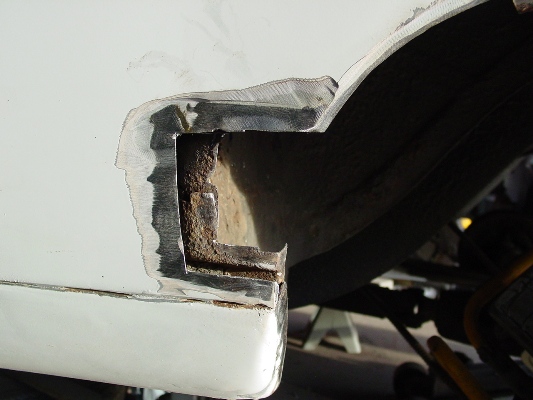

Post by 63Falconconvert on May 19th 2011, 10:26 pm
Driver side inner fender repair

Post by rmdhokie on May 20th 2011, 6:26 am
Really nice work!

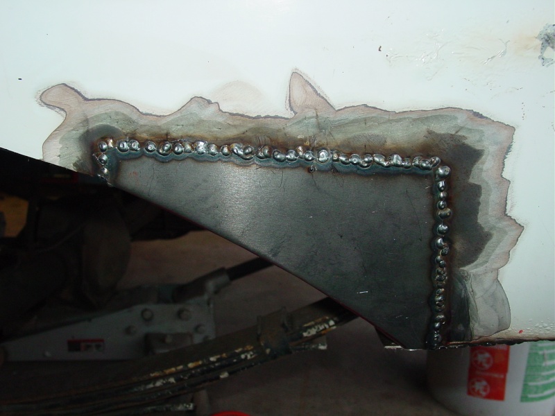

Post by 63Falconconvert on May 24th 2011, 7:19 am
More welding..... weld
underside of rear quarter
just have to grind the welds now.

Post by dean_af on May 24th 2011, 10:23 pm
Great work. I'm working on my 61' Falcon. I have been using some of your pics as a reference. I have a LOT of rust on the driver's side. I currently have all the metal off from door to tail light from the trim line down.

Post by T.Hadley on May 27th 2011, 12:37 am
lookin good, dont ya just love welding up side down...

Post by 63Falconconvert on May 27th 2011, 5:41 am
T.Hadley wrote:lookin good, dont ya just love welding up side down...
My neck will never be the same...lol I think I'm none welding underneth, I have to fab the entire lip for the driver side then that should be it. We are leaving for a 4 day camping trip today so no progress this weekend. Crying or Very sad

Post by dean_af on May 27th 2011, 7:59 pm
I just noticed how thick the Bondo is. affraid My fenders and quarters were even worse. I had pieces as thick as two inches. It would have been cheaper for the guy that owned mine to buy new metal rather than the gallons of Bondo he used.

Post by dean_af on May 31st 2011, 7:50 am
What are you using to grind down your welds? I'm using a grinder with a flap wheel but find it aggressive and hard not to grind good metal.
Re: 1963 Ford Falcon
Post by 63Falconconvert on May 31st 2011, 9:57 am
I first use a hard wheel to knock down the welds using very light presure on the grinder then a 60 grit flap wheel to blend.
Post by dean_af on May 31st 2011, 9:59 am
63Falconconvert wrote:I first use a hard wheel to knock down the welds using very light presure on the grinder then a 60 grit flap wheel to blend.
I will try that today. It could be I'm too aggressive and put too much pressure.
thanks
Post by 63Falconconvert on May 31st 2011, 10:05 am
flap wheels will remove metal in a hurry if you really lean on them. Try an 80 or 120 grit too

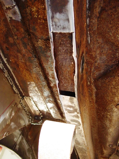

Was able to get some welding done last night. I pulled the rear shackles to change out the bushings and patch a soft spot on the frame.
