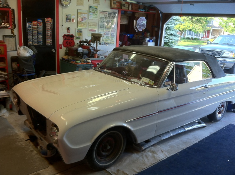

Post by 63Falconconvert on July 2nd 2012, 8:35 am
Almost there. Have to drop in the radiator and mount the new trans cooler, polish the tube grill I made and get the trunk lid on.
Here are a few pics from the weekend.
