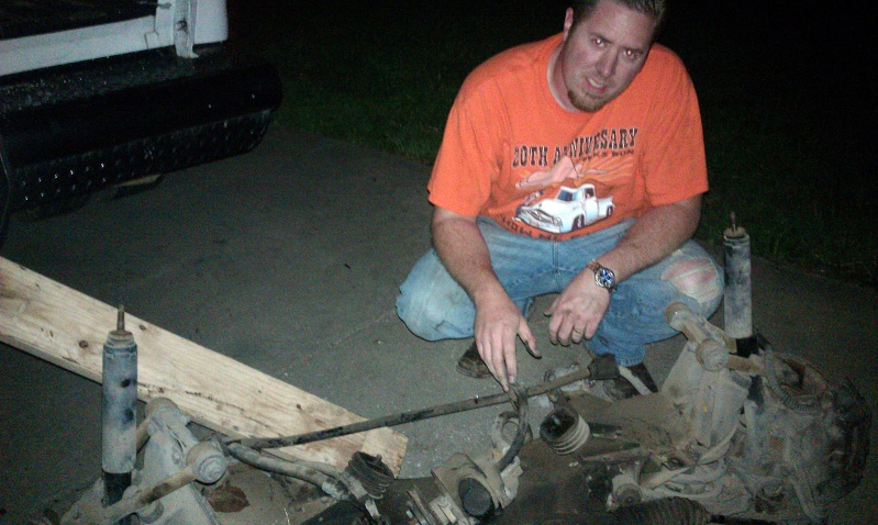

Post by scr8pin_f100 on May 16th 2011, 11:41 am
Well, I decided that I would not be doing this "low budget build" justice, unless I "clipped" it..So, after much research, I have decided to use a Jag. front suspension clip...As you can see, the suspension is self sustaining within its own crossmember..I will need to notch and weld into existing frame..I still want to be driving this truck before summers end so, I HAVE to KICK butt to get this in..All of this, AND working 2 jobs...ugh...
Anyways, thought you all might like to see some progress!

I don't know how much wider the 68up fords are but I understand the newer crown vics also have a stand alone front end and fit almost perfectly under them and they are susposed to be cheap also. You might check them out at the ford-trucks.com forum. They also have a wealth of info for any ford truck dating back to the 40s.

The 68 & up Fords are pretty similar in tread width, but a couple of things about the crown vic front end that discouraged me (I have done a lot of research, on that site, as well as others) First off, due to the size of brake rotors (larger 11"), require 16" wheels..Also, the tread width is a little wider than the older pickups, so they require a positive offset wheel..And lastly, around here, I was not able to find one cheaper than $400...And that last one was the biggest deterrent for me...let's face it, money talks! Isn't that why we are all here, for a cheaper option for a paint job? (save money??)
because
But, not knocking the swap, I would have done it, and they ALL have their pros and cons!
