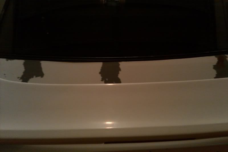

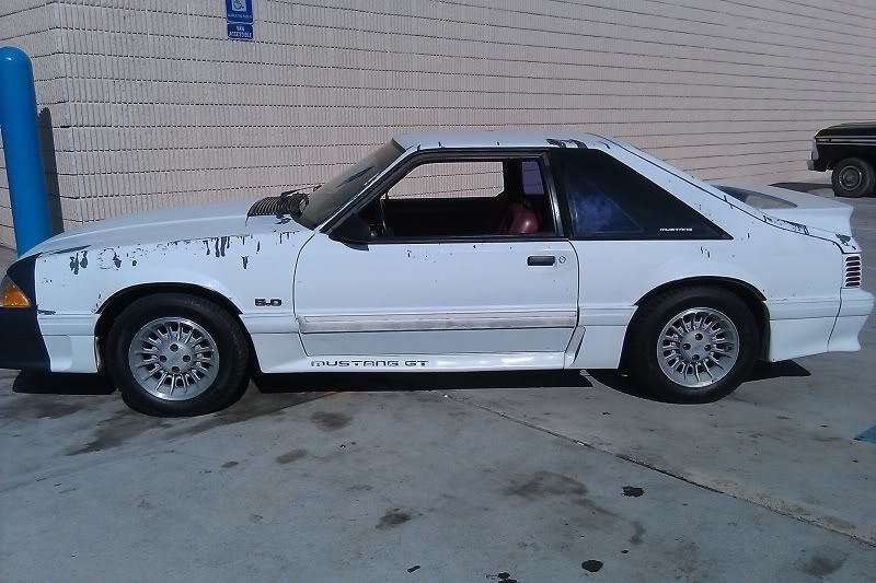

just getting this started I will keep updated as much as possible.
Here is what I am starting with
Bad paint peel on the fenders and rear hatch
here is what i got so far:
Drivers side fender self etching primer
Driver side fender with one coat of Rustoleum clean metal primer
the peel on the drivers side is not as bad as on the passenger side but is still showing through might have to do more sanding to level it out

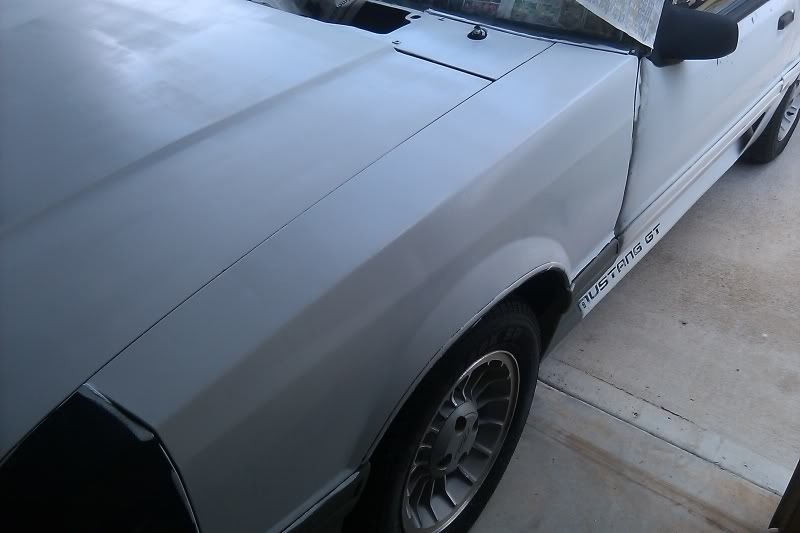

Well Finally got some sanding time in today YAY! Palm sanded 85% of the drivers side took some surface rust spots down to bare metal and spray primed those didnt take any pics of that.
I sanded down the drivers side fender and the hood with a foam block 220 was planning on taking it down to primer because of the areas that were showing factory primer didnt seem to be filling in but to my surprise as i was sanding they filled in nicely hope to get another coat on her tomorrow.

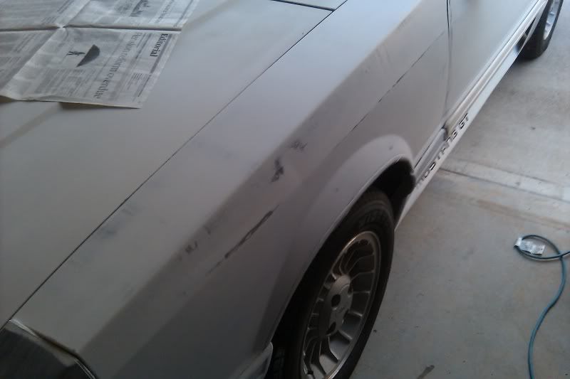

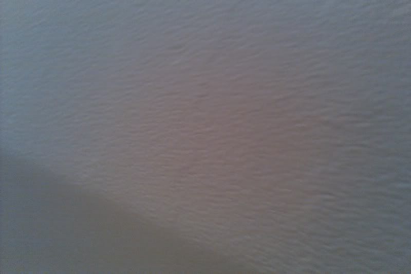

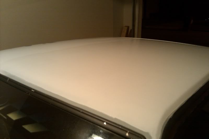

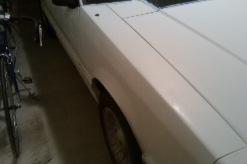

Well got a few hours time last night put on some primer got alot put on actually.
Drivers side fender
Hood
passenger side
passenger side where it was peeling
half the roof section on drivers side
drivers side of the hatch
it was late so I didnt tape the clean metal primer is really easy to blend
Hope to get the car in all primer today and start sanding after that

not very much progress this past week still working on the front of the mustang hood is ready to paint but the orange peel that is on the fenders is prooving to be a task should have thinned the primer i think.
I can get most of the fenders smooth but the orange peel just above and just below the body line just wont go away

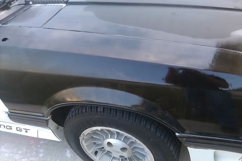

Post by stang87gt on May 24th 2011, 12:37 am
well finally started painting was gonna test on the rear wing did one coat on it layed down flawless with no roller marks.
But after that realized i had more paint than would fit back into the container so i did the hood, front bumper and both fenders before it would all fit back in the container again layed down flawless but alot of roller marks on the hood my guess is that i cannot make full length passes.
anyhoo I will post pics in the morn
Mix was 2:1 with ms and 1,000,000,000,000 degrees outside (actually around 95 and 80-85% humidity)

Post by stang87gt on May 24th 2011, 8:38 am
not bad, I learned that as soon as the sun goes down bugs, and stuff off plants attack the paint I will be moving it into the garage tonight to finish
stang87gt
Number of posts : 41
Project : 1987 Mustang Gt
Registration date : 2011-05-09
Re: 87 mustang gt
Post by stang87gt on May 24th 2011, 5:41 pm
well checked it out after work today and see the dew in the center of the hood that made it op real bad and dull gonna sand it down before coat #2

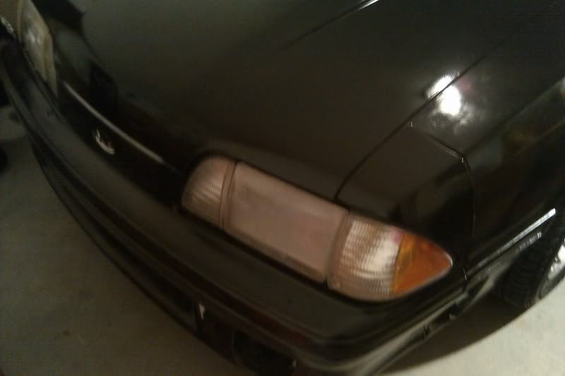

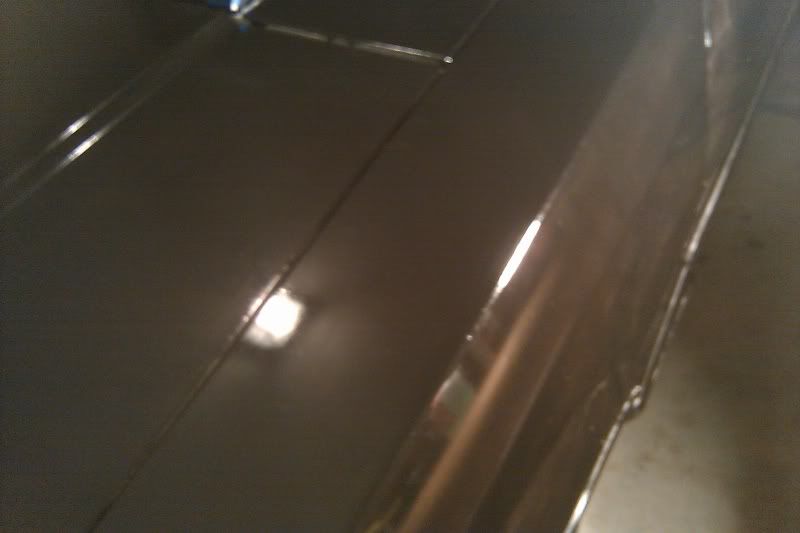

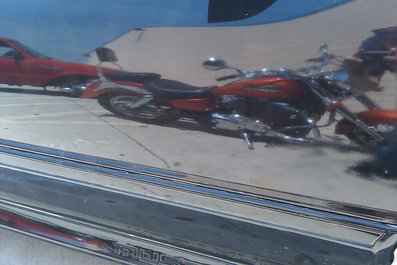

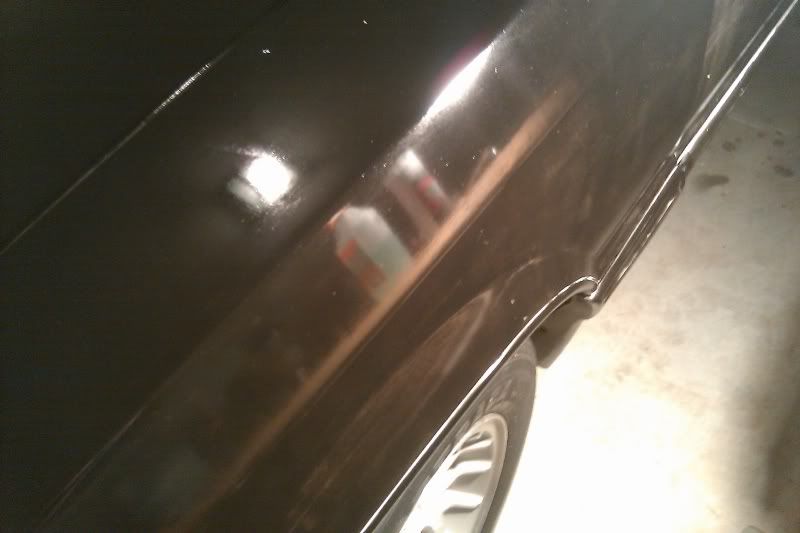

Post by stang87gt on May 24th 2011, 10:23 pm
Coat number 2 on the front fenders and hood
close up of the hood
drivers side head light
reflection in drivers side fender

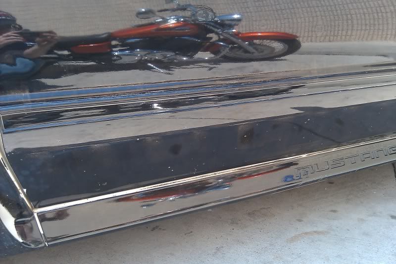

Post by stang87gt on May 25th 2011, 1:20 pm
Passenger side door one coat

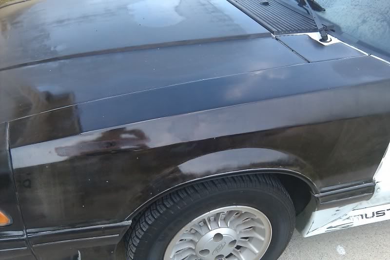

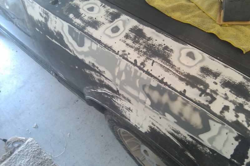

Post by stang87gt on May 28th 2011, 12:30 pm

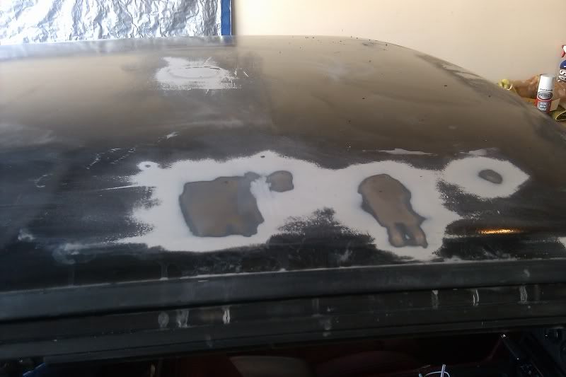

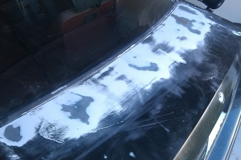

started sanding some body work needed to still be done when i got the black put down on the car you could see what the white primer/factory paint hid it was mainly the run area's so working on getting those right
Passenger side fender needed a lot of work could see everything so it is getting sanded and feathered better this time
Roof section
Rear hatch
