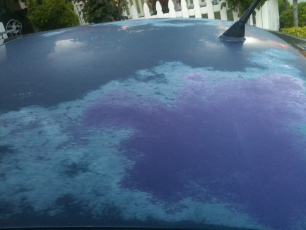

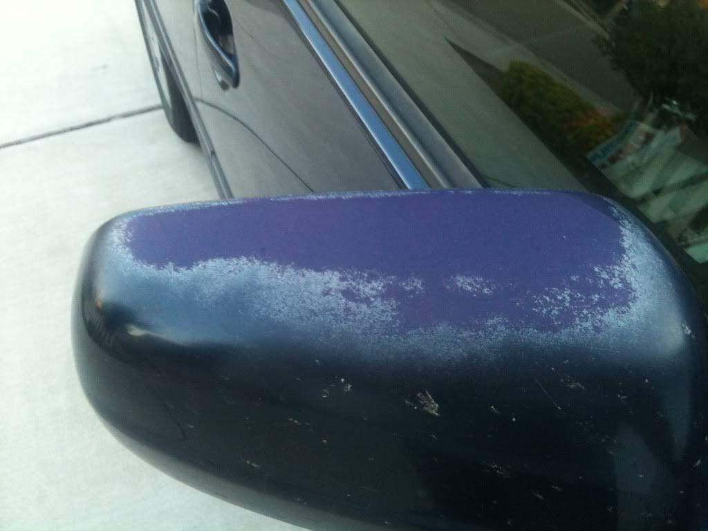

This is a car I bought 2 years ago as a commuter car, and have put 60k+ on it since then. 140k+ on it at the moment. Various issues with the car (fuel pump, various sensors, cat, fuel sending unit...). And, in the past 2 years the paint has gone to pot. This is a car I didn't want to put any money into until I could buy something newer. I just paid $800 for various repairs, and vowed no more! Then I hit a tire on the highway, which busted my headlight, left my bumper hanging on, and tore the under engine guard clean off. Can't afford another car. Another $300 in parts. So, I decided if I'm driving this one for a while, I might as well like how it looks.

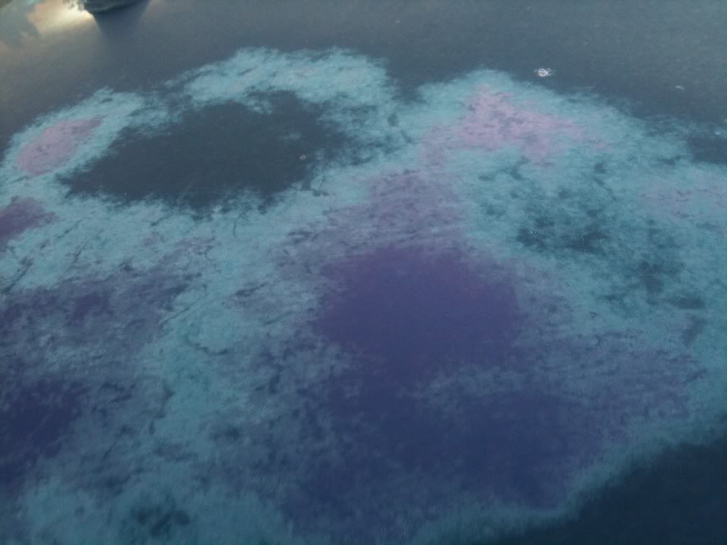

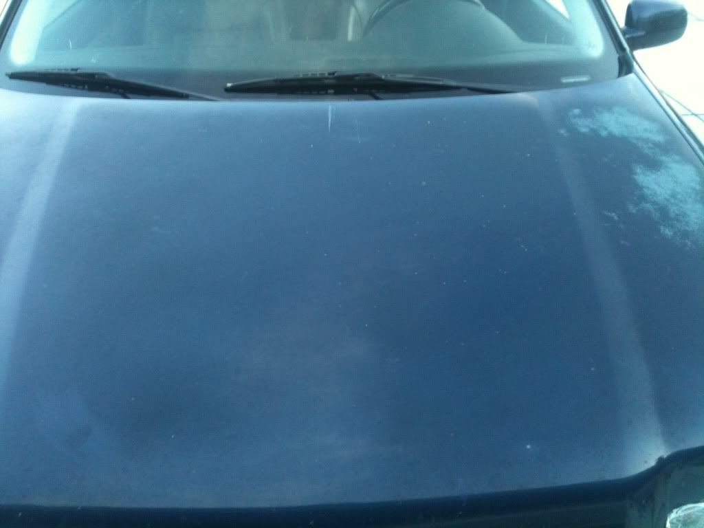

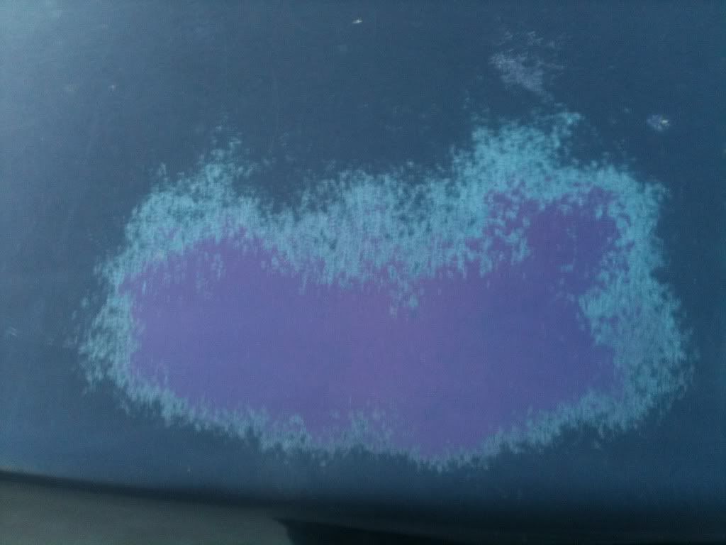

Here's the before pictures of the paint damage:
After reading through the forums, I decided on the Ace Rust Stop paint as I could choose a color. I followed the directions here and elsewhere.

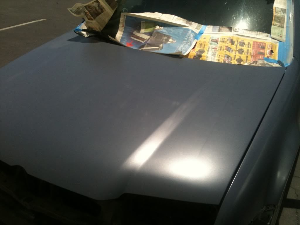

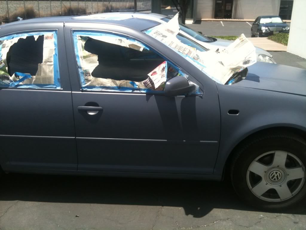

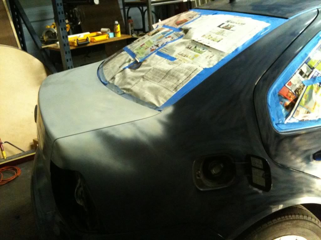

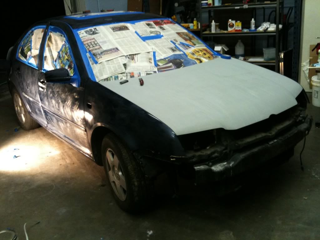

Here's the car with a rough sanding, just before I primed the whole thing":
Then, I mixed the paint 12 oz. paint, 4 oz. Penetrol, 2 oz. Mineral Spirits - a mix i picked up from this forum. I also added a hint of Japan Drier. I think it went on well.

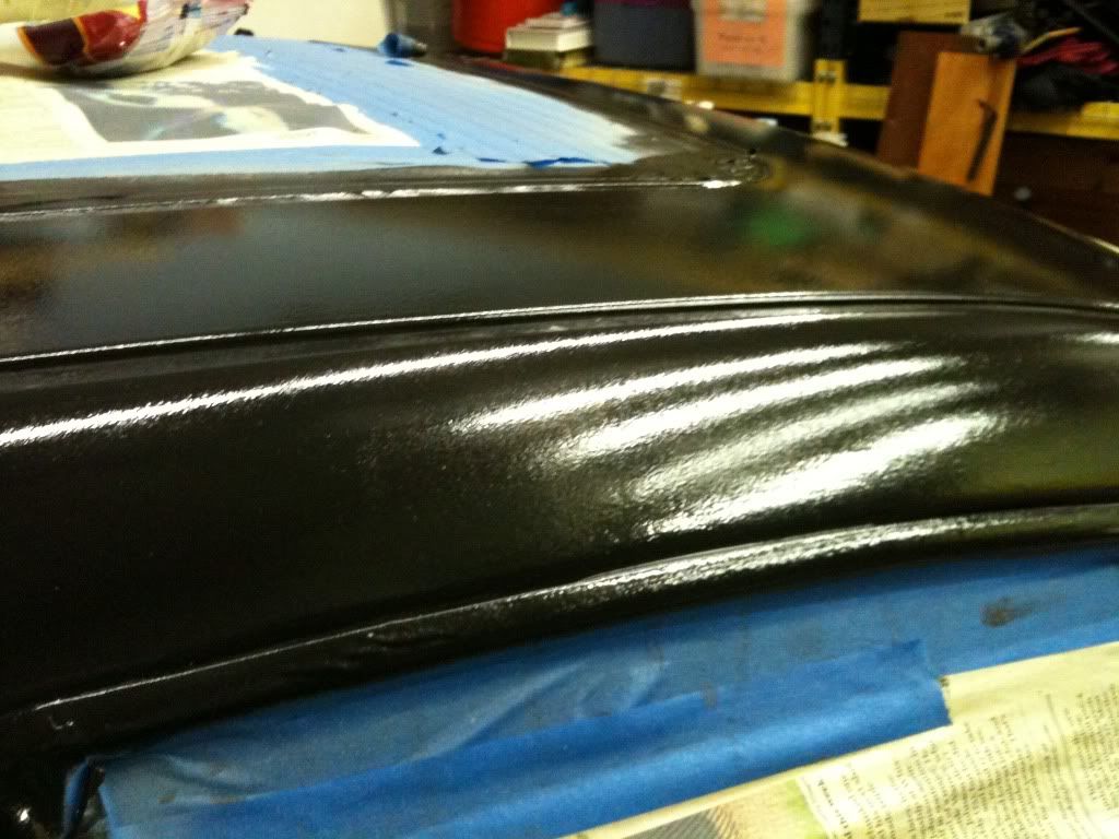

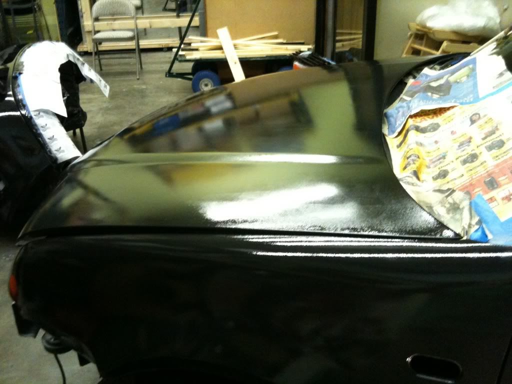

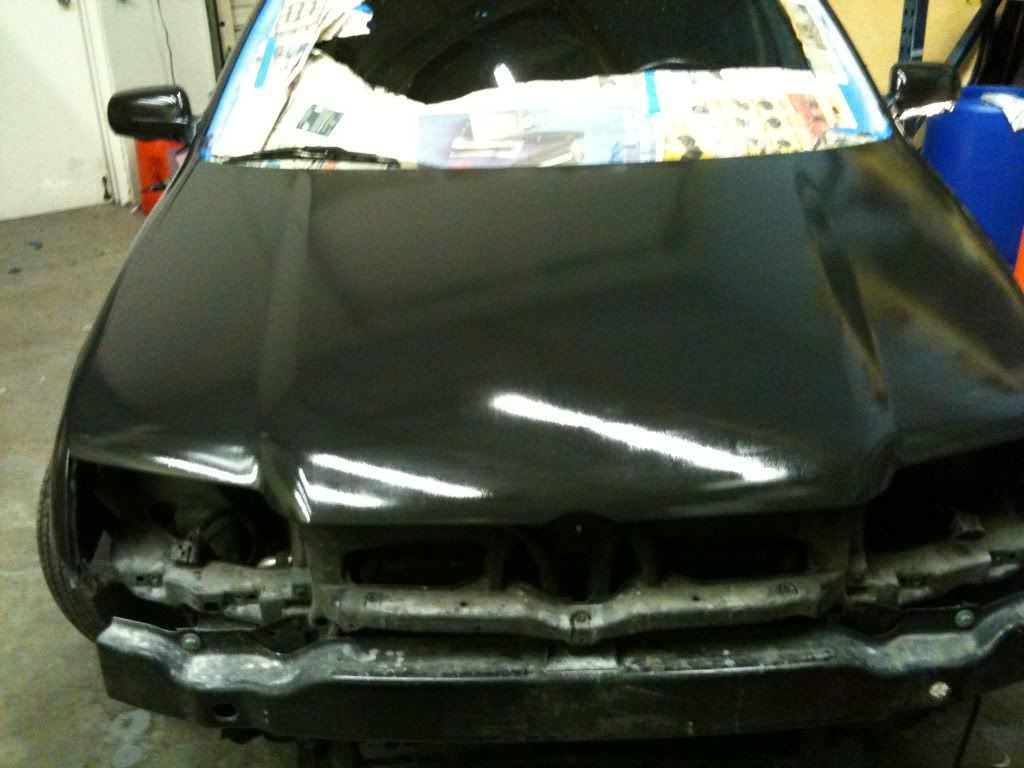

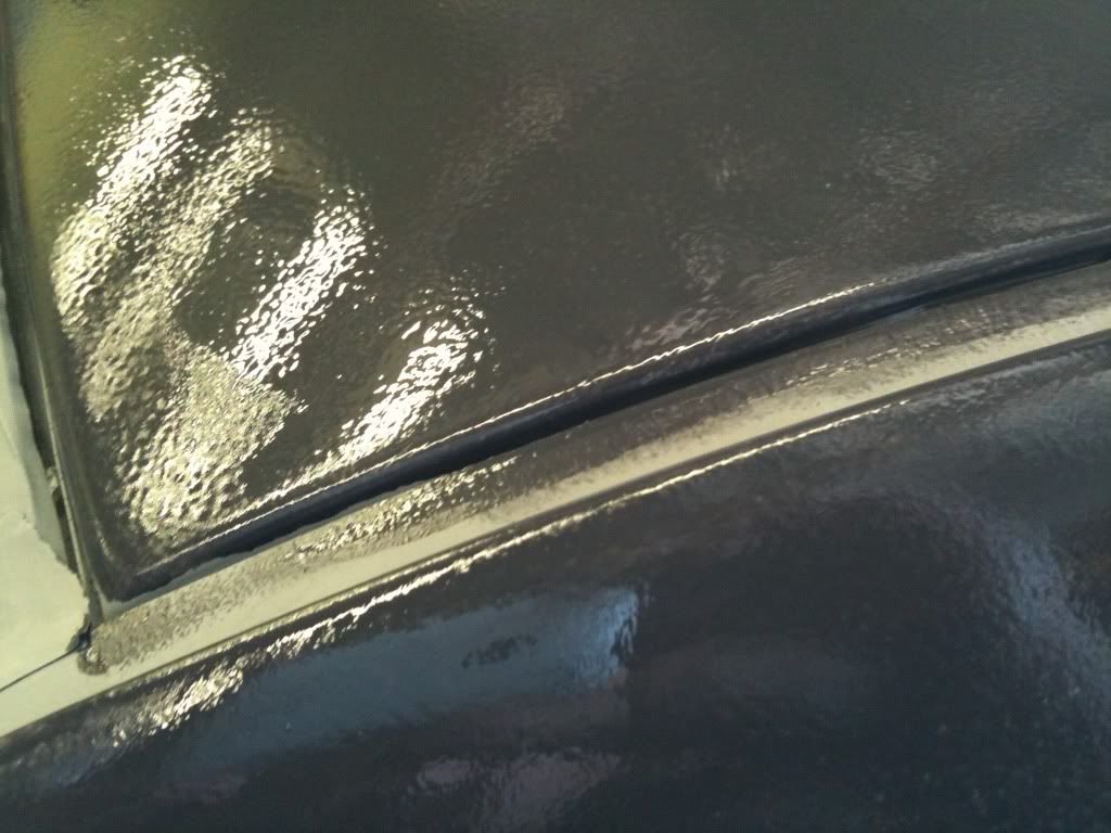

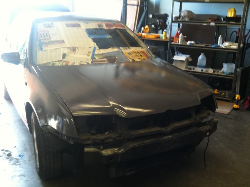

Here's the first round:
I'm a little streaky and a lot peely. But the second coat went on very nice:
So - the color I chose was supposed to be a dark grey. It has turned out to me more greyish-purple. Purple might be a great color, but I don't want to drive in it. I went back to Ace today and got pretty much the darkest grey that they had with the expectation that it will dry a little lighter - as my current paint has.
I think that rolling on a darker color won't be too detrimental to my paint job. Same paint, darker color. Not going from dark to light.
I'm surprised at the coverage I have after the second coat.

Welcome.... second coat looks much better.
Re: 2001 VW Jetta
Post by rmdhokie on June 18th 2011, 9:41 pm
Casey, Welcome and nice project. At 140K miles that car is just getting warmed up...many more miles to go. From the pics above, looks like your first coat was very thick...that's a alot of coverage for coat#1. Second coat looks much better. Are you painting outside in direct sunlight? If so, that may contribute to the amount of peel your getting...paint not having enough time to flow out before the sun bakes it. I'd recommend putting the paint on as thin as possible to combat any peel...and sanding it out later.
What I've noticed is that the cooler the temp the flatter the paint will dry. It's been in the 90's here lately and my last coat (# eight) had more peel than any previous coats. So, I've decided to westand the day/night before and start painting early (5:30am) in the morning when the temp is in the 70's and the paint will have a few hours to flow out before the heat takes over. Coat #9 turned out much flatter than #8. Using Japan drier is yet another variable too. Keep the pics comming.

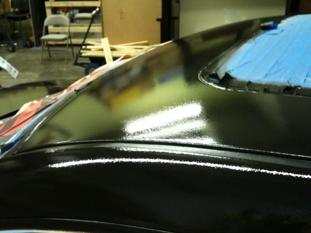

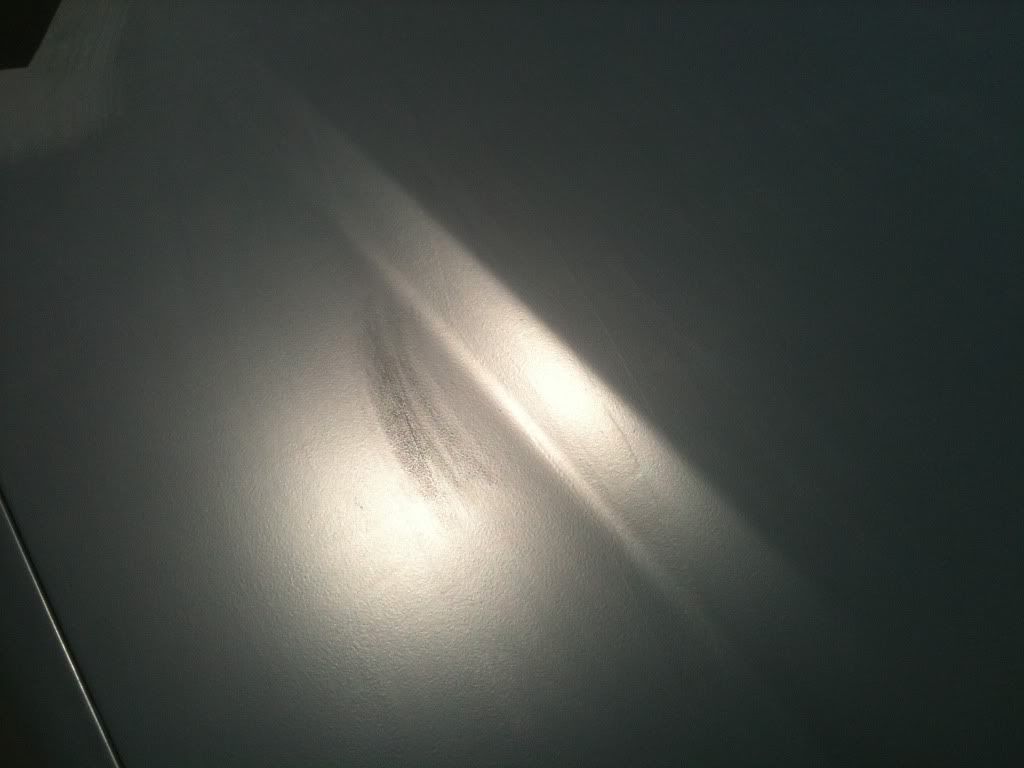

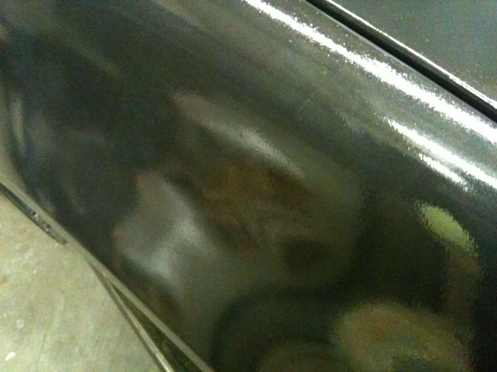

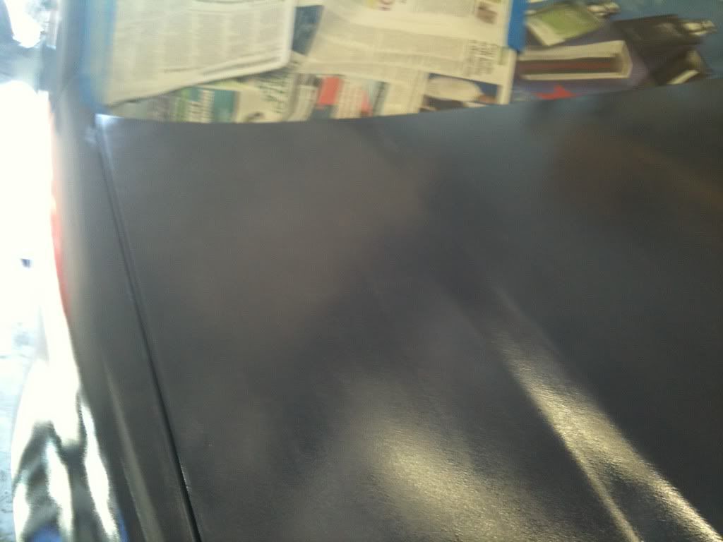

3rd coat, new darker color:

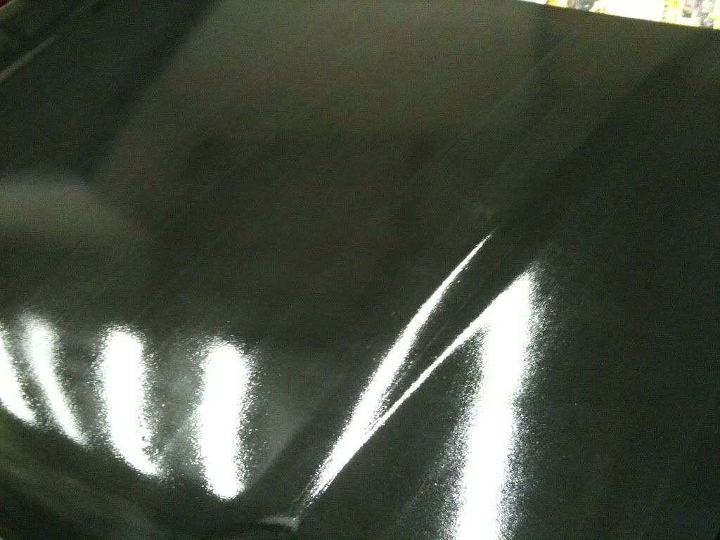

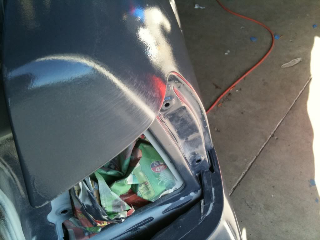

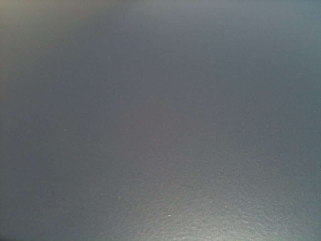

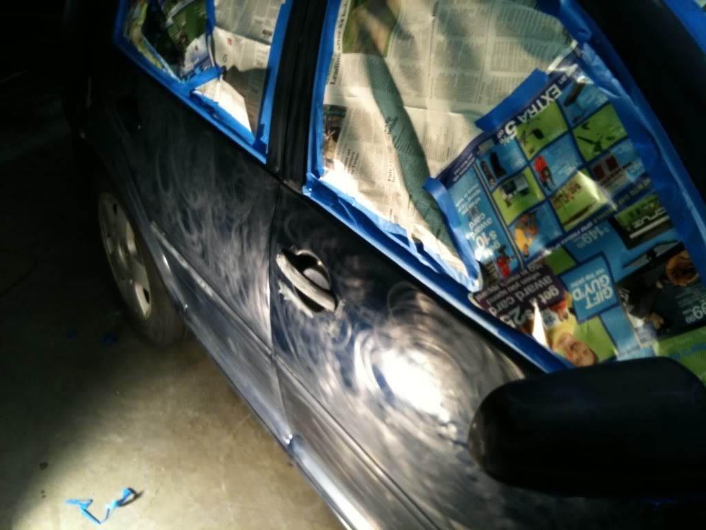

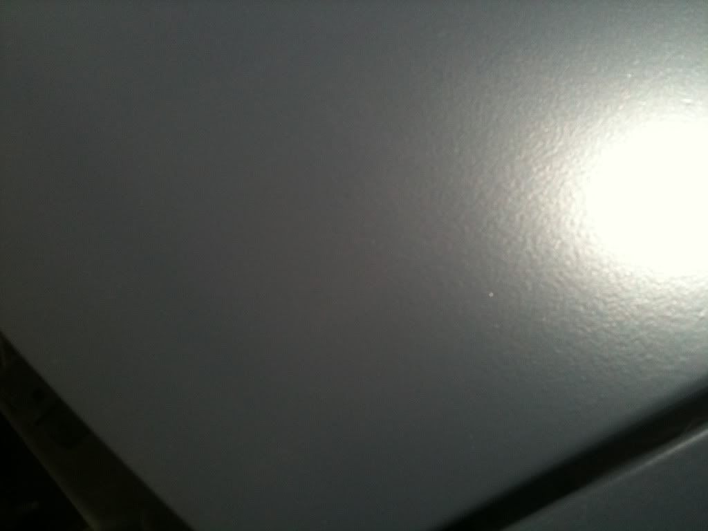

5th Coat:

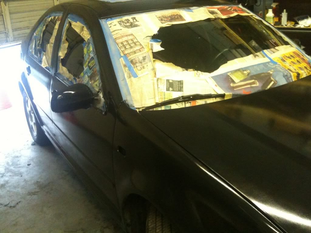

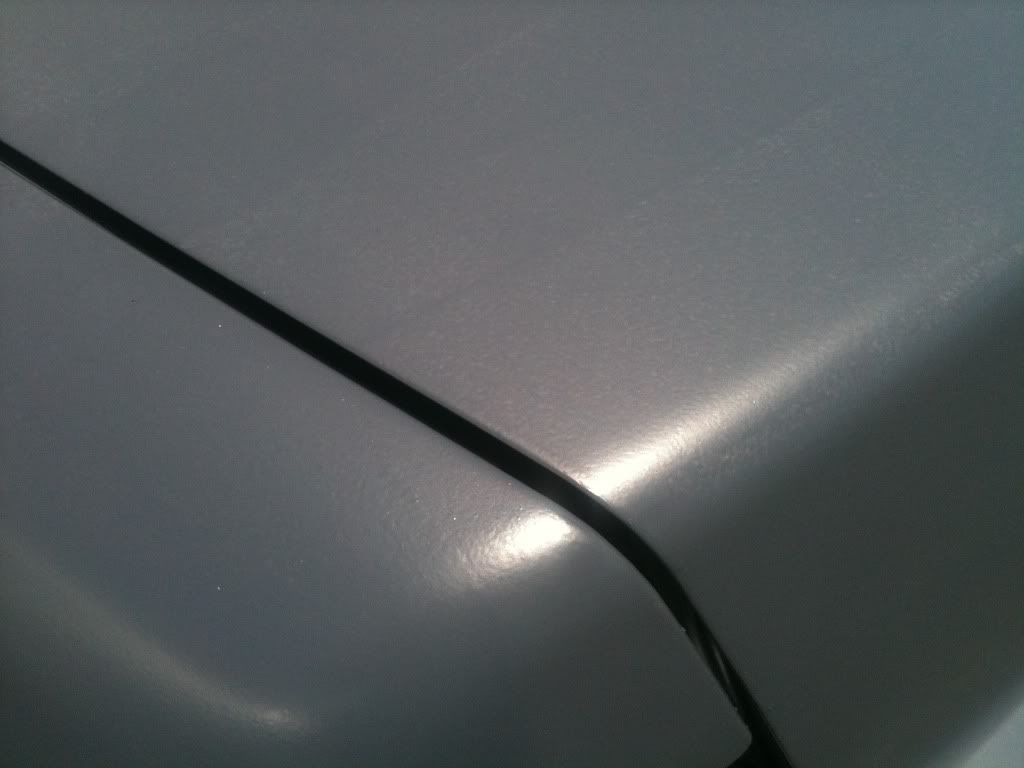

6th Coat:

1) As per previous comments, I think my paint was too think at first. I think I've adjusted to a better consistency.
2) I had to buy new rollers, and bought at Lowes instead of Home Depot. The Lowes rollers flaked and got pieces of foam all over my paint. I think it will come out in sanding, but I'll stick with the HD rollers.
3) This is a lot of work!
Questions:

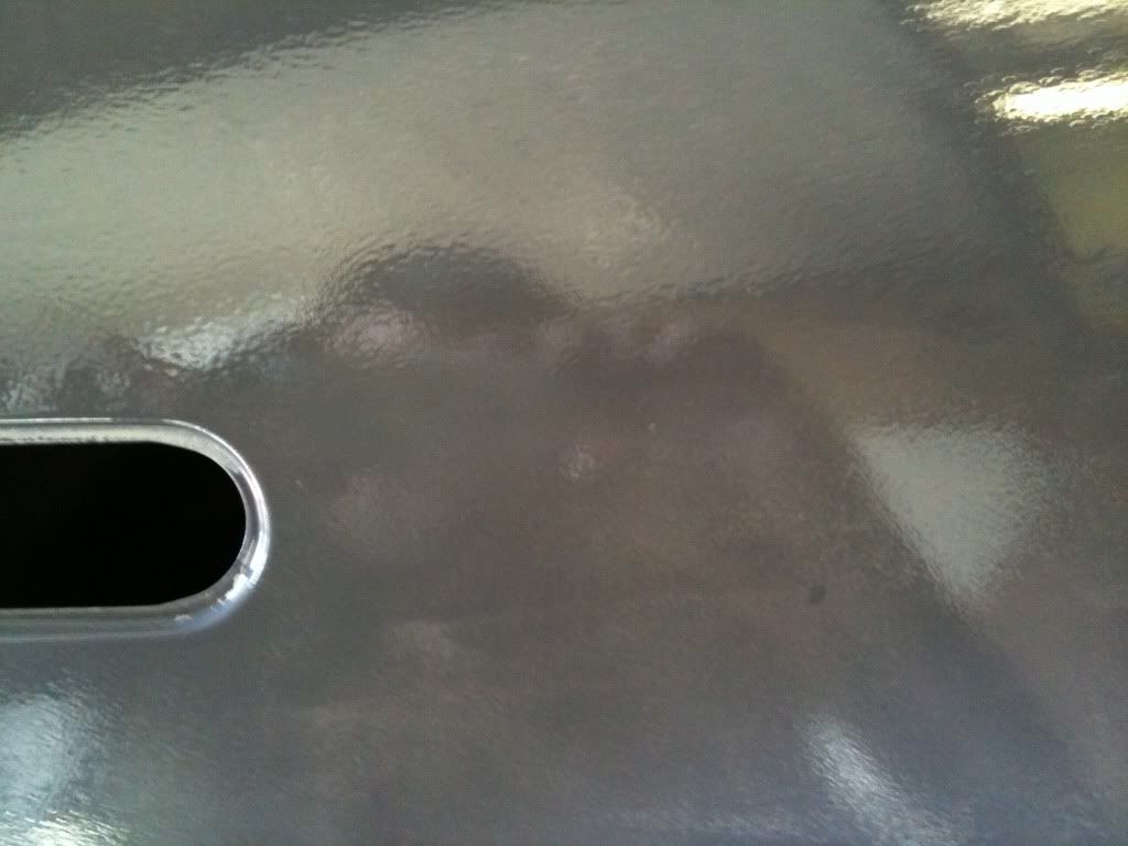

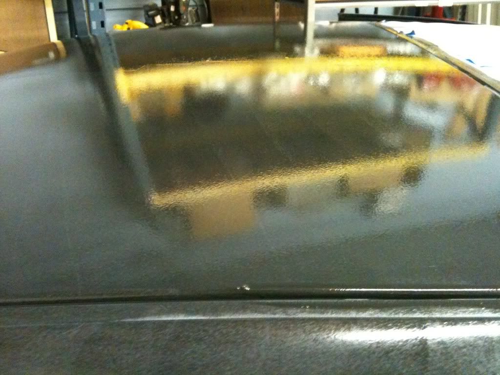

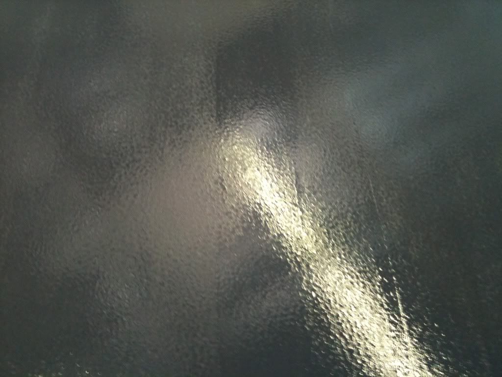

1) In the 3rd coat pictures you can see roller lines on the hood. I thought these would come out better with sanding and painting, but on the horizontal surfaces I still have them. What can/should I do here? Will they come out with sanding and polishing?
2) orange peel is getting better with later coats, and with thinner formula. I've been using Penetrol. Do you think that has helped me or hurt me in the outcome of my painting? 12 oz paint, 4 oz. Penetrol, 2 oz. mineral spirits.
3) Would there be bad implications if I just went 12 oz paint, and 6 oz mineral spirits? Or, should I stay consistent in my mix throughout.
4) A polisher - will almost any polisher do? Like the one I'd buy at AutoZone for $20? Or, do I need a $120 Porter Cable. I know which one I want...and I know which one I can afford. I guess I'm asking which one I need.
I think that's it for now. Sanding tonight (hopefully), then coats 7 and 8 tomorrow.

Edit to say - almost all of those pictures are when the paint is still wet, by the way.
