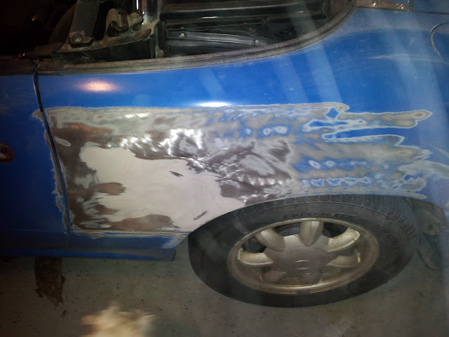

Found this forum after actually doing the work on the car. It's a project car, bought it for cheap.
Can't really see much here, but the hood had paint fade that was sprayed over, and poor body work on the left side fender and rear 1/4.
She was shot with sail blue rustoleum by the previous owner, and I got a lucky can of it when I bought the car.... ugh, this color is way too light, and the bodywork sucks.
Ground down a lot of the bad work.

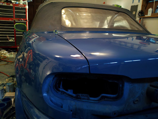

Post by syntrix on September 2nd 2011, 9:05 pm
Thanks Smile
Just a tip for you rollers out there. I just moved to 600 grit and the paper gets dirtier much faster. I've got at least 24 hours on this second coat. Probably less cure time on the 400 grit.
Working through the 600 now, and IMHO, this might be as far as I take it. It's hot out here so the paint self-levels very nicely.
I thinned at about a 2:1 via eyeballing.
I'm thinking that the next coat might benefit from a little more mineral spirits. also a good tip is to over roll.....
The hood for example, I went left to right working the paint on 1/2 the hood. After many rolls.... then went front to back with barely any pressure to even out the paint.
Same idea on the back side pics. rear 1/4 was front to back at first, then up/down to help move the paint around.

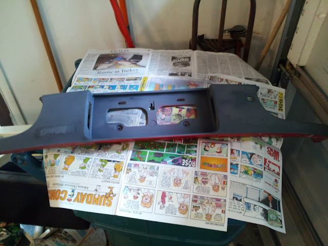

Post by syntrix on September 3rd 2011, 6:01 pm
Got a rear panel today, but it was red these are notorious for breaking. Even removing my rear emblems, I broke my stock one!
Hit it with some primer:
Part of the way shooting it with the same paint. Figured I'd spend some time on this since it's a tiny air gun, but better than rolling:
Rear section is almost blue, yay!
Also the stock one broke into many pieces while trying to salvage the emblems, lol. These things are fragile.
