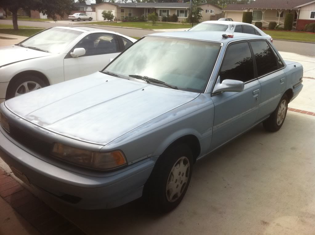

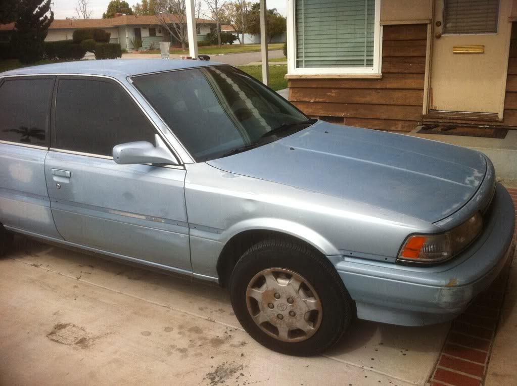

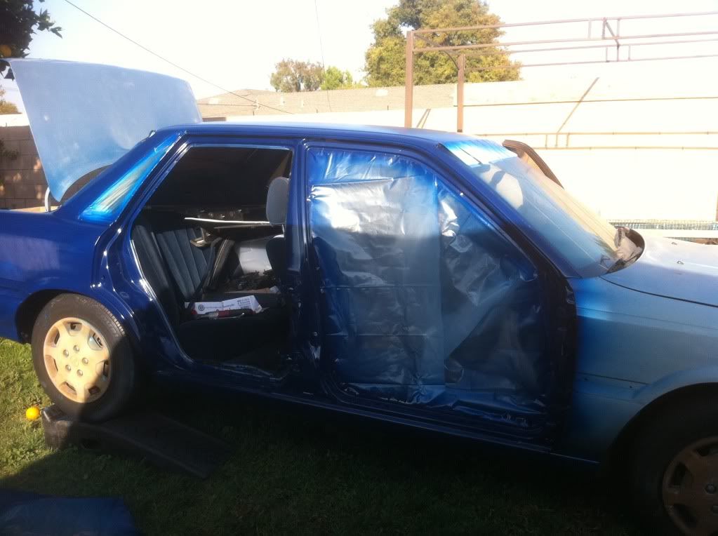

The gray spots are primer. The paint had gotten so thin there were spots of rust starting to form. Drove it around for a few months this way. You should have seen the faces of valet attendants when I drove up in this sorry condition. lol!
Well, I pulled all the trim, doors, trunk, hood, and gave it a good wash with scouring pads (the kind made from steel wool and detergent mixed together). Than wiped it all down with mineral spirits, and wiped off with micro fiber towels. The body wasn't perfect so filled in some dings with glazing putty. There was a wrinkle on the fender from someone sitting on it, and that got worked out. Looks 8 out of 10. Still not very good with body work.

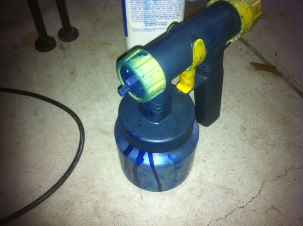

Now for my weapon of choice. Its a Wagner Finespray HVLP unit I picked up from craigslist a few months ago. It was used once to paint his cabinets. I paid $30 for it and it has already paid for itself by replacing for the cost of spraypaint that I used around the house.

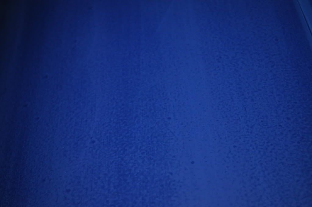

Here is my first coat of paint on the car. I am still experimenting with the mixture and the setting on the gun.
It has alot of orange peel and it definitely leaves alot to be desired. After going through a quart of paint, I had fine tuned the mixture and spray settings.

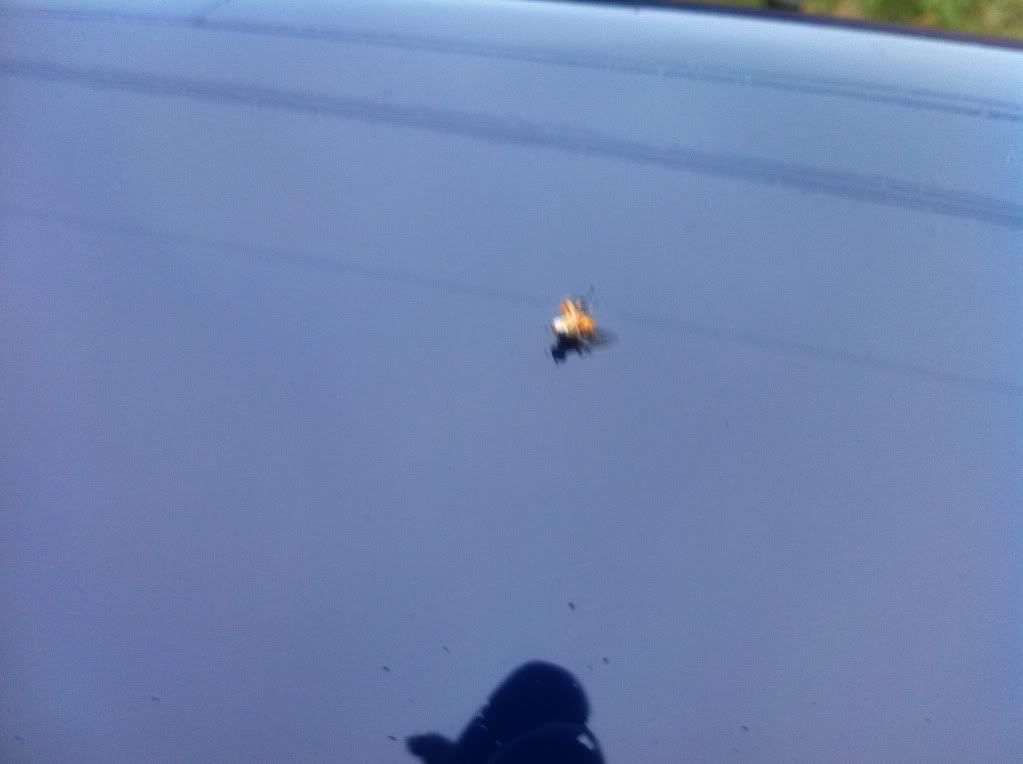

Don't paint under a tree. I hate bugs. Tree sap doesn't help much either smash

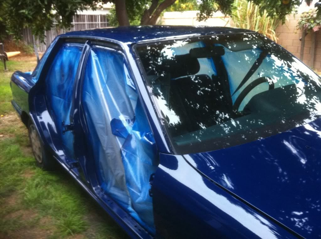

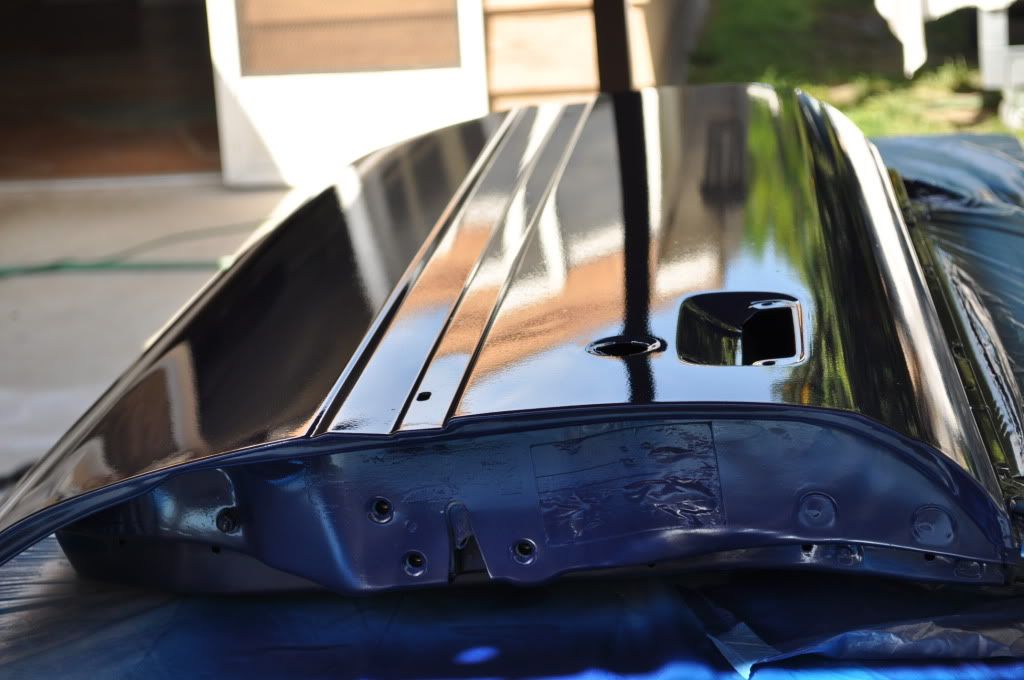

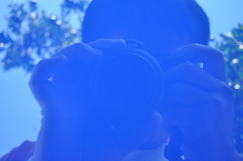

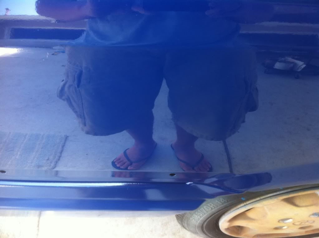

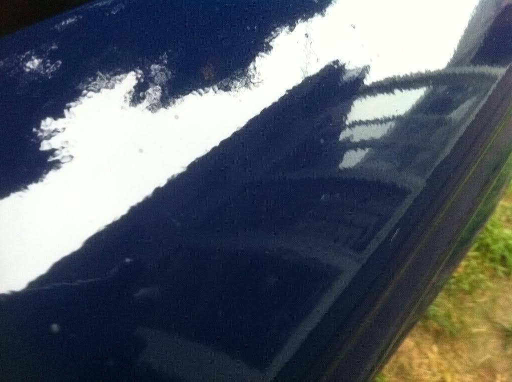

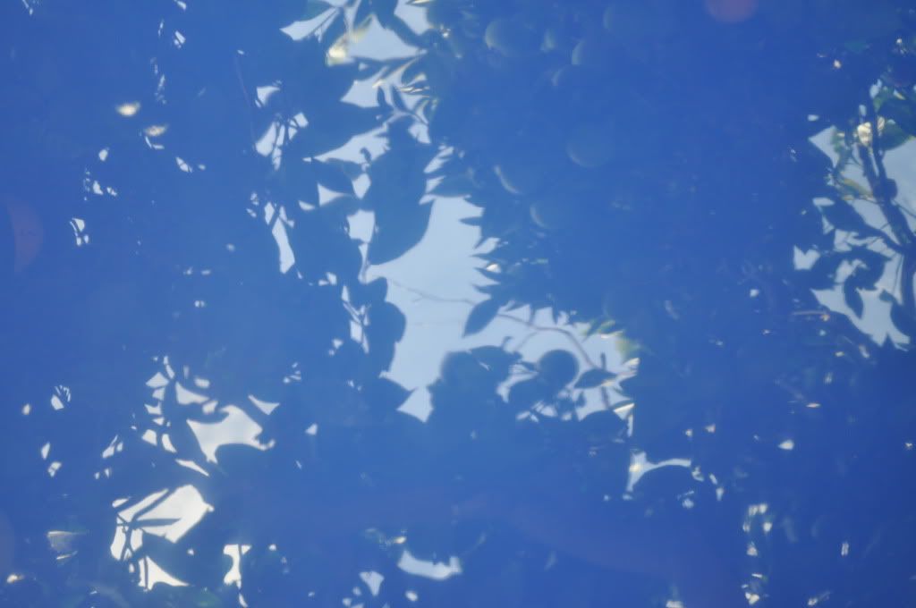

Here is an example of what it looks like if done properly. This was after the second coat.
So I sprayed 1 coat. used a scuffing pad to remove dust nibs and debris from the paint. Wiped it down with mineral. Spray another coat. wait to dry. Wetsand with 800grit. Then spray the 3rd coat.
In total I have 4 coats of paint on the car. 3 would have done but that first coat was during my testing phase that I ended up sanding down anyways.
Overall, it flows well and looks very glossy. It looks perfect from 5 feet away. There is some orange peel, but no more than would have come from a factory finish. Still got to finish the doors, and refurb my trim pieces. Will post more in a few days when I get further along.

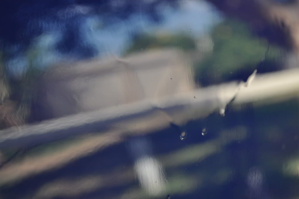

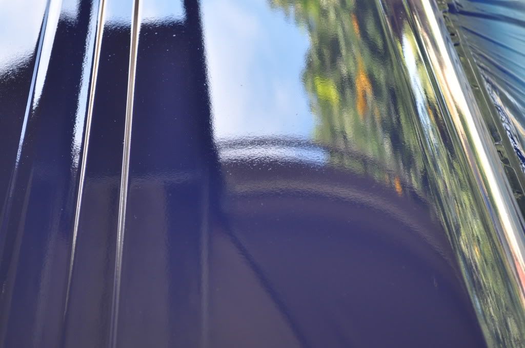

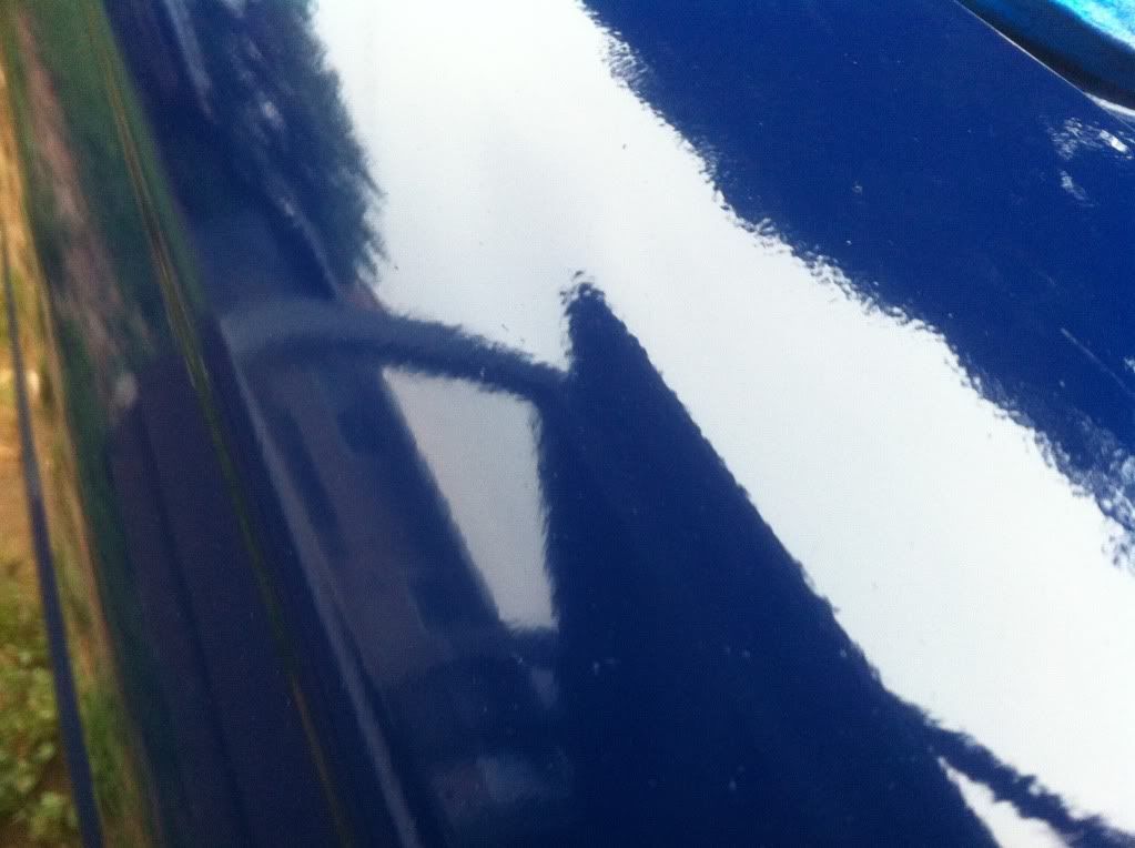

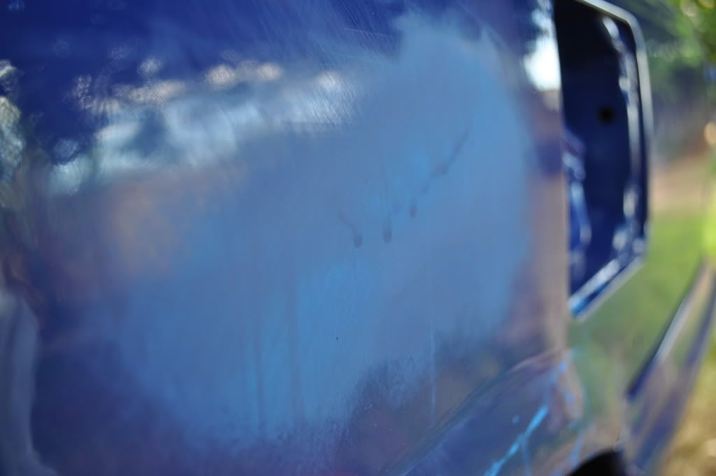

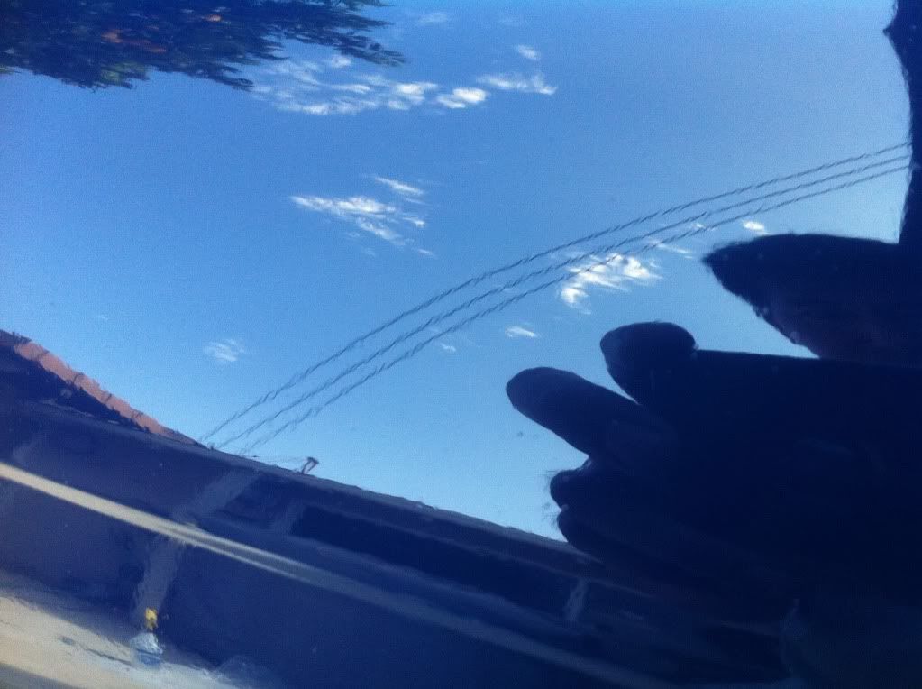

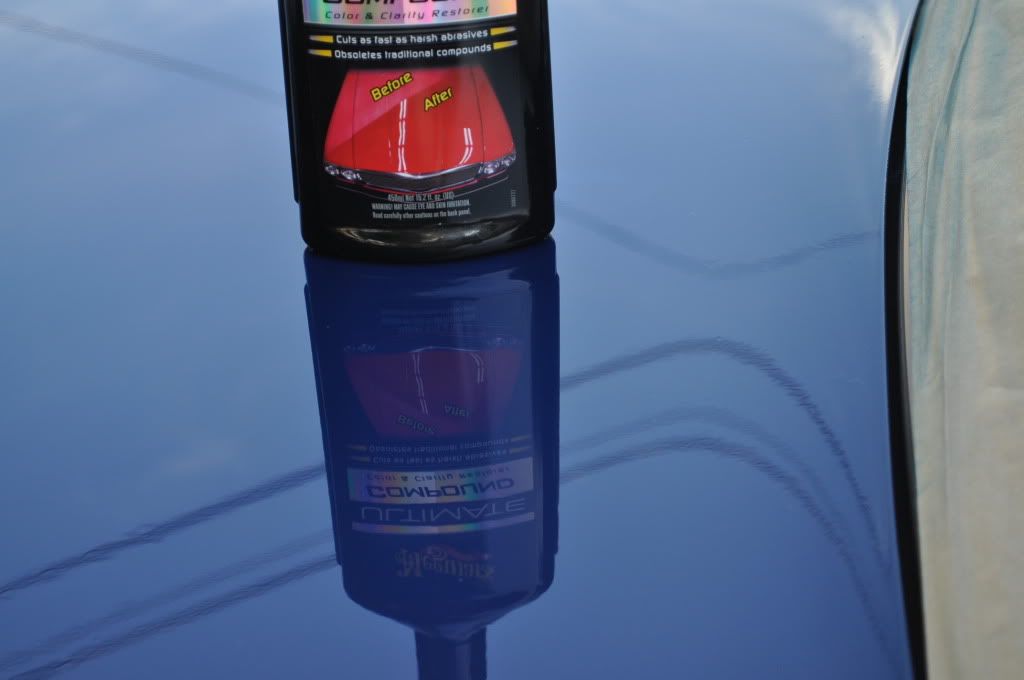

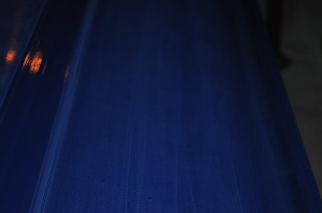

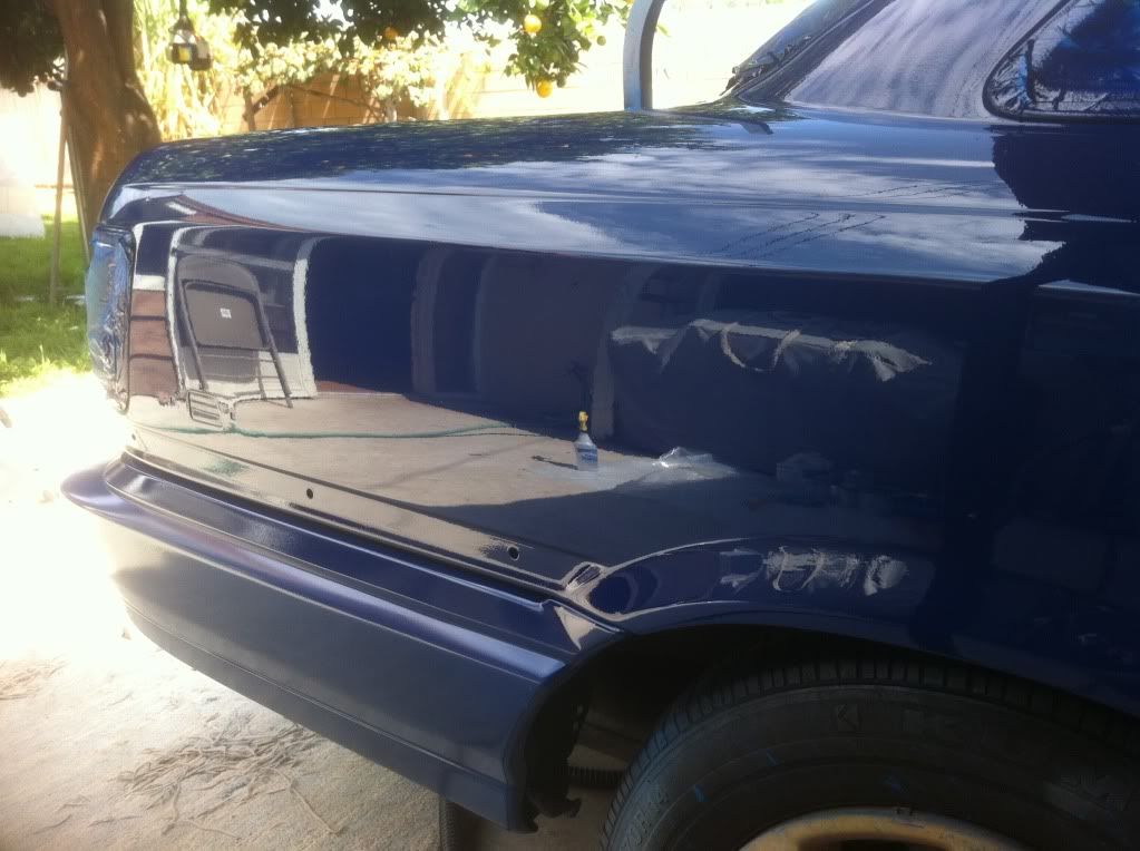

Have a few more pictures. Took my SLR out for some better pictures of the orange peel. Did get a few runs from laying on the paint too thick. If you look closely at it the paint has glassed right before the run. This is pretty much an indication of how heavy a coat you want to spray on to get the smoothest finish. Also, this paint seems to flow on vertical surfaces but not so much on horizontal surfaces. There is a really fine line between glass and run. I'm veering on the side of caution with thinner coats now.

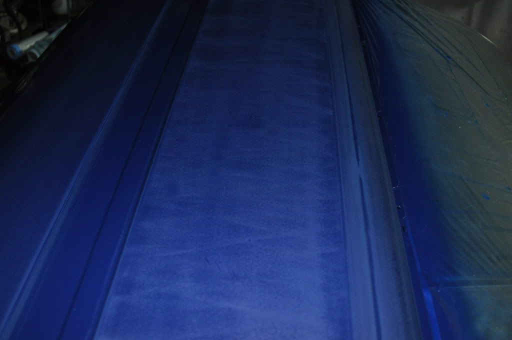

And here it is, sanded down with 600grit/wet.

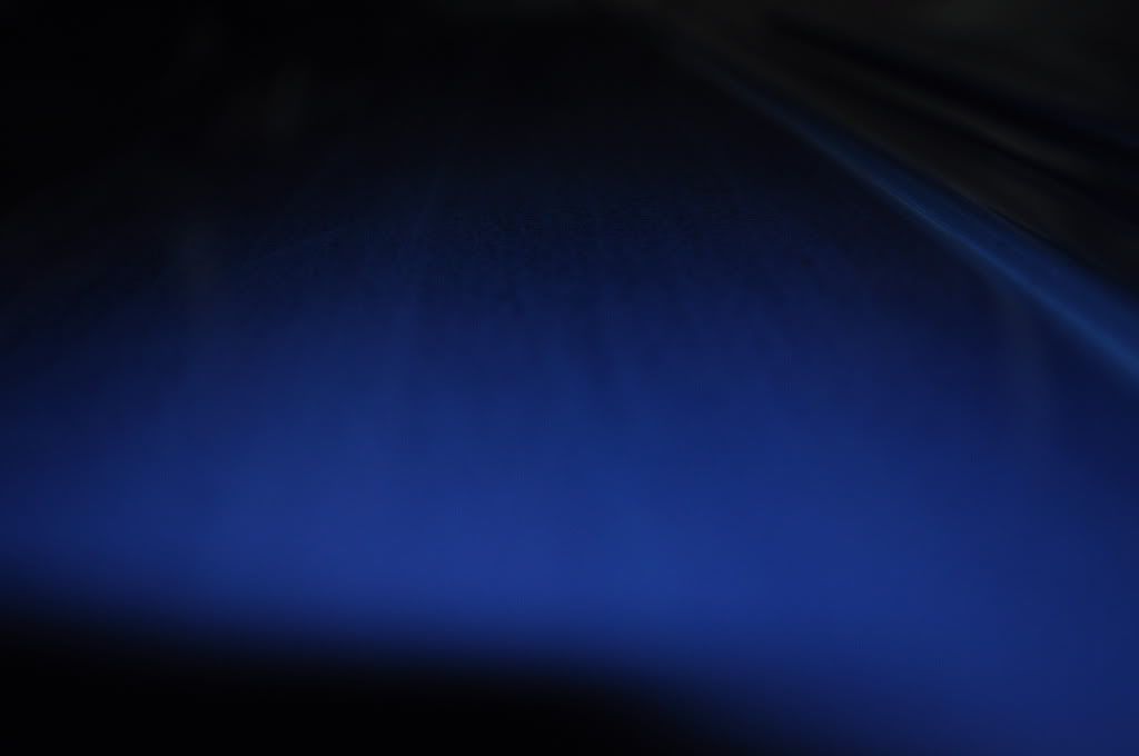

And here is the door panel and the orange peel. Again, thinner coats than before.

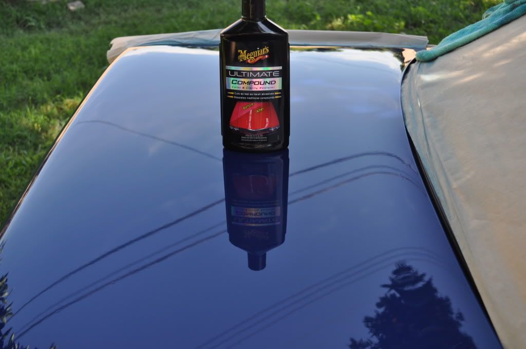

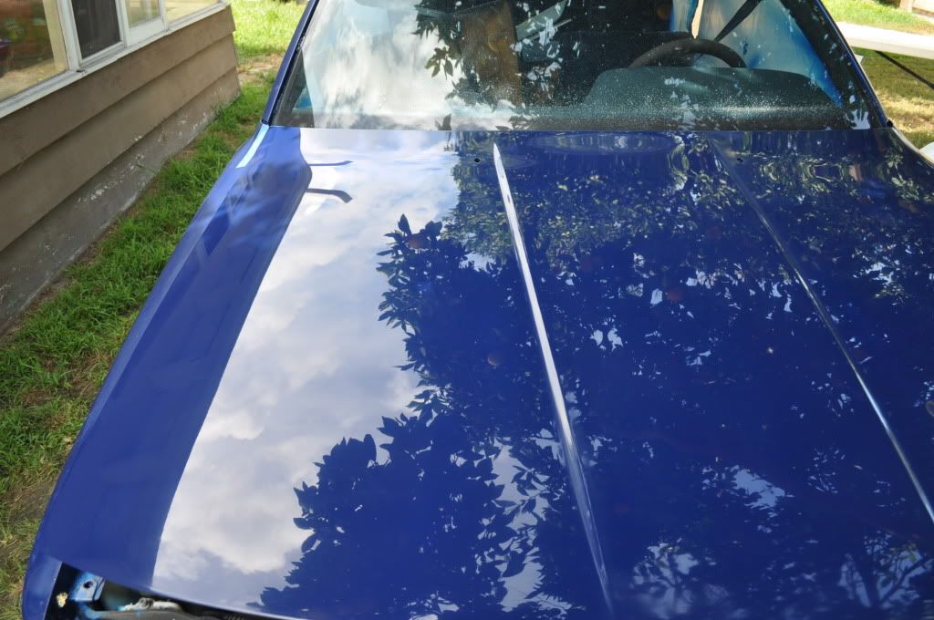

And this is the hood. Wetsanded with 1000grit wet and buffed with rubbing compound. I didn't bother with finer paper yet.It does look cloudy but I will hit it again with more paper and polish after I get the car put back together. I really wouldn't have bothered wetsanding if the bugs and dust would have stayed off the paint. It's amazing how much dust can collect in the hour it takes for the paint to tack.

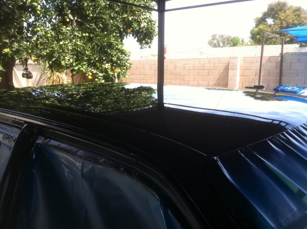

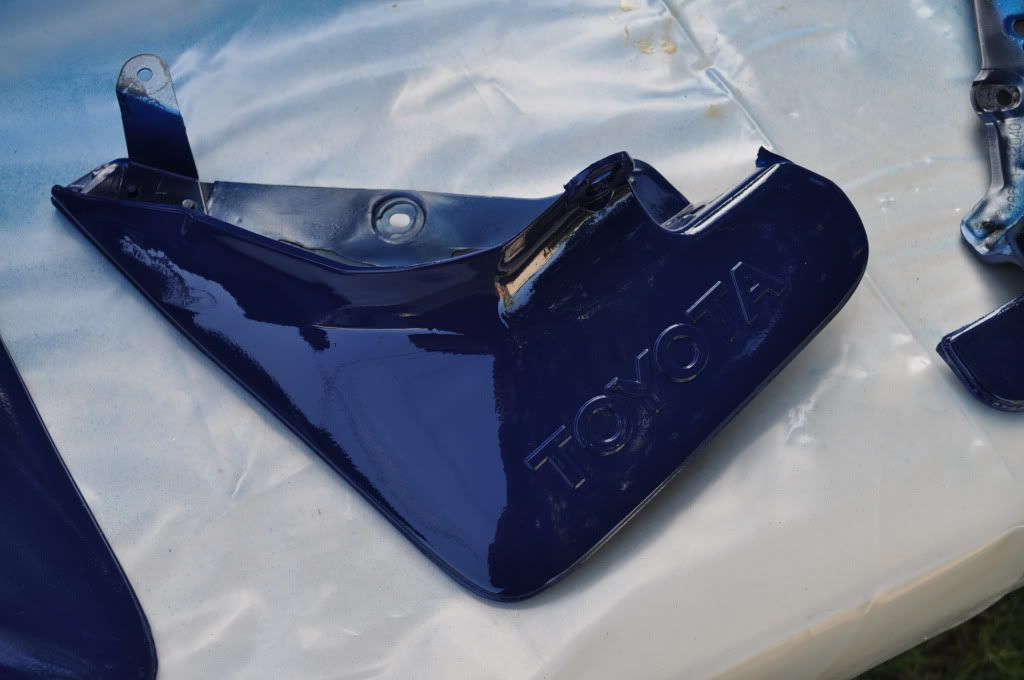

This is the gloss after the paint has dried. I don't think I want to wetsand or polish any of the panels as I am in the time crunch now.

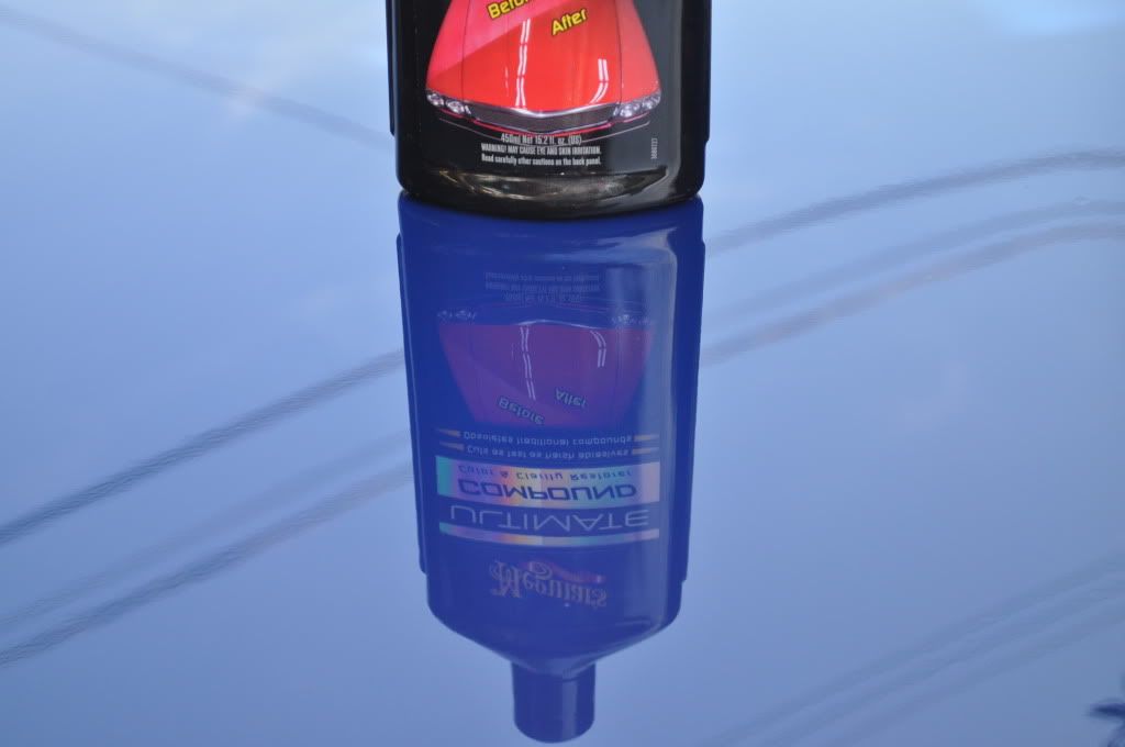

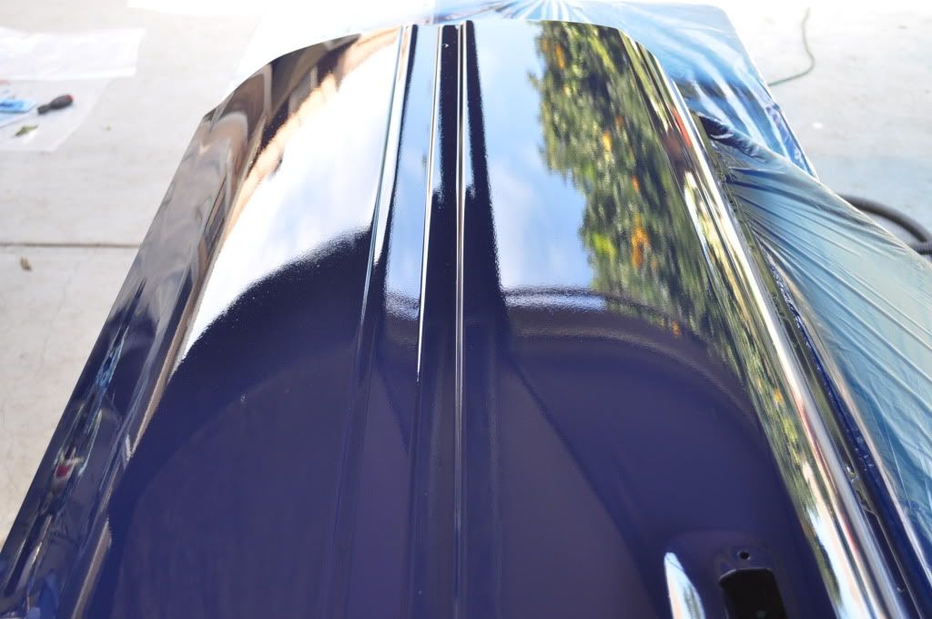

Here's a few photos of my trunk lid after buffing. I did hit it with some 2000 grit to remove any dust nibs and such but not to the point of making it glass smooth. Still came out great.
