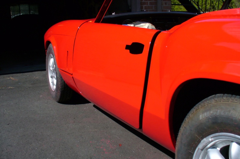

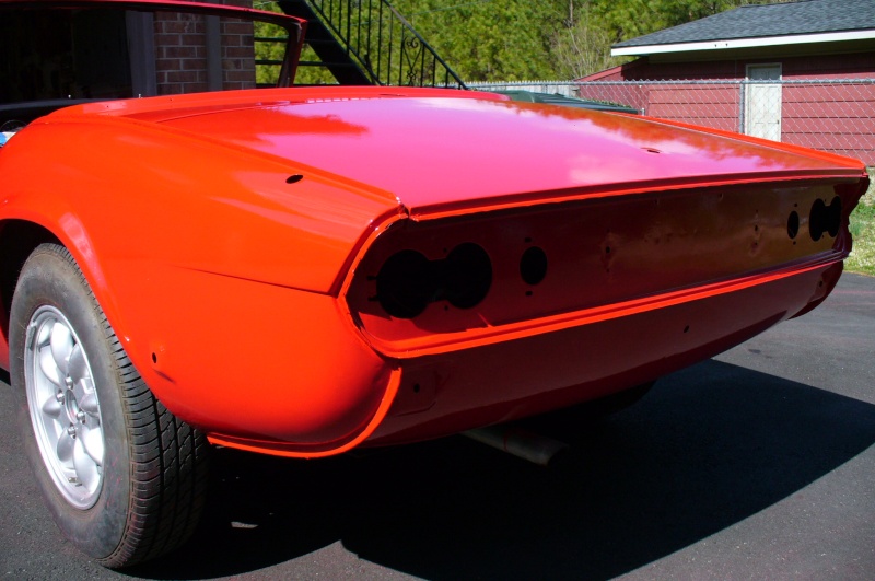

Re: 1975 Spitfire
Post by superdave on February 25th 2012, 4:41 pm
Pulled it out in the sun for a little "look see". Good coverage. A few dark spots (very few), but I think the next two coats will get it.
It's now been sanded with 800 and sitting in the garage waiting for coat #7 tomorrow. When it looks as good as it does in the above photos, its sure seems strange to be sanding. That's the process. It sure beats spending $2k or more on a comparable paint job.
edit: After letting it dry, I can see I need to do some more sanding. Still way too many pits from the orange peel. I'll work on that tomorrow.
superdave

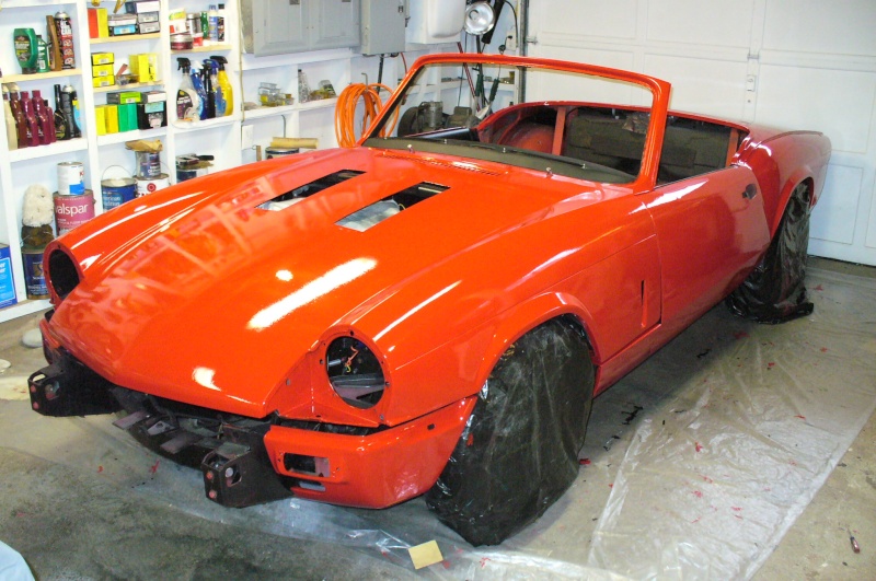

Re: 1975 Spitfire
Post by superdave on March 4th 2012, 4:35 pm
I put coat number 7 on today. It rolled out extremely smooth (after sanding and sanding to remove the previous orange peel). I am very happy with everything but the hood. Being a tilt front end, the hood includes the fenders too. It's such a large area that I have to work hard to keep my wet edge working. I ended up rolling back through the paint too much (it had dried too much) and it's not nearly as glossy as the rest. I had a great idea today. I had been toying with the idea of a single black stripe about 6 inches wide running down the center of the car. If I do that, I can effectively cut the hood in half as far as worrying about the large area and I think I can keep the surface wet enough to work the entire panel (half at a time).
Everything else on the car is slick. The hood is the only issue now. I'm going to let it dry and then get rid of the orange peel on the hood. and lightly sand the rest with 600. I'll lay out where my stripe will go and put on 2 coats of red. I think that will fix the problem and I was really thinking about doing the stripe anyway. It certainly fixes the issue of the size of the hood and the time it takes to totally paint it.

Post by superdave on March 5th 2012, 7:58 pm
Pics after last coat (number 7).
Here are the mirrors. They are fake Vitaloni Californian.
I may roll a coat tonight and then sand in a couple of days.
edit: I got the 8th coat rolled tonight
