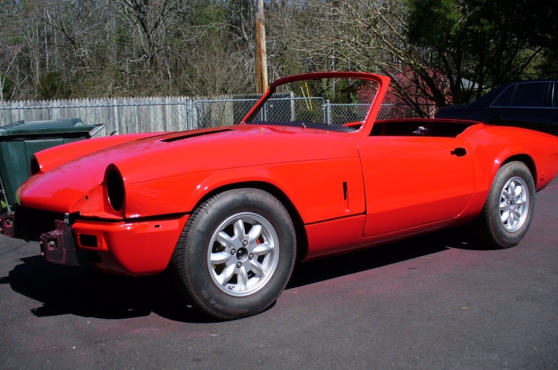

Finished (hopefully) with my painting. I have a decent amount of orange peel, but i tried to go a bit thicker with this coat so I'd have enough material to sand and buff without going through the layer. I don't know if that was smart or dumb. I cut back on the thinner a bit. I went with 12 oz paint, 4 oz Penetrol, and 4 oz MS. I loaded my roller more often. No runs, so I think I'm good. I guess the hard part now is letting it sit while it cures.
superdave
Re: 1975 Spitfire
Post by Tommy Hillbilly on March 10th 2012, 3:39 pm
That looks really good. I like the way that the blue sky reflects off of the hood.

Thank's guys. I knew I'd have orange peel, but I have a manageable amount. If I was going for a show car finish, I'd have dropped the car at the paint shop along with about $2500. I won't have that much in the whole car when finished.
Plus, I did it in my garage with a roller. Being able to say that is something.
superdave

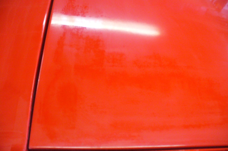

The Meguiars DA buffer works great. I've color sanded and buffed the car. I still have a little buffing to do. It is a little "cloudy" looking, but I could still have some residue on the car from buffing. It doesn't wipe right off but I'm working on it. It is very glossy at an angle and the orange peel is minimal. I'll take some pics when I get through with the buffing.
superdave

I am using micro fiber cloths. I have done some more buffing and it is spotty and cloudy. Where it has gotten shiny, it looks like it has burned through to the next layer. That is shiny. I only put on 1 coat of paint after my last wetland. I wonder if it is too thin?
If the Valspar paint fails, I could always lay on about 4 coats of rustoleum safety red I guess.
superdave
Re: 1975 Spitfire
Post by 63Falconconvert on April 16th 2012, 10:36 pm
Looks like its too thin. I did 3 costs for my final wetsand.
Re: 1975 Spitfire
Post by leeready on April 17th 2012, 3:28 am
Why would the layer underneath be shiny though? I don't remember that happening to me, but I painted with black. Maybe it's different. Not sure.
