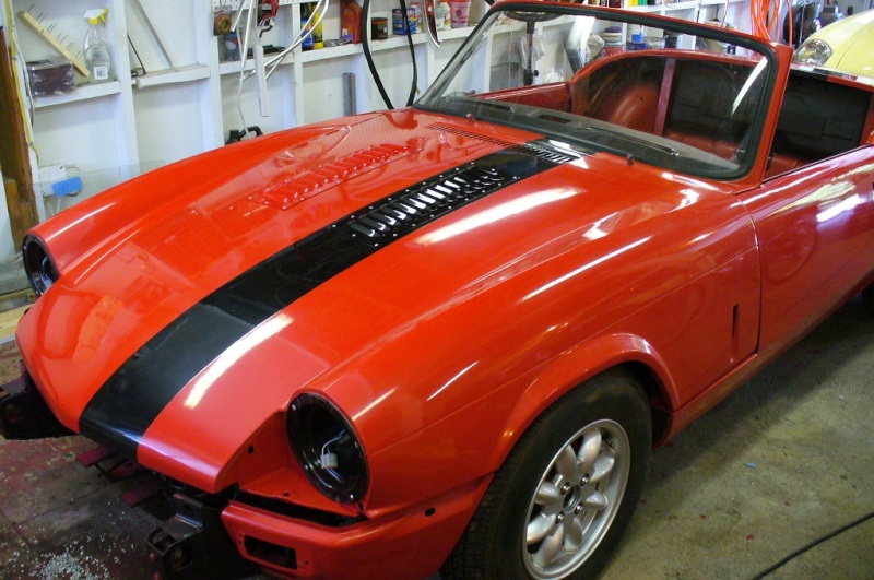

Post by superdave on May 28th 2012, 2:08 pm
3 coats of Rustoleum Safety Red over the coats of Valspar farm implement paint. I let it dry for a couple of weeks and sanded with 1000 and then 1500. Some buffing with a cutting compound and then some finish. I'm very pleased with the results. I think it will actually buff out better after it dries a month or two, but I wanted to sand and do an initial buff before I started the reassembly process.

Post by Mike MGBGT on May 29th 2012, 7:34 am
That is coming together real nicely, I've always liked the Michelotti styled Triumphs and the later restyled rear end really suits the car and successfully brought a 1960's car into the 70's. The style of these cars have definately matured well with age unlike the horrible Harris Mann styled TR7.
Really looking forward to seeing that car when it's done, the Safety Red looks good on LBCs, once the chrome-work is back on that little Spit, it will really catch some admiring glances.

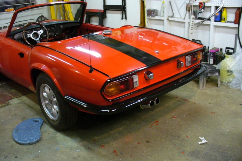

Post by superdave on September 18th 2012, 8:20 pm
After taking much of the summer off from working on the car due to many reasons, I have gotten back to work on it. The hot weather and time did wonders for curing the paint and allowing for a good buff. I buffed the whole car again.
I'm trying to finish it up now. I'm giving it to my daughter for a wedding gift.

Post by rmdhokie on September 18th 2012, 8:39 pm
Looks amazing. I'm sure your daughter will love it...great gift. Is she aware of all the time you spent on this car or is it a surprise?
Re: 1975 Spitfire
Post by superdave on September 18th 2012, 9:27 pm
rmdhokie wrote:Looks amazing. I'm sure your daughter will love it...great gift. Is she aware of all the time you spent on this car or is it a surprise?
She and her fiance are aware of how much work and yes, they know about the gift. I told them last week. He's a car guy and at first said that he couldn't take my car. I told him that it wasn't an option. They will enjoy it. Believe it or not, this was a "throw in" when I bought my MGB 2 years ago. The guy was just wanting to move on. Of course, a free car is like a free dog. I was going to sell one of them when I finished them, but this is a better option, and I still get to drive it from time to time.
