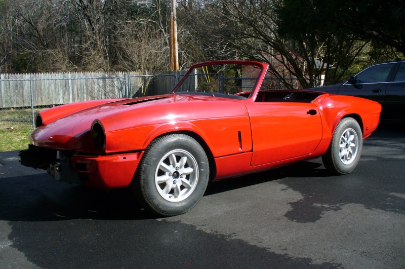

Post by superdave on February 17th 2012, 11:30 am
I got the second coat of the red done yesterday. It's Massey Ferguson Red from Tractor Supply. It looks orange now, but should get more red as I add more coats...I think. I pushed it out of the garage today to get a good look. I'll wetsand tomorrow morning and should get coat number 3 done tomorrow afternoon. I think the coverage is pretty good with only 2 coats.

Re: 1975 Spitfire
Post by leeready on February 17th 2012, 12:21 pm
Looks good in red. What's your mixture now? If not the same.

Post by superdave on February 17th 2012, 12:46 pm
leeready wrote:Looks good in red. What's your mixture now? If not the same.
Started with 12 oz paint, 10 oz thinner, and 2 oz Penetrol. That was a little too thin, so I added a couple more oz of paint.
