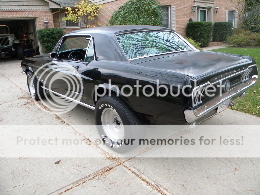

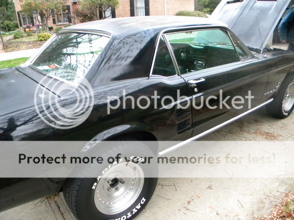

So...I've read, and read and read. Been putting a few things together based on some cars that I've seen on here. I have a 67 Mustang, bought it black, top was oxidized with surface rust, few bubbles here and there. After stripping everything down, found out there was a good portion of bondo used, I'm in the process of cutting and welding new pieces here and there (wheel wells/fenders). I am also knee deep in repairing the cowl (you mustang owners know what I'm talking about).
My dilemma is what color I want to go to. Like I said the car is black, I'm worried that my body work (I'm no pro) coupled with a black roll on job will lack with imperfections. I have been debating white with black or gray lemans stripes, gloss black with gray lemans (gray would almost be ghost stripes of gloss black slightly lightened). Or... Red (Massie Ferguson red, New Holland red or Allis Chalmers red) with white stripes. Trying to figure out the best color scheme with this type of paint process. I will be using the Valspar implement paint from Tractor supply, and using a hardener. The hood, trunk lid and front fenders will be done in my basement to conrol dust/temperature.
Please give me all your suggestions...or flames, need it all.

Post by Tommy Hillbilly on December 14th 2011, 8:14 pm
Are those rmdhokie's old wheels?
I think it looks good in black. If it was mine, I'd lean towards a dark blue or dark green, maybe. With a light colored GT rocker stripe.
I went with white, out of concern for flaws, and I'm glad I did. My job turned out wavy because I didn't use a long enough block when I started my color sanding. And I started with a 220 wet! The lowest I could find. I was in a hurry, and being lazy. I also got away with not finishing my buffing, or painting the door jambs. I'll try to get on that next spring/summer. What I've done so far made such a dramatic difference, that I just stopped working on it, and started driving the car everyday.
That's the beauty of this. You can keep going back, and perfecting your job, long after everyone else thought you were finished and that the car looked good enough to them.
Nice looking old CJ in the garage.

white with red leman's stripe's would be a great combo, if you are worried about body flaw's the white will hide a lot, follow rmdhokie's thread,again his result's were awesome, just take your time and how bad is your cowl, my fastback is pictured in rmd's thread, my cowl is in decent shape , no leak's really lucky on that one, national part's depot and cj pony parts sell the cowl patch panel's and complete cowl replacement's, love you car man 67/68 is my favorite model's

They are no his wheels, they were on there when I bought it. I'm going towards the Torque Thrust route. The drivers side cowl hat was completely rusted out, all I had to do was pick it up and pull it out, no cutting required! I have ordered the replacement, should be here in a day or two. My wife wants the car black, again, little worried about the flaws. Thanks for your input!

I'd go for the black, that car looks good in black. You can always finish the job and then go back and fix flaws panel by panel. And unless they're major, most folks will never spot them.
