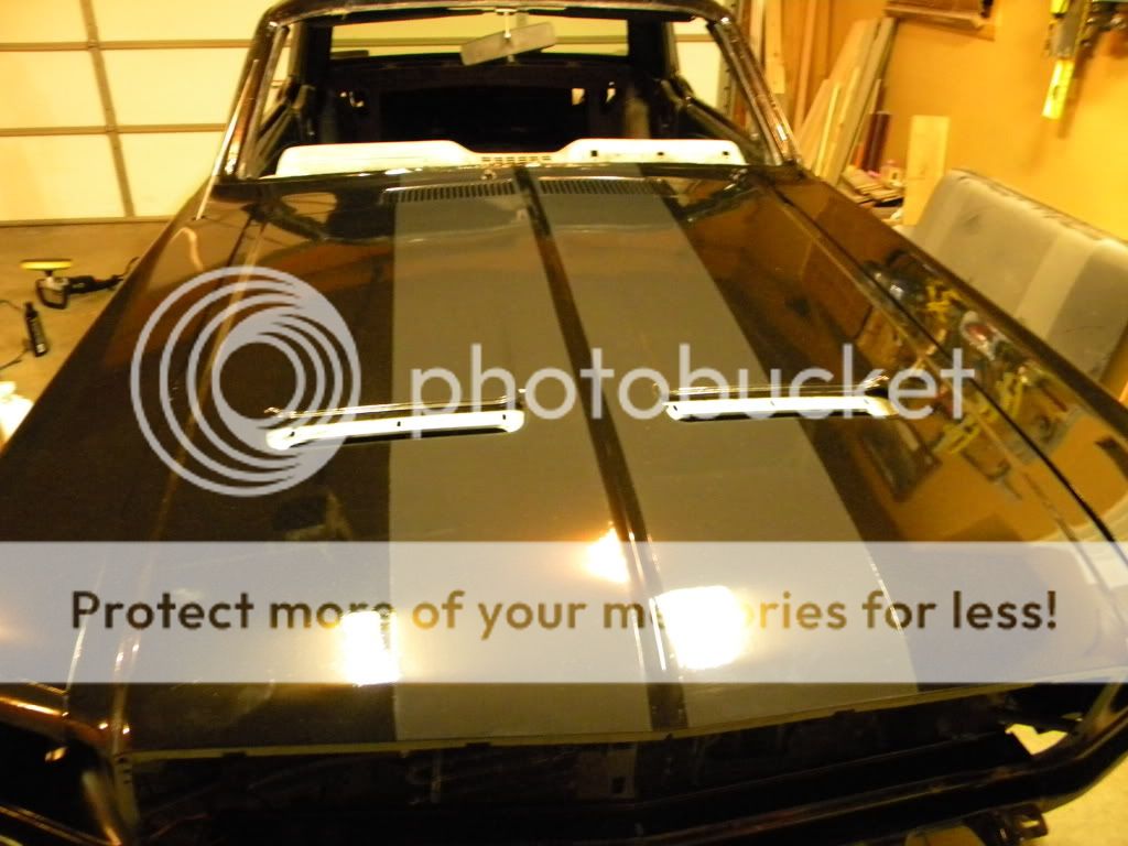

Its a finished gym area....I have a vent above the area, which is closed. I may tape it off. Still getting alot of dust as of the 6th coat today. I have to say, it is looking good though. I have full coverage, except the hood which I sanded down to primer to get rid of some roller marks. Kinda wish I had went with white, I found a couple small dings that I didn't know were there when I was doing the body work. I am kinda unsure if I want to try the stripes now that I have done all this work...I don't wanna mess up this decent paint job and have to start all over.

I think dust will always happen. It sure does to me...a lot. Some times my cat even jumps on my freshly painted hood. gun4
When you do the final wet sand the dust will be gone. Just make sure you put enough coats on your car.
I agree with the dings and black paint. I'm having the same problem right now. The worst part is if you think they look bad wait in till you buff the car. They will stand out even more.

marinecadence wrote:I found a couple small dings that I didn't know were there when I was doing the body work.
Now is the time to go after them. It's a much less big deal to tear into the already applied paint now, and fix any flaws which have become apparent. You can just deal with them on a spot-by-spot basis.
You'll run into pop-up flaws, and rub-throughs, and crap like that, and you just have to repair them and build the paint back up over them. That's a much bigger pain, after you've buffed it out.

If you can see them now I promise you they will look even worse after you buff it out. Black shows EVERYTHING.

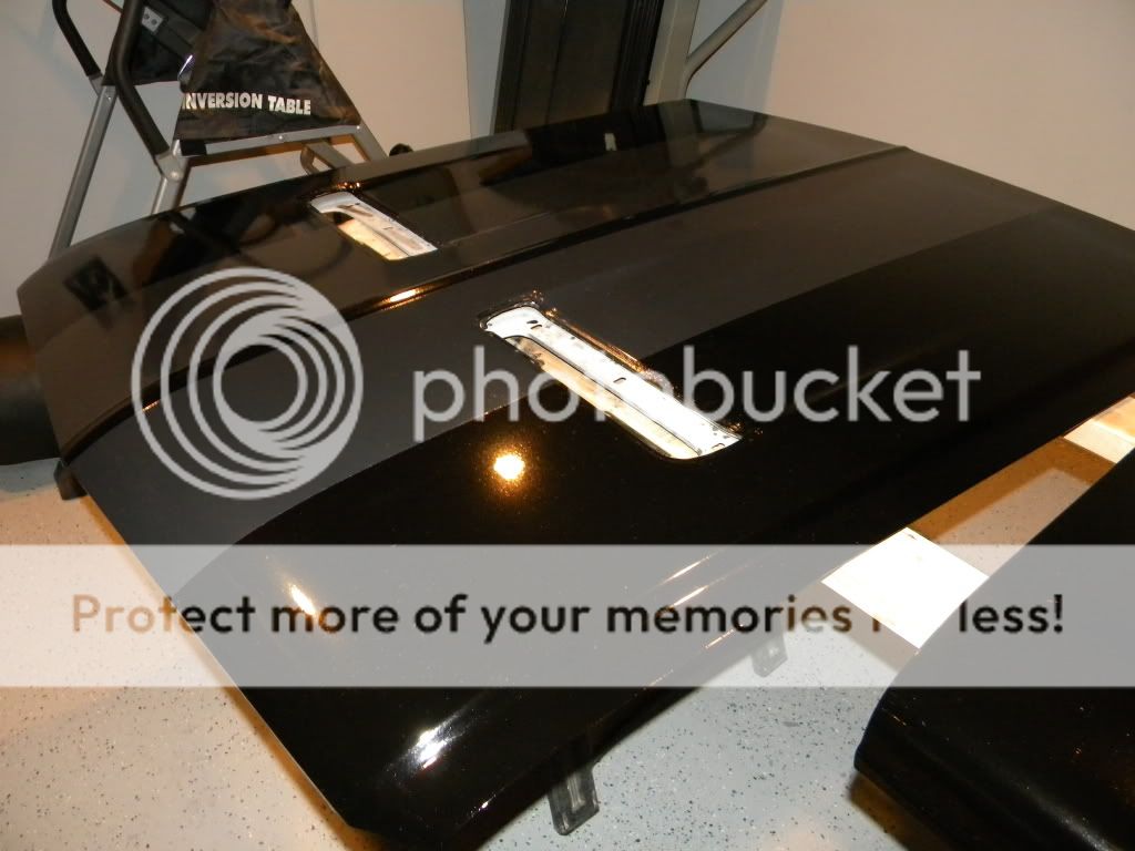

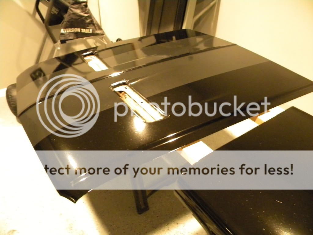

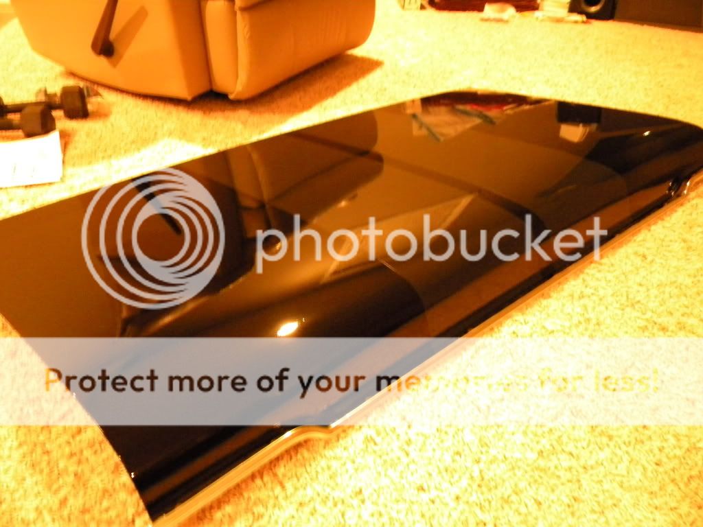

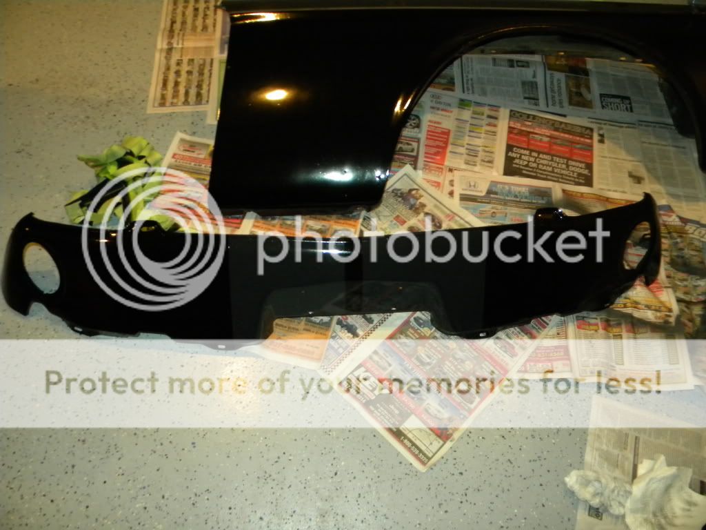

Got some pics of the hood, trunk lid and valance....body primed and ready for color....have a little body filler touch up to do to roof. There is a lot of dust/hair after the last coat....still have to wetsand a final time. Need to let offgas for about a week and then will sand/buff.

Post by Tommy Hillbilly on February 7th 2012, 3:53 pm
Those stripes will look pretty cool. Black is good for that car - nice and sinister looking...

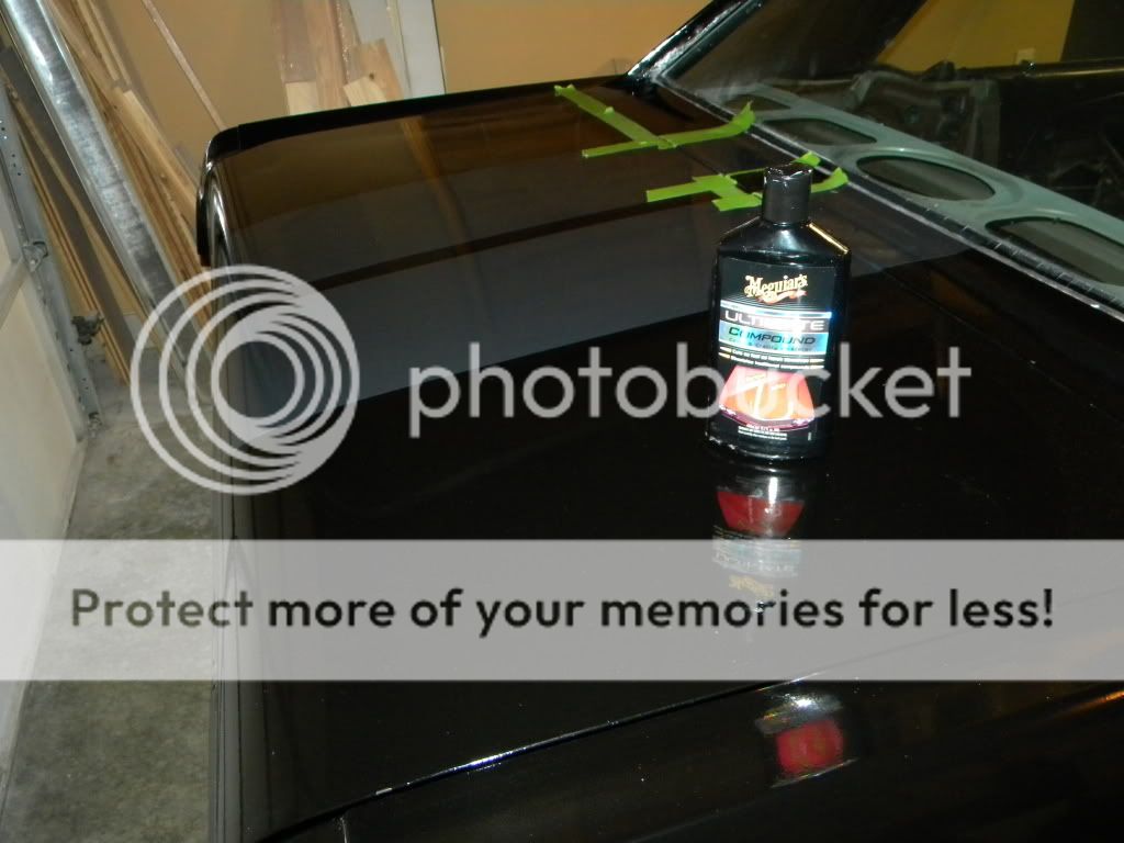

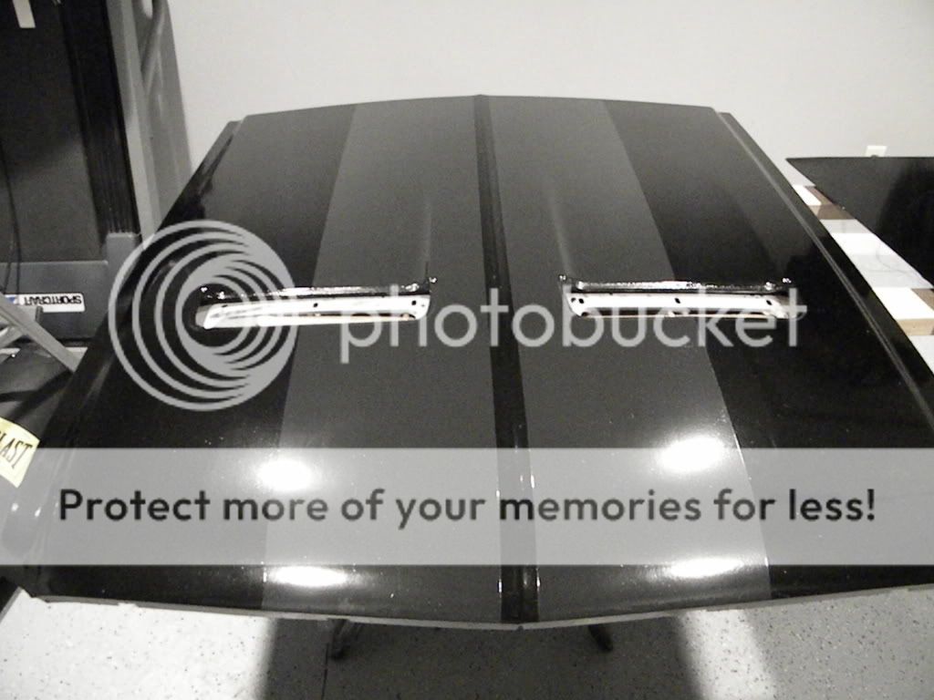

Post by marinecadence on February 15th 2012, 12:20 am

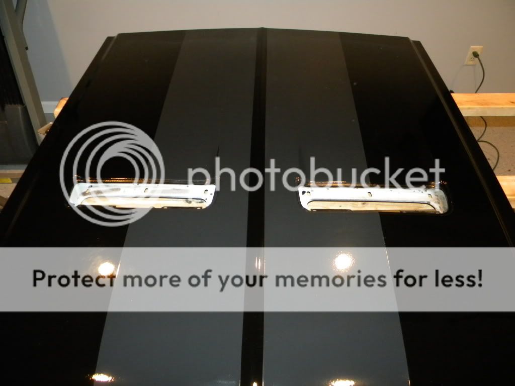

Got the hood and trunk lid done....ran into a snag, and wet sanded through one of the stripes on the hood....that sucks. Anyone know what I need to do to back out of the polishing/buffing to touch up the stripe? Its about a 2 inch long bare spot...Will I need to completely repaint the whole stripe???
Adding some pics of the trunk/hood

Very impressive! Nice gloss.

Post by cac1967 on February 15th 2012, 11:26 pm
Yes ,I would just retape the stripe and wetsand the stripe with 600 and repaint the stripe, the touch up would just show up in the final product.

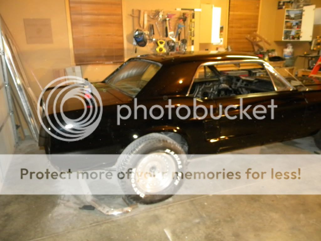

Post by marinecadence on March 7th 2012, 10:43 pm

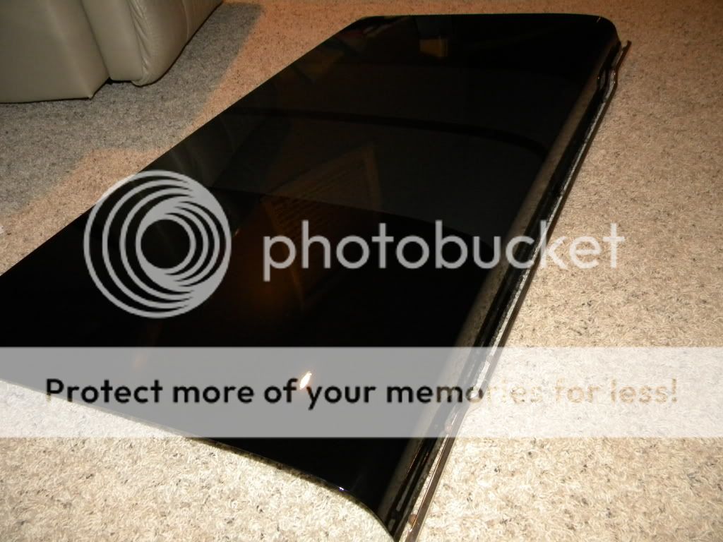

Few updated pics....started buffing and polishing. Looks pretty good. I burned two spots buffing...that sucked. Sanded it out and looks o.k....may touch it up. Let me know what you guys think....still trying to find the sweet spot in the buffing process. Not the best pics....sorry.

Post by Qwik96 on March 7th 2012, 10:53 pm
Looks great, but looks like a little more light buffing could be helpful with a good wax maybe... Looking great though bro!

Post by marinecadence on March 7th 2012, 10:55 pm
Yeah...I'm gonna keep going at the buffing...may take a while, trial and error. Wish I woulda went with white bounce

Maybe that's what I'm seeing... I'd give her a good bath & go from there! Looks light very light buffing should fix her right up! You did use the Meguire's Ultimate Compound right?
