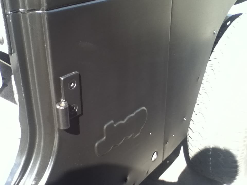

This is what mine looked like after rolling one coat over 600 grit sanded surface... it actually looks fine like that, but I kept going up in grit level because that was only coat number 6 for my paintjob. But you can see it turns out great with a roller, as long as you follow the method above.

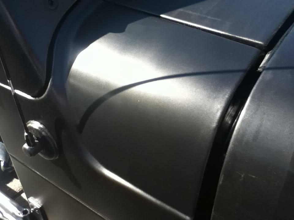

You WILL end up with a visually nice finish... you WILL ALSO end up with a very FRAGILE finish. The paint adheres very well and won't flake off, but if you run your fingernail over it, you will end up with permanent marks that won't come out. The only way to get them out is to polish them.. polishing them gives your paint a gloss level of about 80% of what you would get just applying gloss paint... except for the fact that ALL of your polishing / sanding marks are about 15 times more visible. Definitely not a good idea... I'm working on a solution by asking more experienced members... i'll post the results. Hopefully, together, with all the knowledge of our community we can come up with a way to roll on flat black with a DURABLE finish... even a finish half as durable as gloss would be fine with me... right now. Hopefully we can come up with something that works... but the above method definitely will get you a "nice LOOKING flat black."
